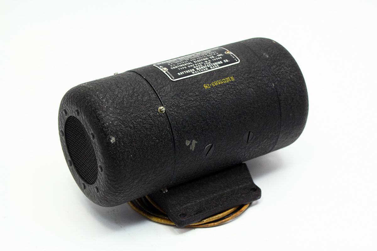

Well, this is a new ballgame. What is needed is a WWII Dynamotor for 600V.
It could provide sound effects at turn-on and pre-charge the capacitors up to 600V before the Mercury Vapor rectifiers come on line.
If it weren't for the constant whining noise, the dynamotor could power the whole thing. But it will provide a nice revving up effect during warm-up to keep everyone entertained until the main power and tubes come up.
Could copper plate the dynamotor for that retro look. Although the black krinkle paint looks "military".
It's even cheap:
Vintage Continental Electric Radio Dynamotor DMF519H US NAVY WW2 | eBay

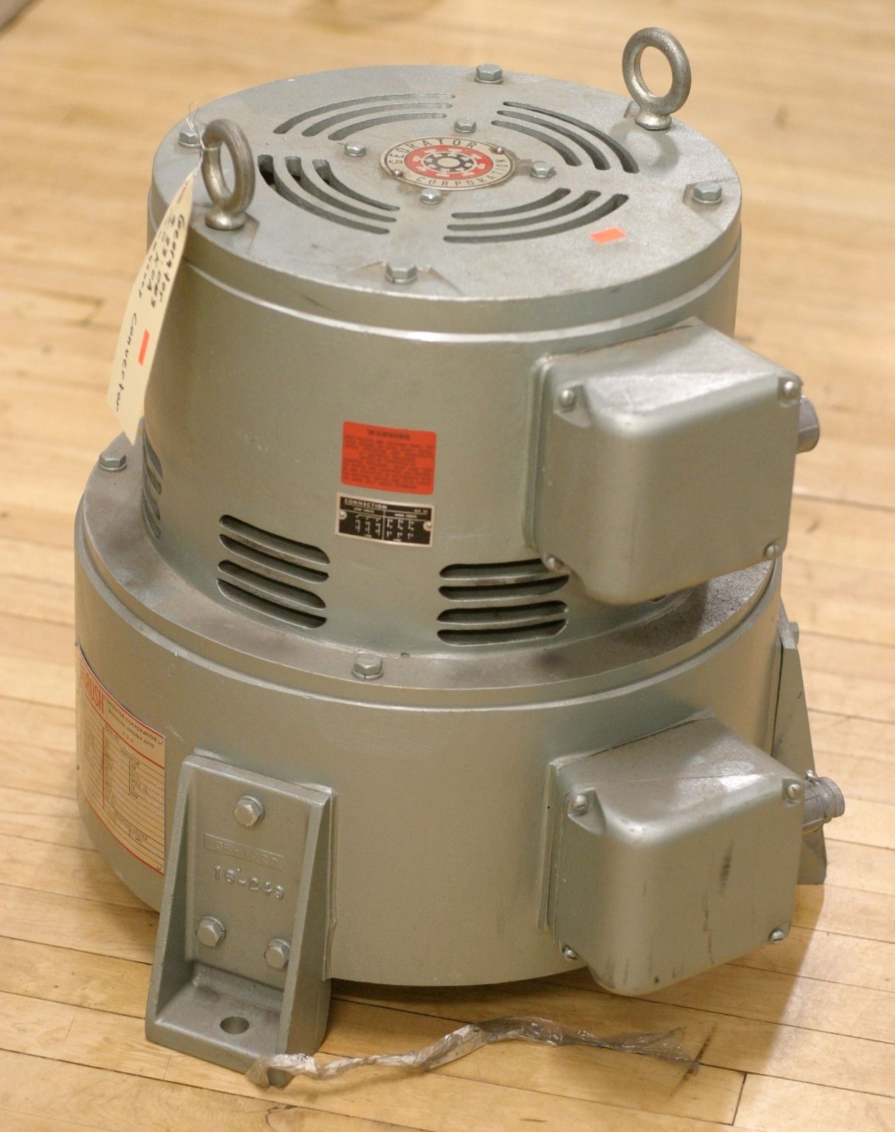

A better approach would be to use a 400 or 800 Hz 3 phase dynamotor in the basement. Then the 3 phase 400Hz power could be up V converted by some small 400 Hz xfmrs on the chassis. The 3 phase would eliminate most of the ripple after rectification, so filtering would be easy. There are some 60 Hz to 400 Hz (or 800) brushless single shaft motor generators made by Georator.
Unfortunately, these are too noisy to have near the amplifier too. Basement.

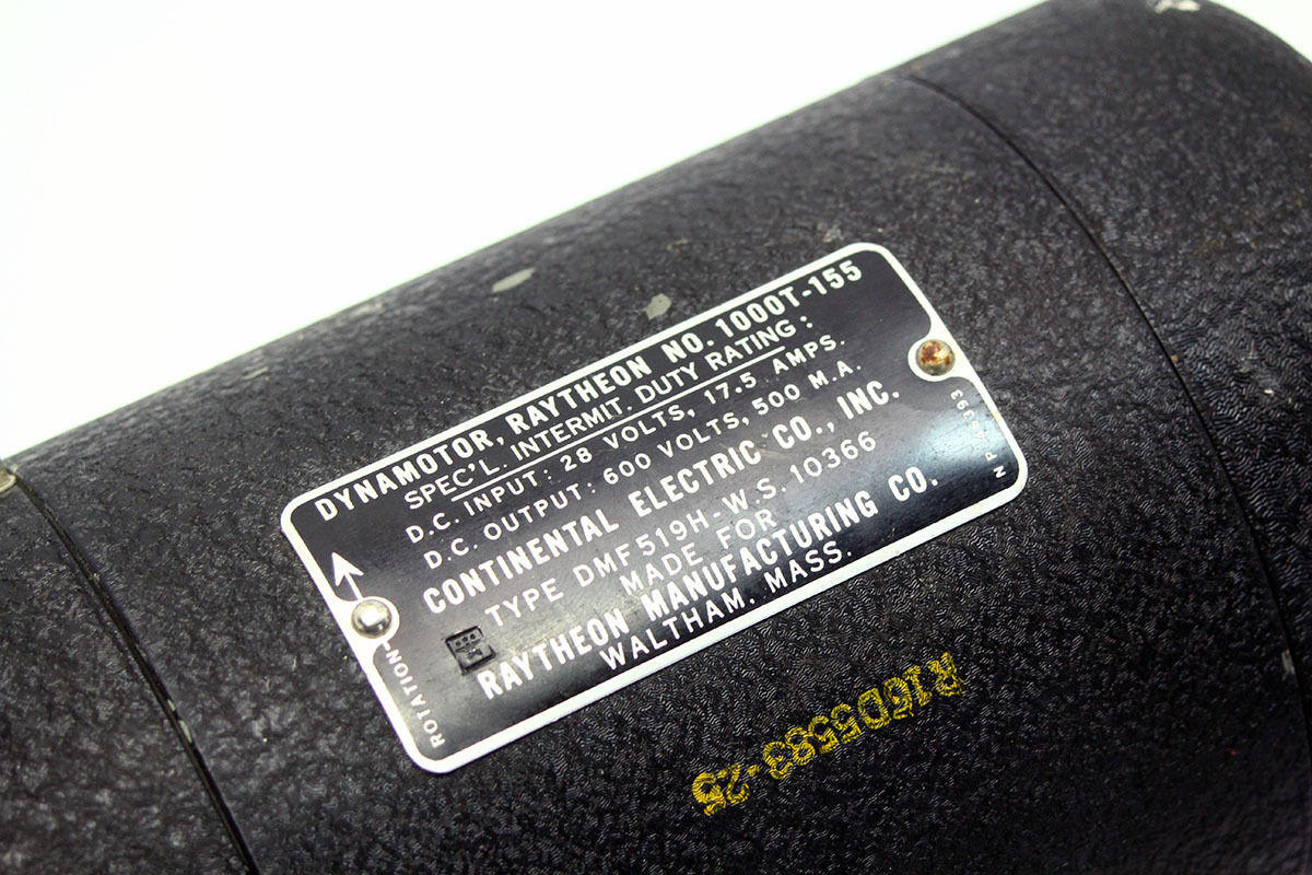

I found some Carter 600 Volt dynamotors and some TV sweep tubes under a bench in the Pearce Simpson CB radio warehouse in Miami when it shut down around 1980. I wonder what they were doing with those.......my good ol boy friends found two useful applications for them, electric fishing, and getting nightcrawlers out of wet ground rather quickly.

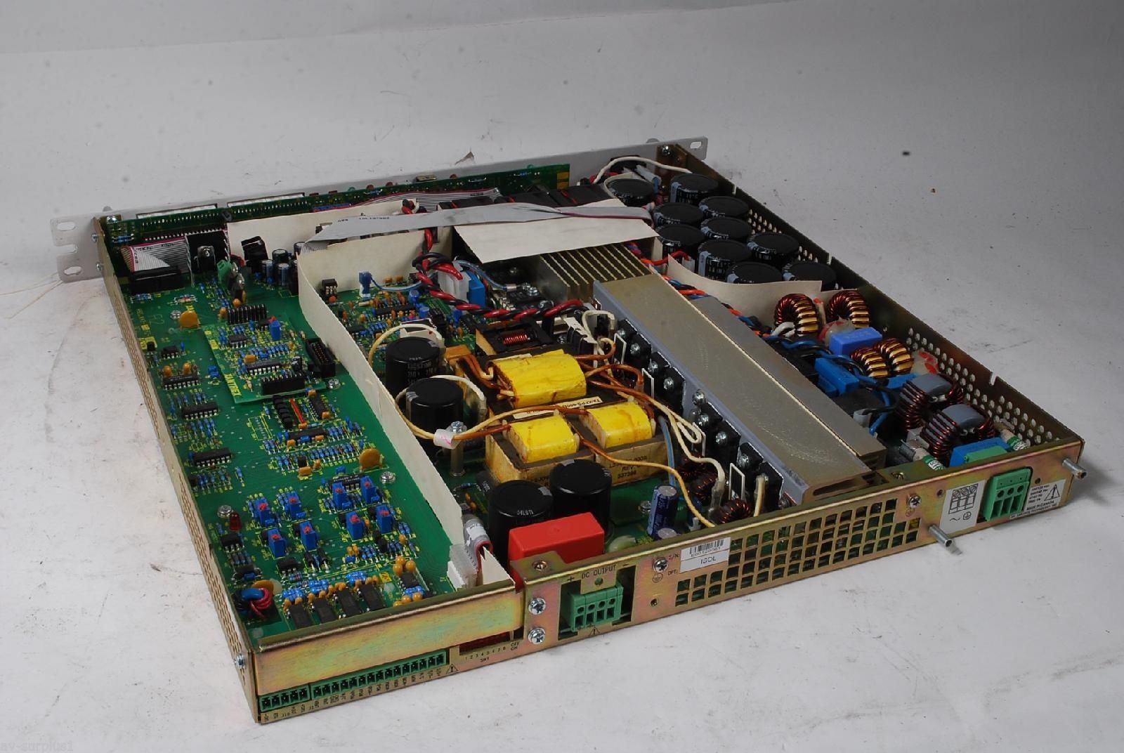

Here is the inside of a 1200 Watt XFR 600 supply.
Should be similar. Just some size scaling needed for 10 KW.
