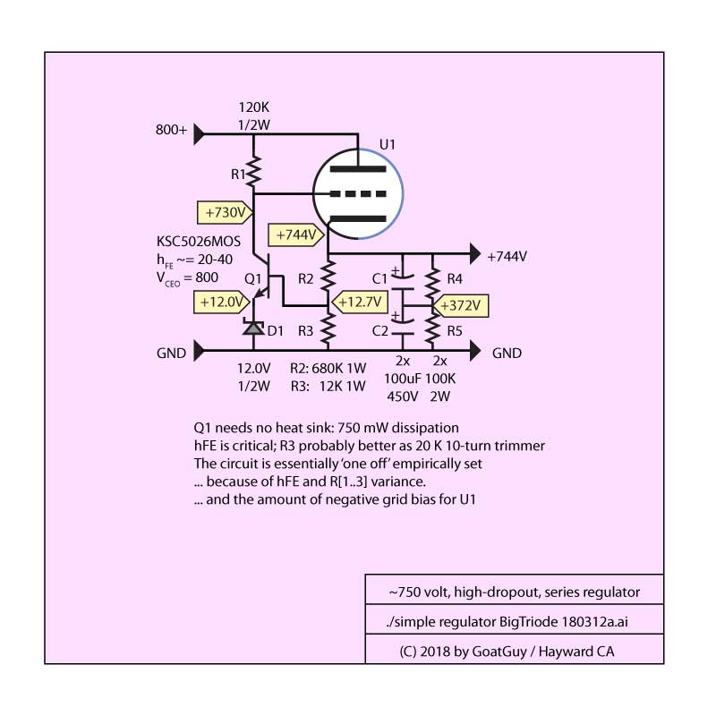

Actually, the concept of a small hi-volt capable shunt comparator controlling the grid of the series-regulating (not “regulation”) pass valve is an elegant, simple idea. Here's the diagram and the relevant math to support it should be fairly obvious.
GoatGuy

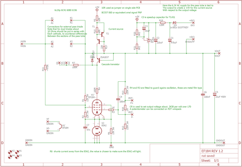

Attached you will find a schematic of what i built some time ago.
Well passing some current through resistors has one major advantage : cost. you need less pass tubes and less current to heat them. Whilst sacrificing little in the way of performance
Multiple grids and stray inductance need to be driven, an 6AU6 with a high plate load is a wimpy driver.
The steve bench supply is really good, however i think that you can manage with two Four 6080(inexpensive) the extra expense for a floating screen supply is not needed at all if you have enough loop gain. CCS loading the driver tube can have merit because it allows the driver tube to operate at high current over its entire range, which increases the loop gain of a single pentode by nearly an order of magnitude
Edit try to find (tektronix circuit concepts -power supply) its a great piece about vacuum tube regulated power supplies.

Interestingly, one can ALSO do it with a plate-series resistor, too; Instead of dropping (say) 100 V thru the tube, drop only 50 V. In theory you've now got 2× the amperage handling THRU the tube. And if it supports such a high current, then none of the over-voltage drawbacks.
Instead, you get an undervoltage condition when current exceeds 2× the nominal setpoint. Semi-active methods come with their drawbacks.
You could (obvious perhaps) even double this up… in the same way, with something MORE regulating. A plate-series MOSFET regulator to pre-filter the raw B+. It too has merit. You can at least be sure that you'll not have a resistor-effected undervoltage drop out condition.
GoatGuy
Lastly, as a (PS🙂), note that the ripple reduction of the reg tube diminishes by the fraction of current it is handling. So, if the valve carries only 20% of the current, then it can only regulate at 20% of its 100% nominal efficiency. Which then begs the question, “what's the point?”
When the output current exceeds the current flowing through the resistor, the regulator is going to compensate for any ripple caused by the resistor, the amount of attenuation depends on the frequency dependant internal resistance of the supply and the value of the resistor used to bypass. Any ripple on the output will be amplified many times by the error amplifier, and fed 180 degrees out of phase into the grid of the cathode follower tubes. Which theoretically should cancel out the majority of the ripple. Think of it this way: only a portion of the current going through the resistor to the output is AC, if the tube can vary the current by the same amount it will be able to compensate.
The tube regulation is most limited by its current handling ability here.
Instead of using the resistor bypass, use a Mosfet current source bypass, for something below minimum current. Then no ripple current is passed around the V regulator tube at all. The V regulator tube still controls the output voltage 100%.
One could go even further and make the CCS bypass into a tracking one that supplies a fixed fraction of the load current, even for a varying load. This will require some careful Fdbk design, with two interacting Fdbk loops.
OK, now that we've veered all the way to Bangalore in order to get from Paris to Nice, one could observe that following this line of thinking, and very soon the regulating tube is chucked out in favor of MOSFET to begin with.
But that isn't the OP's design criteria. He's going for Overkill Steampunk, and needs the Big Bottle as part of his props. The resistor-in-parallel idea is pretty nice, in that it'll easily handle losing one insufficient-handling tube. And there really isn't too much in downside. Especially if the pass-resistor is fine tuned to be about 50% of the nominal load.
