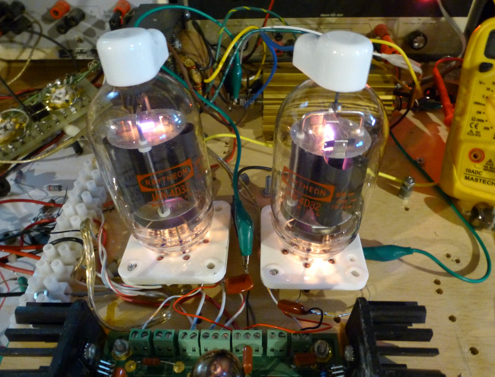

Ebay: 4D32 $25 50 Watt 300 mA DC, weird socket & plate cap

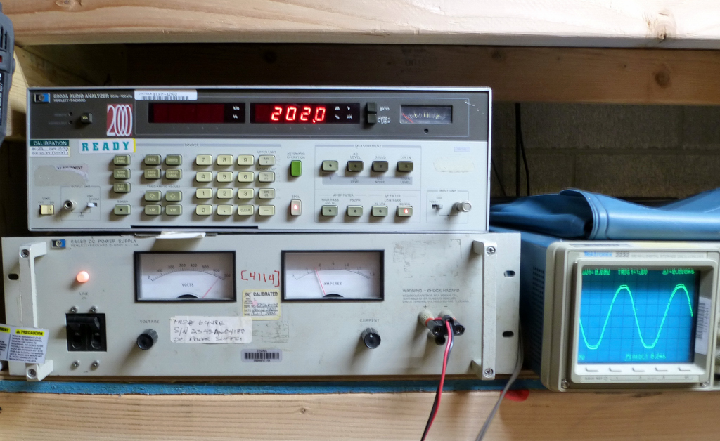

The sockets and plate caps are standard items. I got mine from ESRC. You can see me squeezing 202 watts from a pair here.
The power supply shows 650 volts at half an amp for a 200 watt sine wave output. Unless you like to listen to continuous sine waves for long periods of time, the power supply can be a bit smaller with a decent cap to handle transients.

I suppose"squeezing" 200w out of them regularly isn't a good idea... I wonder how they would perform in place of KT150s?
The efficiency peaked at 200 watts out, then dropped as I went to 250 watts. Even at 250 W the tubes showed no signs of duress, but the recommended operating conditions show 125 watts of audio output.
