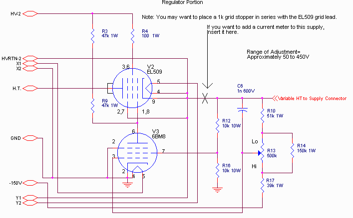

The circuit requires about 150v more input than output to deliver full current.
This fully depends on the characteristics of the pass tube(s).
6S33S requires 120 V over the tube when anode current is 500 mA.
I think the minimum is 3 pcs. of 6S33S as pass tubes to meet your requirements

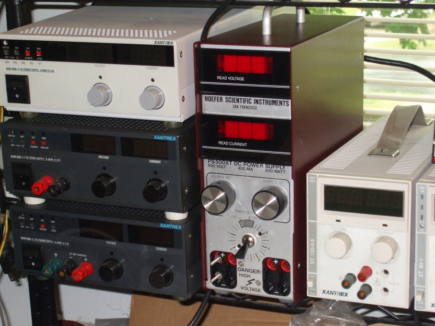

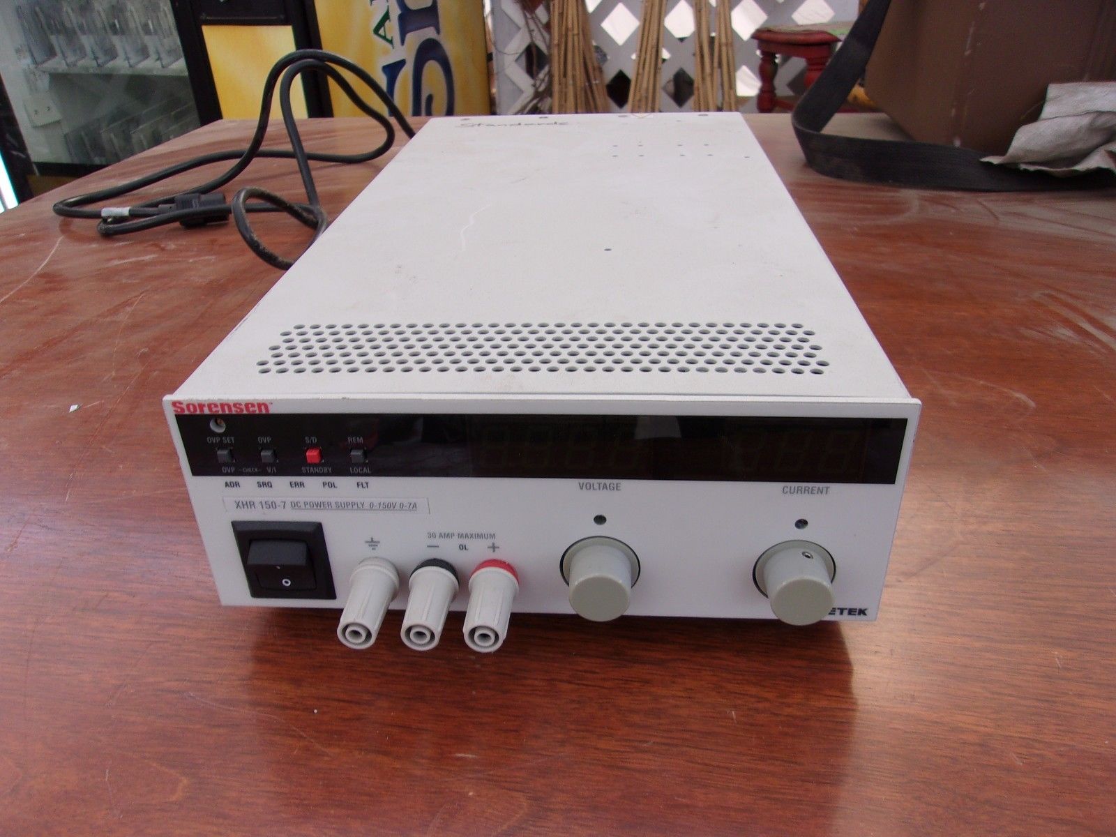

Xantrex/Sorensen/Ametek XHR 600 -used- to be cheap on Ebay 15 years ago (14 lbs).
Maybe a DCS 600 or EMI 600, DCS 600, XFR 600, XG 600 can be found reasonably ($) now.
TCR 600 or DCR 600 should be cheap, but -OLD- and heavy and noisy.
or HP6448 expensive, -OLD- and heavy and noisy.

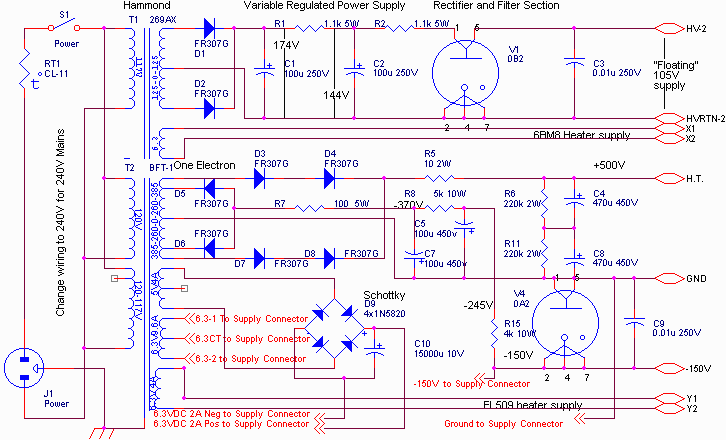

I'll just parallel some EL509s, and put a 10 Ohm resistor on each plate to share current . My only concern is whether a single 6bm8 can drive all 4 pass tubes. In theory the grid shouldn't pull any current, but being at a positive voltage it may. That 6bm8 plate/ EL509 grid is only at 100v max or so, and that's through 94k of resistance. If they are pulling a bit of current on the grids, would reducing the resistance from the 105v rail to the 6bm8 plate/ EL509 grid help give the error amplifier more drive ability?
Yeah, I don't understand what has happened on Ebay lately.
Used to get an XHR for $50 "for repair" or $300 "working". Now they want as much for a used one as a new one!
Ebay's fees must to be reaching the "shake down, assault" level.

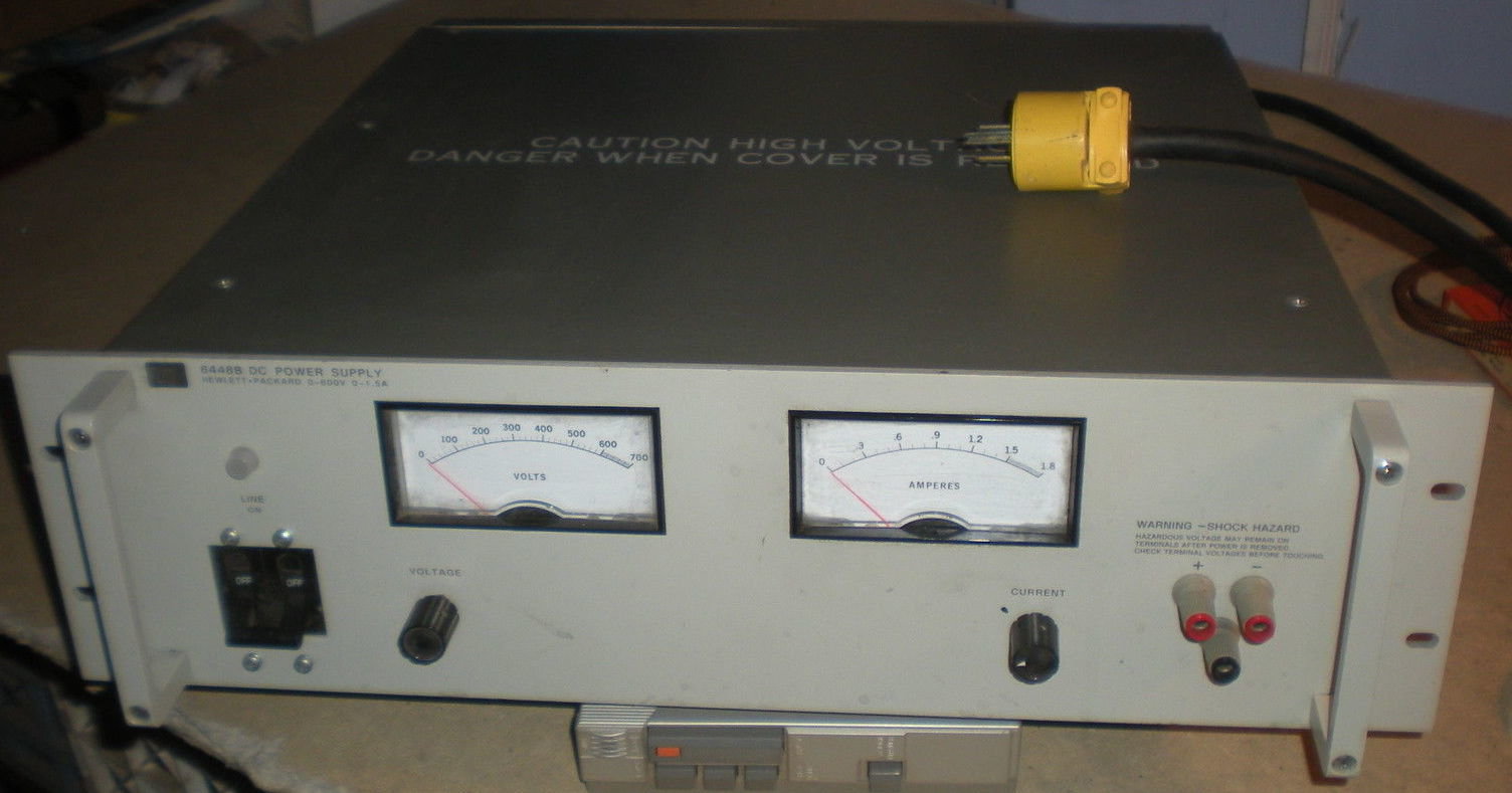

$1000 for an HP 6448 dumpster rescue. I paid $50 for two of them 12 years ago, then gave them away when I got some XHRs.
I sell on eBay, it's not the fees. People with more money than brains pay ridiculous amounts for things, and so that becomes the price point. The seller gets most of that money. They're not complaining.
If this will be built with EL509s, some 6 pcs. is the minimum. Max. plate dissipation of EL509 is 35 W. The total dissipated power is 200 W. Even 6 pcs. of EL509 is marginal and these should be well matched.
Put 10 ohms resistors at the cathode, not at the plate. The current equalizing effect of these resistors is greater at the cathode.
Any pentode can "drive" these pass tubes, since there will not (and can not) be any grid current. A triode connected EL509 draw 500 mA current at 160 V plate voltage while Ug1 = -17 V.
In any case, when pass tube(s) go to grid current (Ug1 = 0 V) the operation of the regulator collapses.
I'll either nudge down the voltage drop, or use 6 tubes.
Regulators tend to shoot for the lowest possible output impedance, so wouldn't putting resistors on the cathode hurt that? In this circuit with a single EL509, the output impedance is about .7ohm.
The grid of the EL509 is connected in series with 94kohm to a 105v supply, the return of that supply is connected to the cathode (output). Wouldn't ug1 be up to +105v?
If the cathode was grounded, any pass tube would explode or melt, because it is biased to near infinite conduction, no? Instead the load is in series with it to limit the current to whatever the load asks for.
So being that the grid is in fact positive, could it not draw a small amount from the cathode to it?
I got mine for free...OK the cost of gas for a 200 mile drive. It's ultra slow response time coupled with it's 1000uF of output cap guarantees destruction of parts when things go wrong. The recent fireball that burned a hole through a PC board and turned an OPT into a magnet was due to a dumb blonde stuffing over 1KV (plate voltage on a 160 watt amp) into a resistor rated for 300 volts.
Other than that, it's a good power supply for the price I paid for it.
No, the output impedance of the regulator is determined by the loop gain and NFB used.
The effect of cathode resistors is just to equalize the tube differences and do not effect to output impedance.
If you already have an idea about the circuit/schematic, please show it.
It's from the link posted earlier in the thread, note: not my schematic.

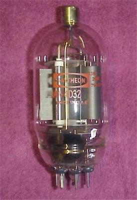

Some bigger (but inexpensive) tubes listed at ESRC and at Vacuumtubes.net:
Will need around 8 or 9 or 10 tubes for 200 Watt
All have plate caps.
6EX6 $5 22 Watt 220 mA DC Octal
21EX6 $3
6DQ5 $10 24 Watt 315 mA DC Octal
26DQ5 $3/$5 (may be supply limited at $3)
6CB5A $5 26 Watt 240 mA DC Octal
21LG6A $4 28 Watt 315 mA DC 12 pin Compactron
Ebay: 4D32 $25 50 Watt 300 mA DC, weird socket & plate cap

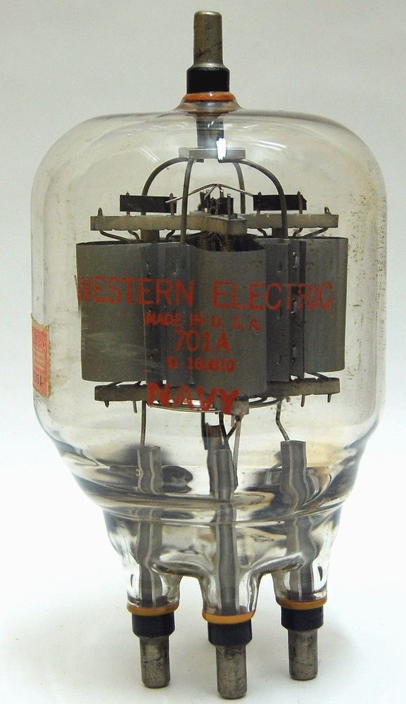

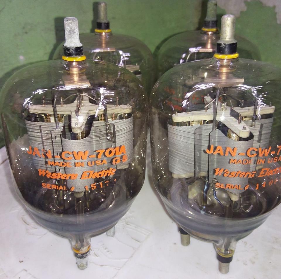

701A 100 Watt, high current, DIY socket, $75 (Vacuumtubes.net) (one tube at Fair Radio Sales for $35)
701A 100 Watt, high current, DIY base, $75 (Vacuumtubes.net)
Now THAT looks cool enough to spend $150 on. Though at this point I may stick with the EL509s, since they're $9 a piece. It'd be cheaper, it's what that circuit is set up for, has a normal filament voltage, and is indirectly heated.
I'd imagine those big ones are directly heated, so wouldn't I have to run dc on the filament to avoid hum on the output?
