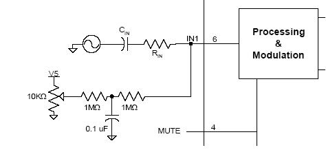

I looked at the data sheet and also noticed that DC offset is dealt with on the inputs as well. What will be the result of not using this and does the amp actually require this and/or already have it?

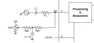

amt, the DC offset adjustment circuit is there on the board. It's not really "in" the signal path, it's in parallel with the input pins, but I'm sure it has the possibility of adding noise. The DC offset without the circuit might be a lot more than we are used to with the small "T-amps" though.
Also, there is no resistor after the cap like in the diagram. I believe the NE5532 is setup for gain, but I haven't checked the resistor values yet to see how much.
The circuit certainly isn't necessary, but it is nice to be able to null the DC output offsets. This circuit is used on the Ref-T and the Trends amps too.
Good answers! The only way to find out what kind of DC offset you'd get would be to remove the 1Mohm resistors. I wouldn't expect it to be much different from what we see with the smaller Tripath chips. The main source of noise when using this circuit is the 5V supply that the adjustment pot is connected to. This is most likely the internal 5V regulator. I don't know much about the noise of the regulators internal to the Tripath chips but I bet they could be better. The Ref-T uses this circuit for DC output offset adjustment but uses an external, low noise 5V regulator with filtering. Panomaniac made some noise measurements of the Ref-T and compared them to a stock SI and a Fenice 2020. The Ref-T's output noise was 10dB lower than a stock SI and the Fenice was 10dB lower than the Ref-T if I remember correctly. Clearly there was room for improvement because the Fenice was 10dB lower, but it was 10dB below a stock SI with any added noise from the DC offset adjust and an external 5V regulator (which drew power from the same supply used to power the 14V regulator). Make of that what you will.
