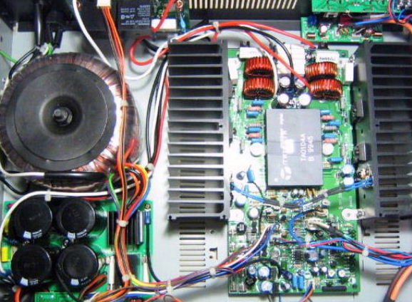

Can you take more photos of the inside? I'm quite interested

Maniac, that is the entire inside. If you want a higher resolution picture, I can email you one.

I'd love that, please do send me the higher res photo.

I almost feel like it's "too nice" for a sub amp, although that's probably what it'll end up doing. Going to make some minor parts upgrades to see what she can do first -- the output filter seems like a good place to start. Interior is way better than I expected.
