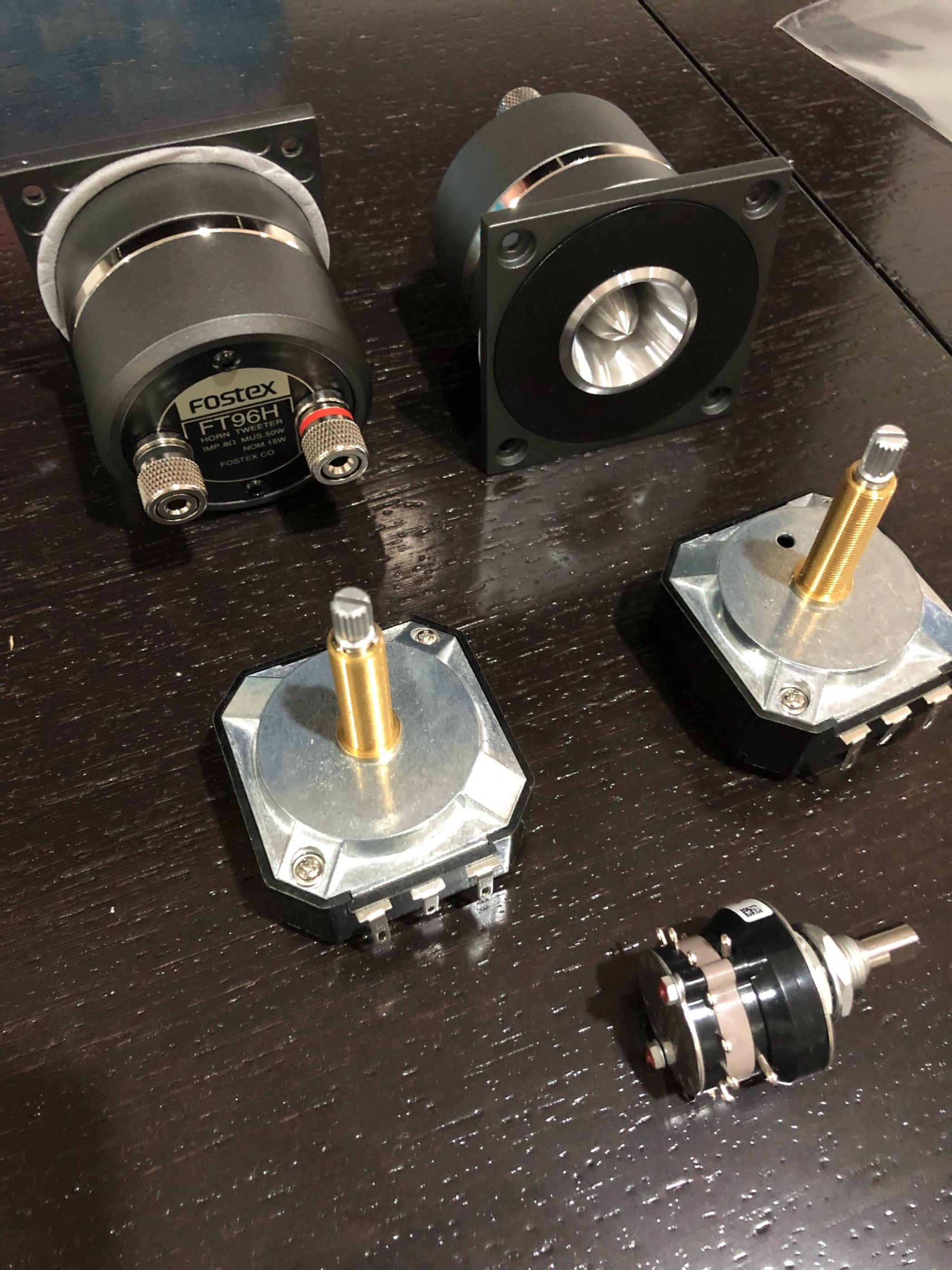

Tweeters and attenuators arrived today,
My friend started on the input for the CNC to cut the front baffles today. Maybe a test panel first of the week.
The switch in the pic is a 4 pole, 3 position switch to select between passive, semi active, and active. Not a cheap switch, price wise, rated for 1 amp and has silver contacts. Is this a suitable switch?

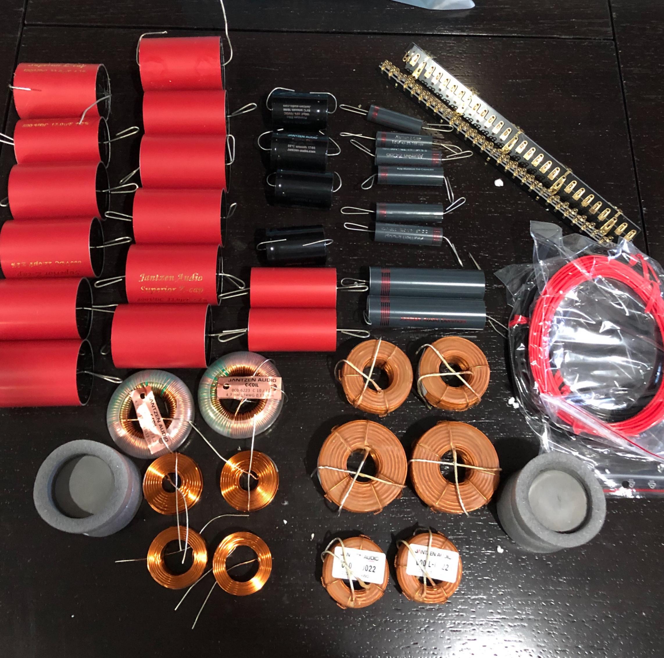

When I got home I spread out all the components to get a perspective of the pockets the cabinets will need.

I went ahead and ordered Path Audio resistors for everything but the 18”. Although the correct values, the resistors in the pic are just placeholders.

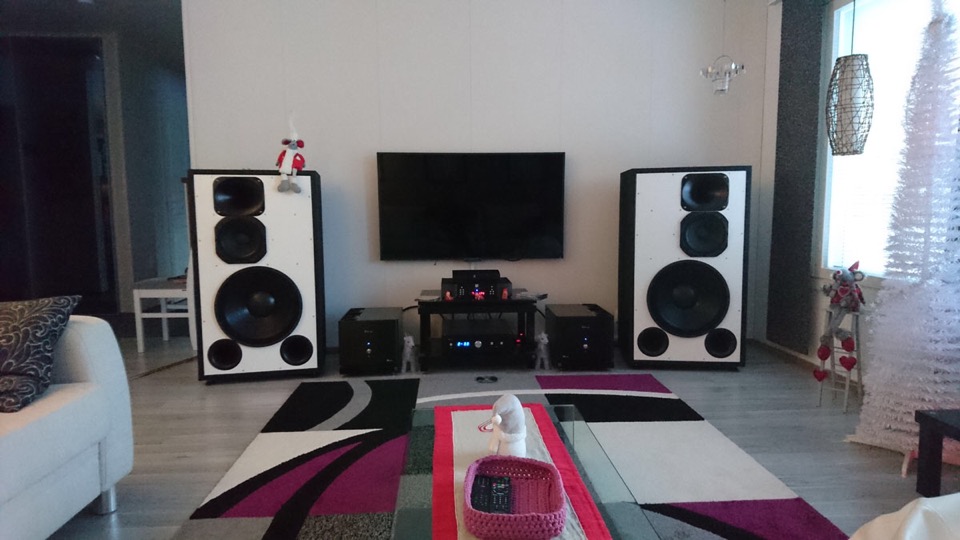

i really like the way the 18" is playing,,,it plays so easy ,,and deep ,never sound muddy
for me it is ,on many way, the best speaker i have build,,,my last speaker was

I use a Gryphon Encore amp 500watt
i think the Loudspeaker plays alright with low volume,,better than my old speaker
easy to hear what going on ,on the record,,,but i normally listen a good deal higher on volume.. concert dvd with good volume is just me

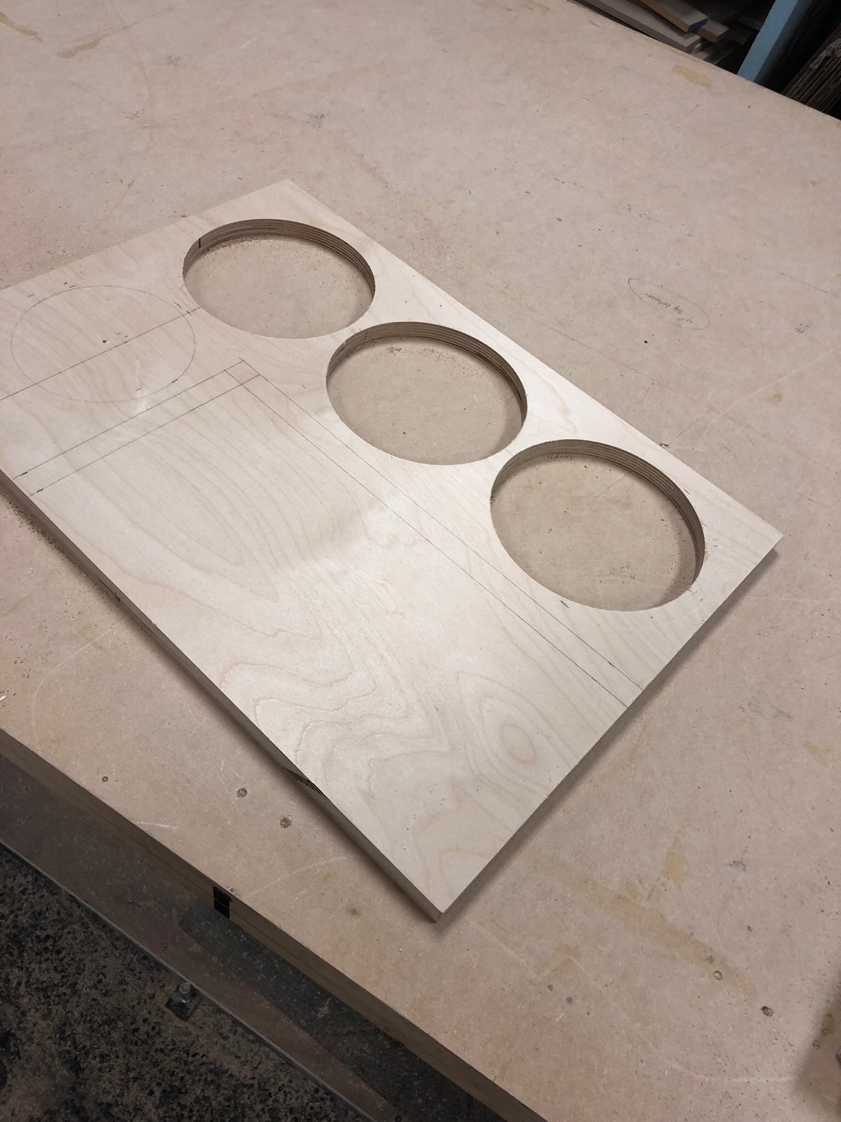

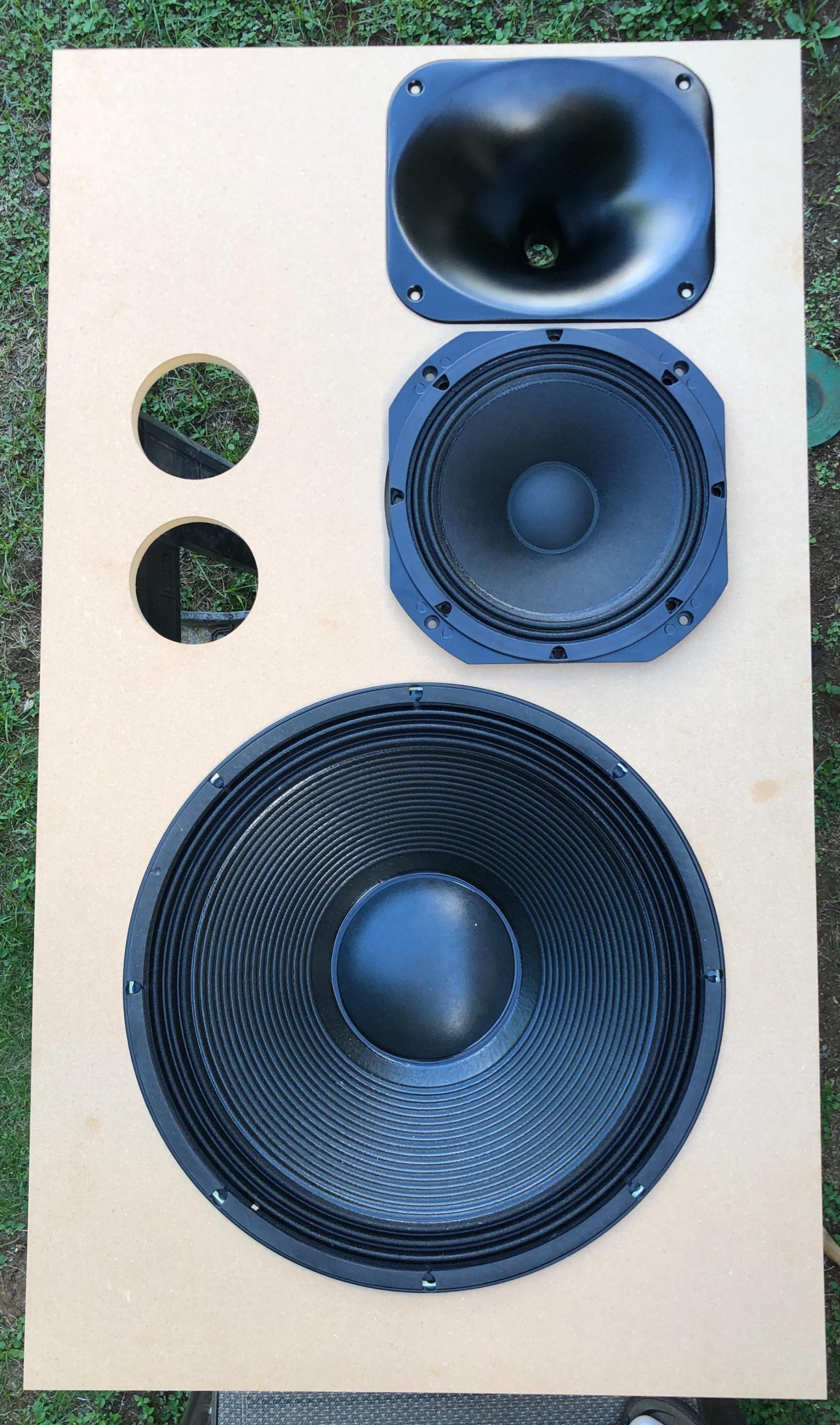

Here is a first draft cutout from the CNC. Some tweaking to do, so will have at least one more mock-up.
This is going to be a BIG speaker. I will have a 2 1/2” skirt around the bottom to cover wheels/feet. Still sketching and calculating for final cabinet dimensions.

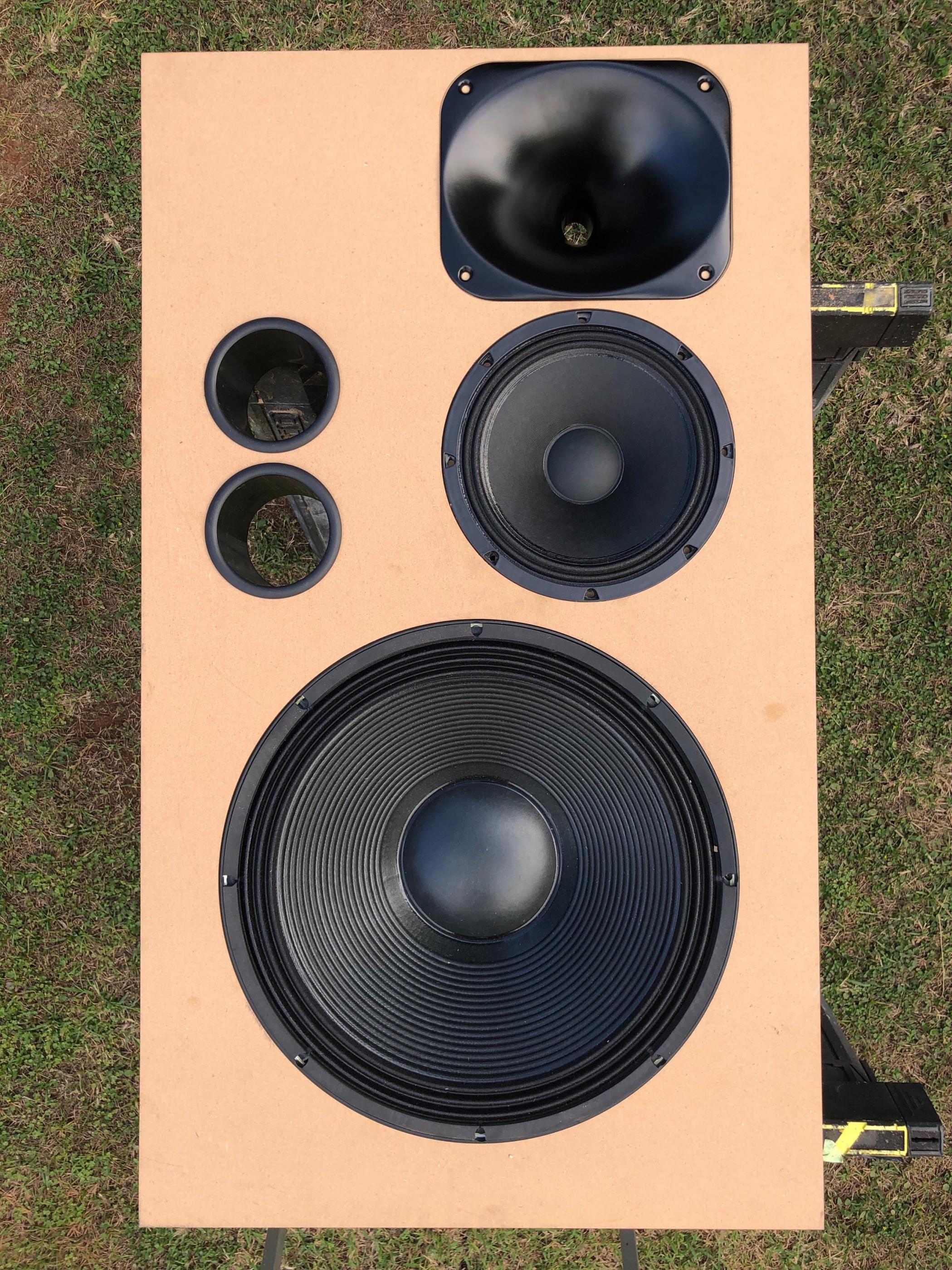

A test fit for the drivers. I’m going to modify the midrange driver flange to be a circle.

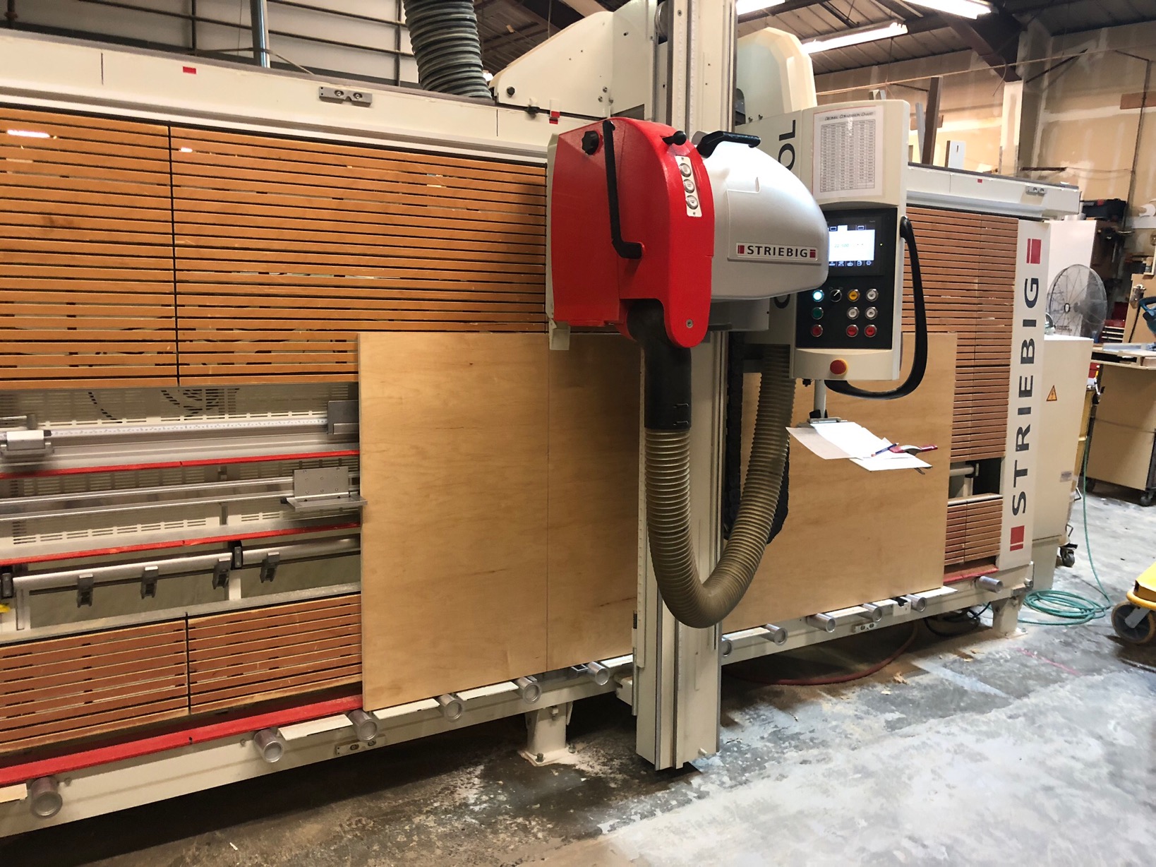

Today I had the cabinet shop almost all to myself. So much quicker jumping from machine to machine without me getting in the way of the “real” cabinet makers.
The cabinet will finish out to 43.5” tall x 25.5” wide x 19” deep. Will sit on a set of 2.75” tall casters behind a “skirt” that can be changed out for feet. Walls are 3/4” Medex outside, 3/4” Maple plywood inside. Holding all the Medex corners together will be a 7/8” x 7/8” solid Maple frame.

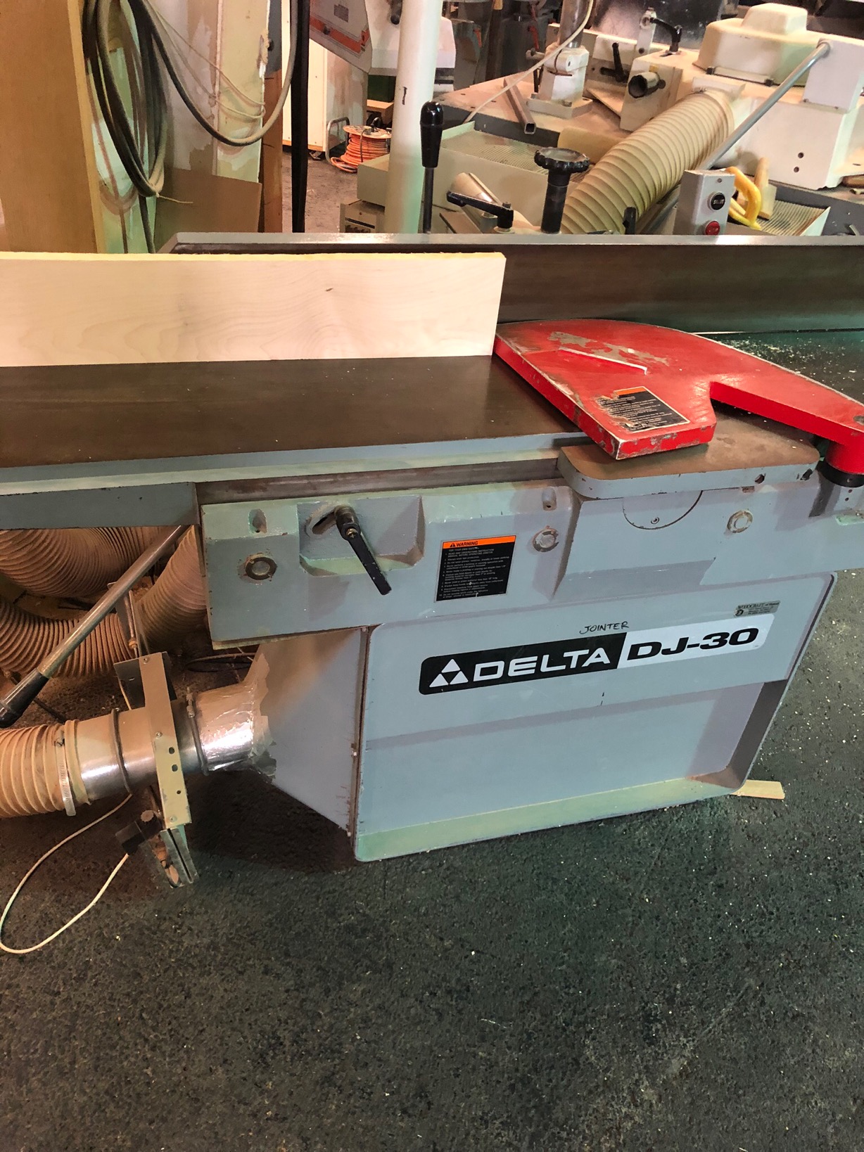

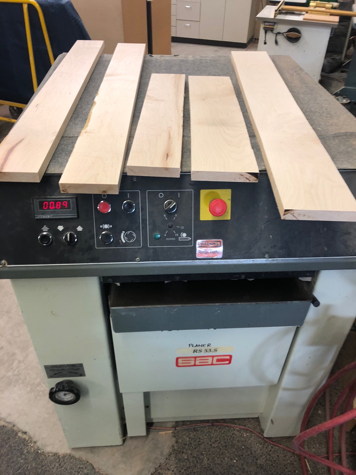

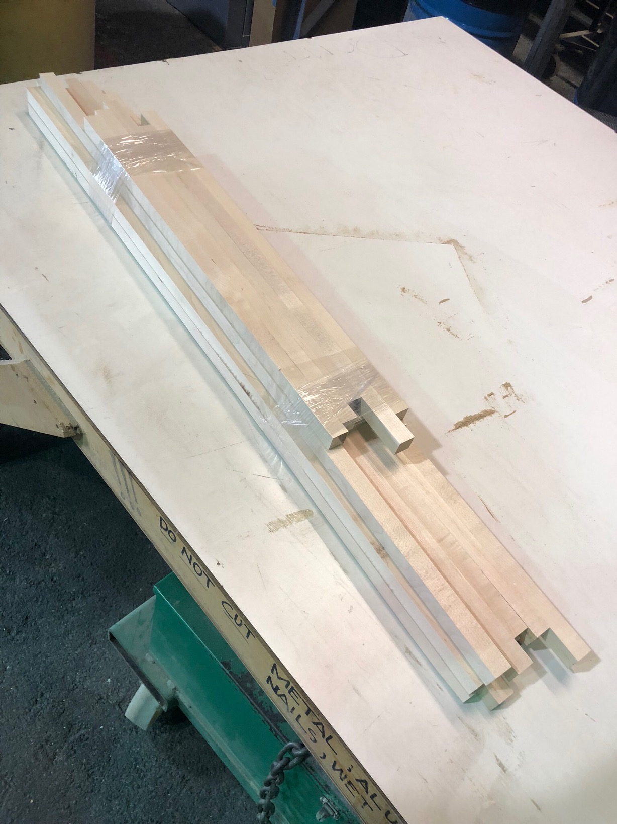

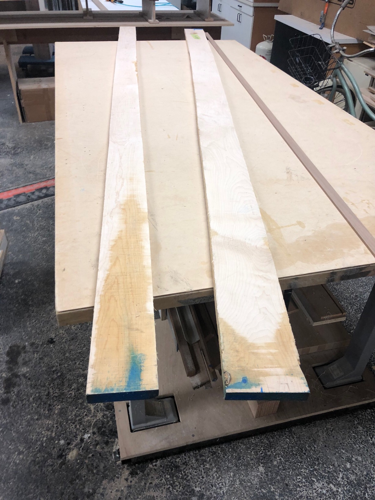

Started off with rough Maple planks;
Cut them up into rough lengths and ran them through the planer;
Then the joiner;
Then ripped them into strips;
Then sawcut edges, both sides, through the planer, wrapped up and ready to go.

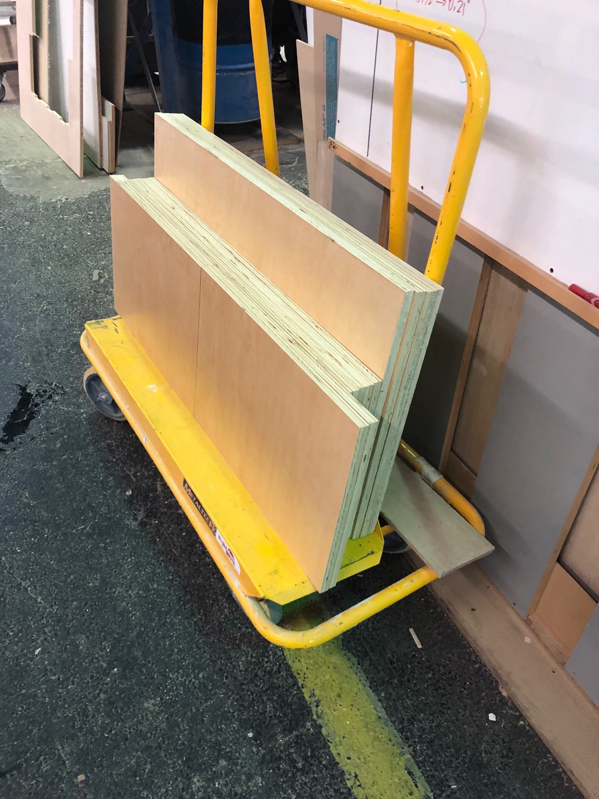

Started on the Maple ply next. The Maple ply will be bonded to the Medex, in between the Maple framing members, with a Polyurethane based adhesive. This will be similar to what I tried in my last speaker project and I believe this “Constrained Layer Dampening” concept provided a benefit. So sheets into the panel saw.

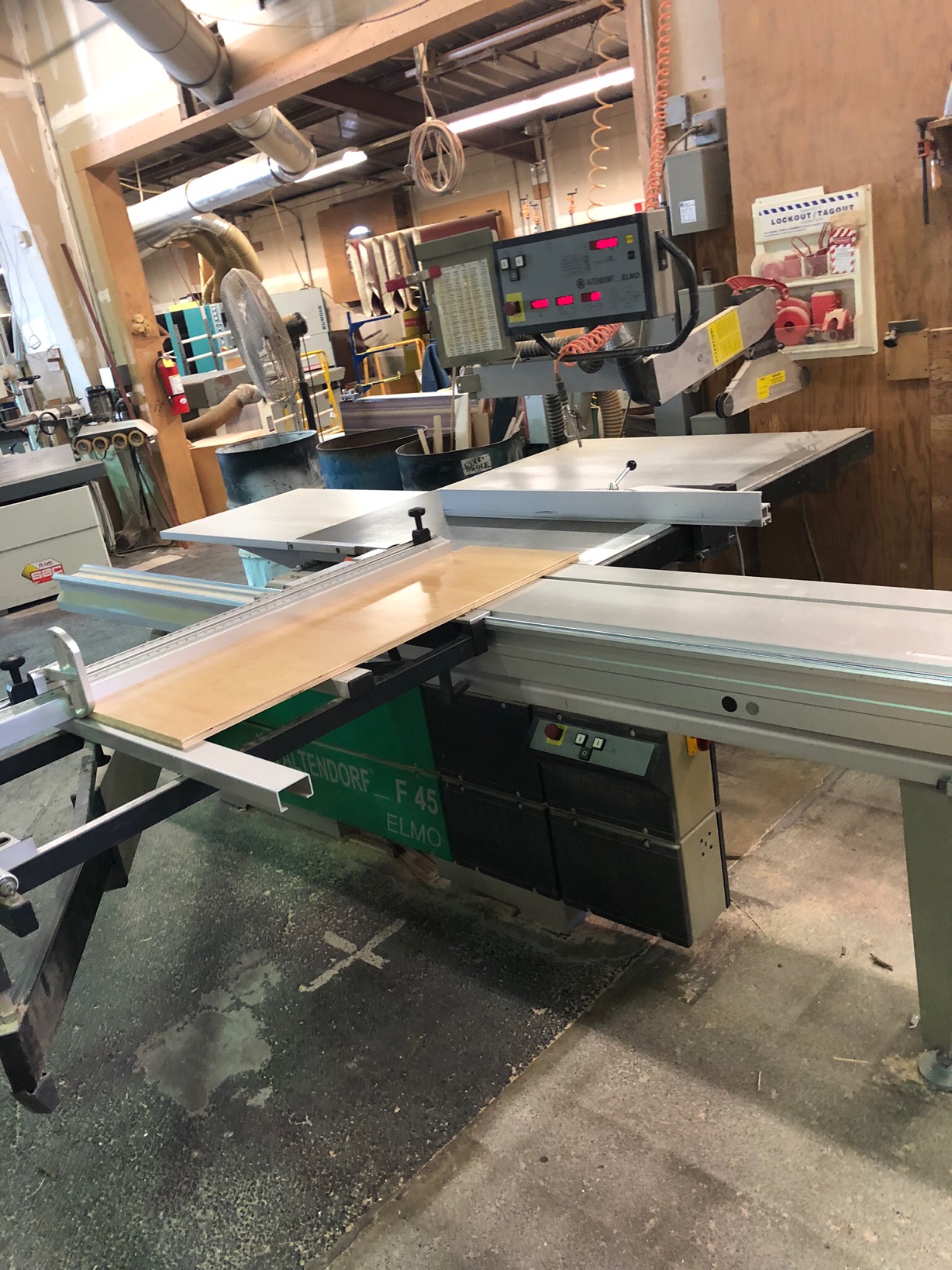

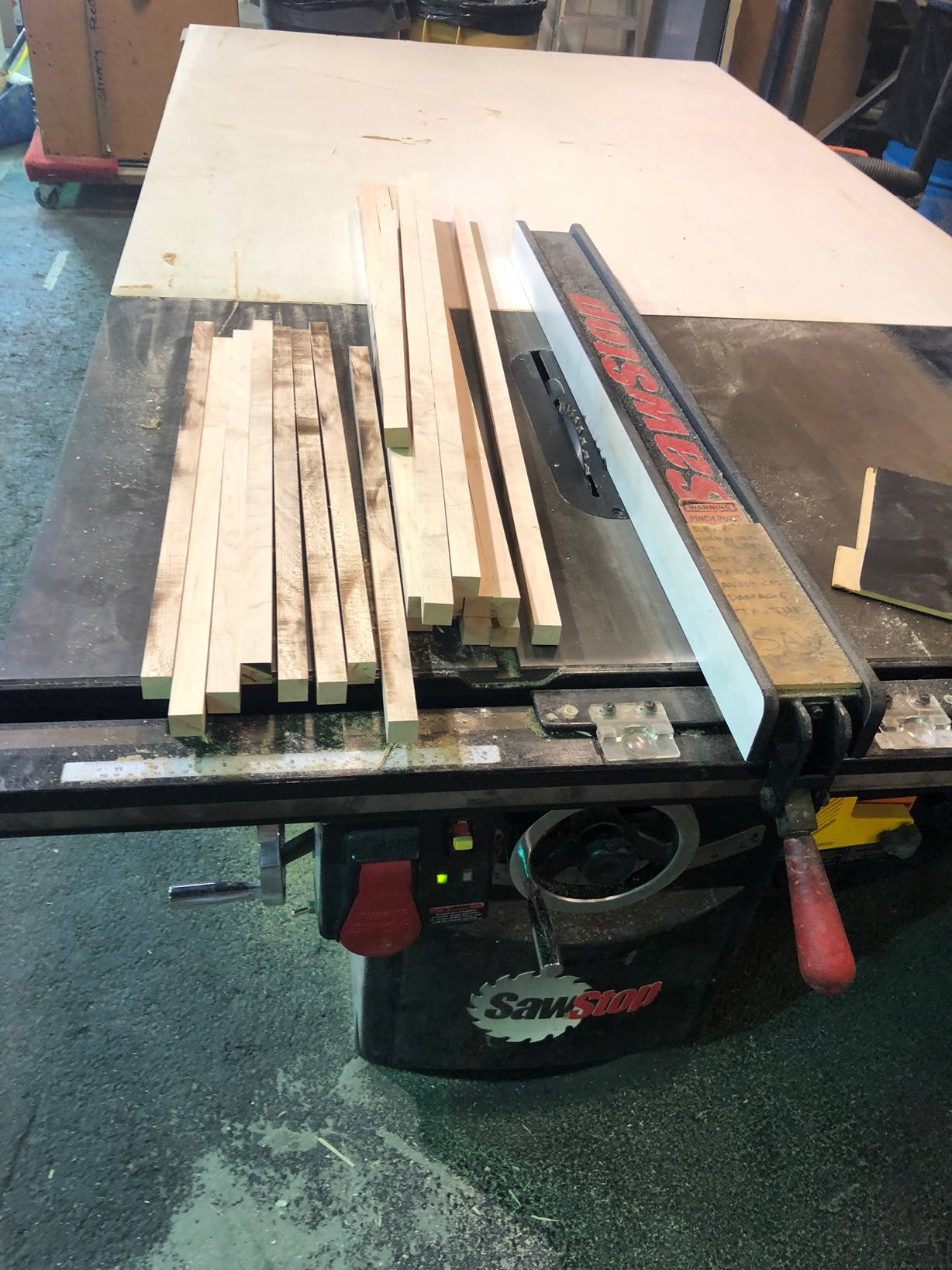

Then into a more accurate table saw than the SawStop;
So everything cut up and ready to start going together after the Medex comes out of the CNC. Planning on starting assembly next Saturday.

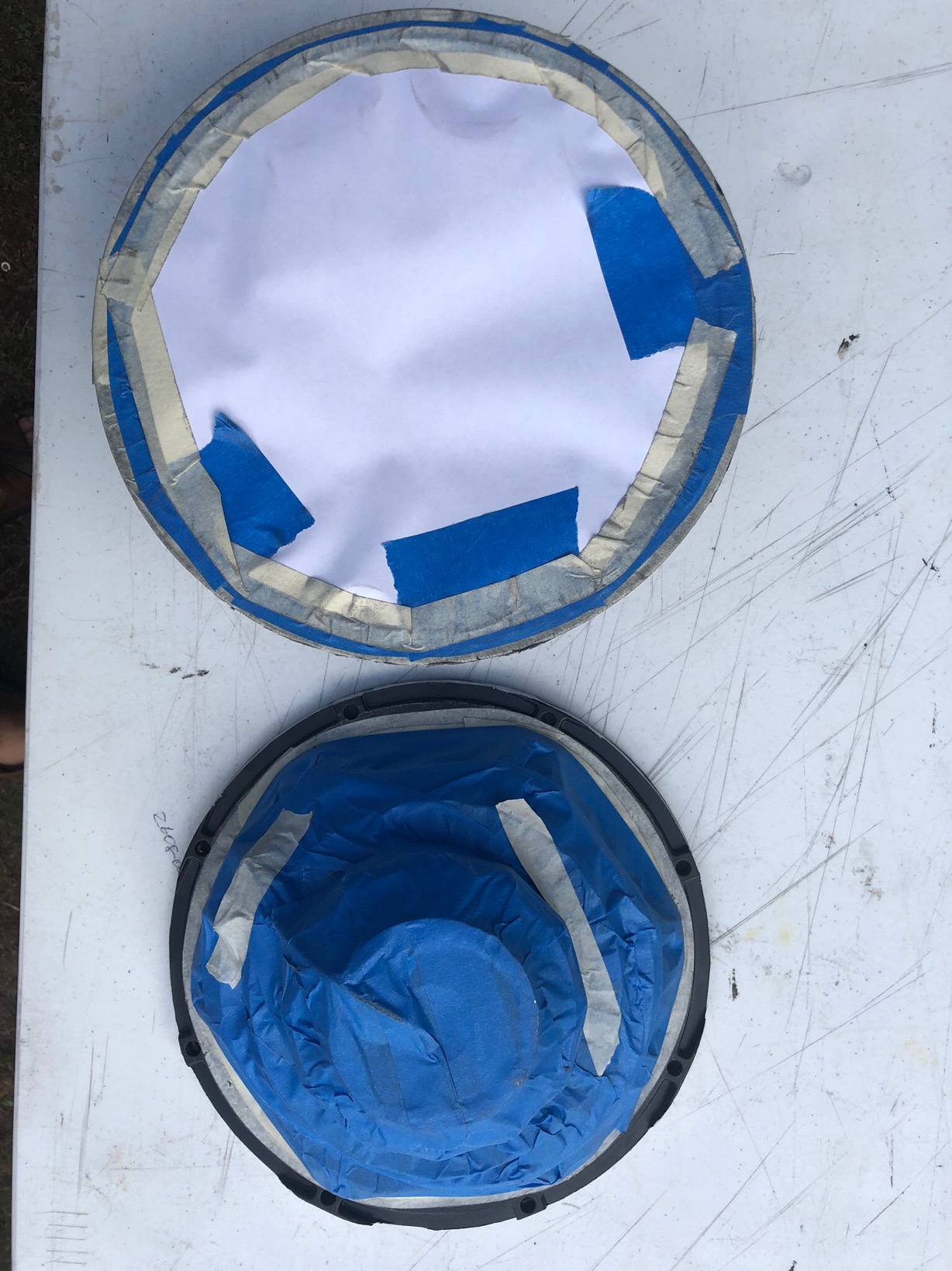

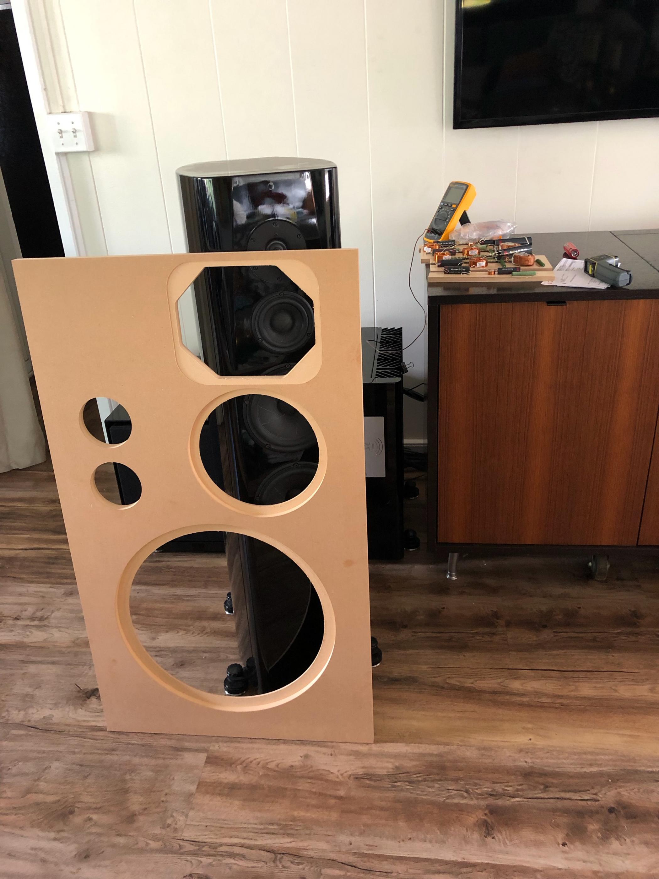

So I’ll probably take some backlash from what I did today.

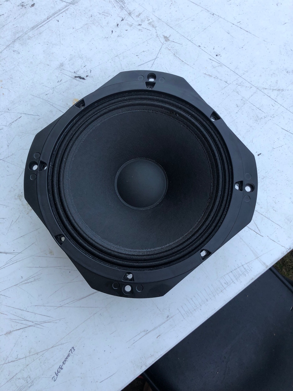

I really don’t like the extra 4 corners/attachment points on the 18 Sound midrange driver. So they disappeared today.
After sealing up the driver, all the way around 100%, a few passes with a cut-off blade on the angle grinder and they are gone. Aluminum heats up pretty fast when cutting like this, so it took 5 passes cutting, cooling, to keep the heat from building up.
Didn’t get a pic, but after a little smoothing gave the cut area a couple coats of black paint. Looks like it was made that way.

So another trial fit today, final version should get cut up this week.

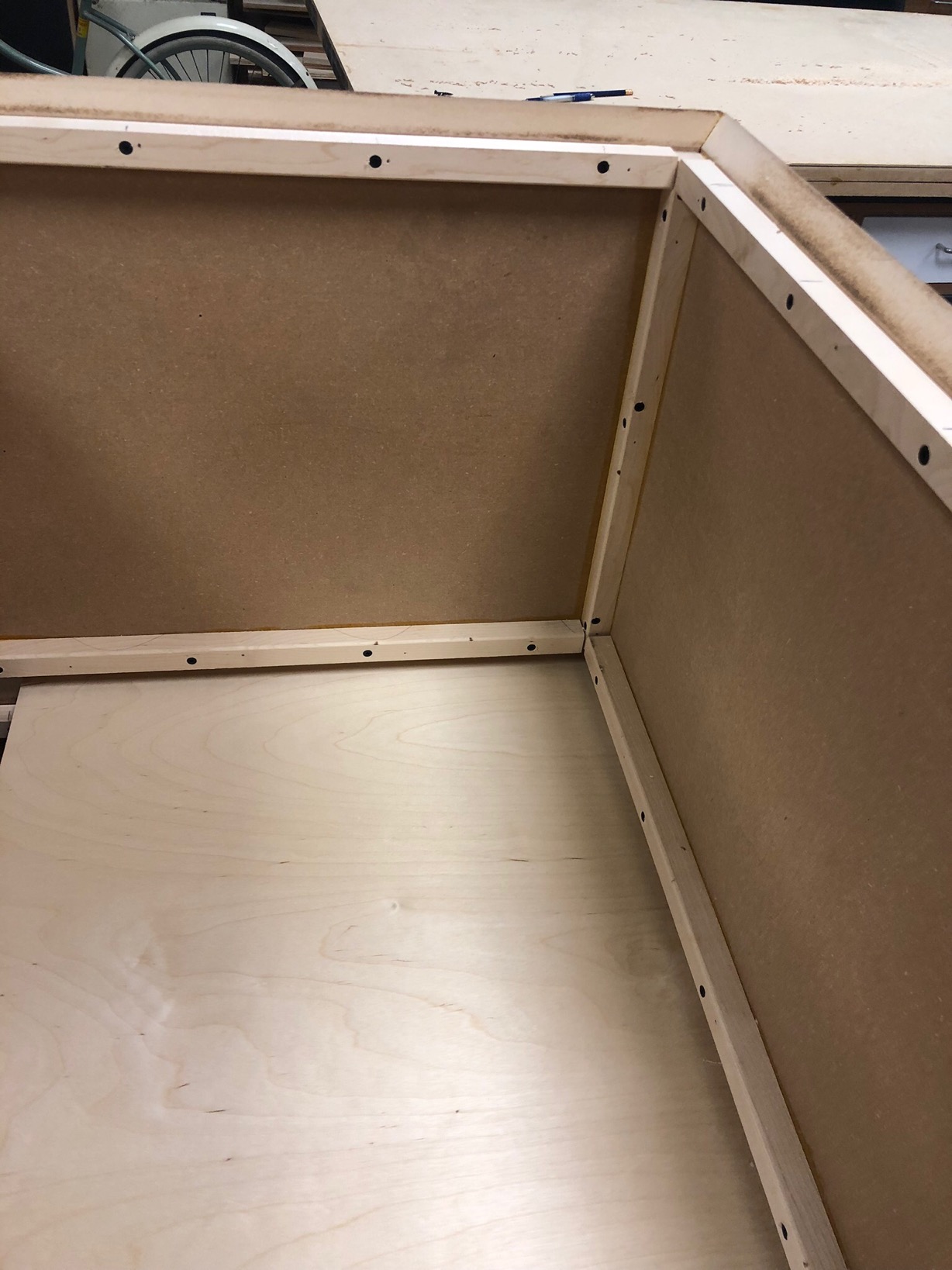

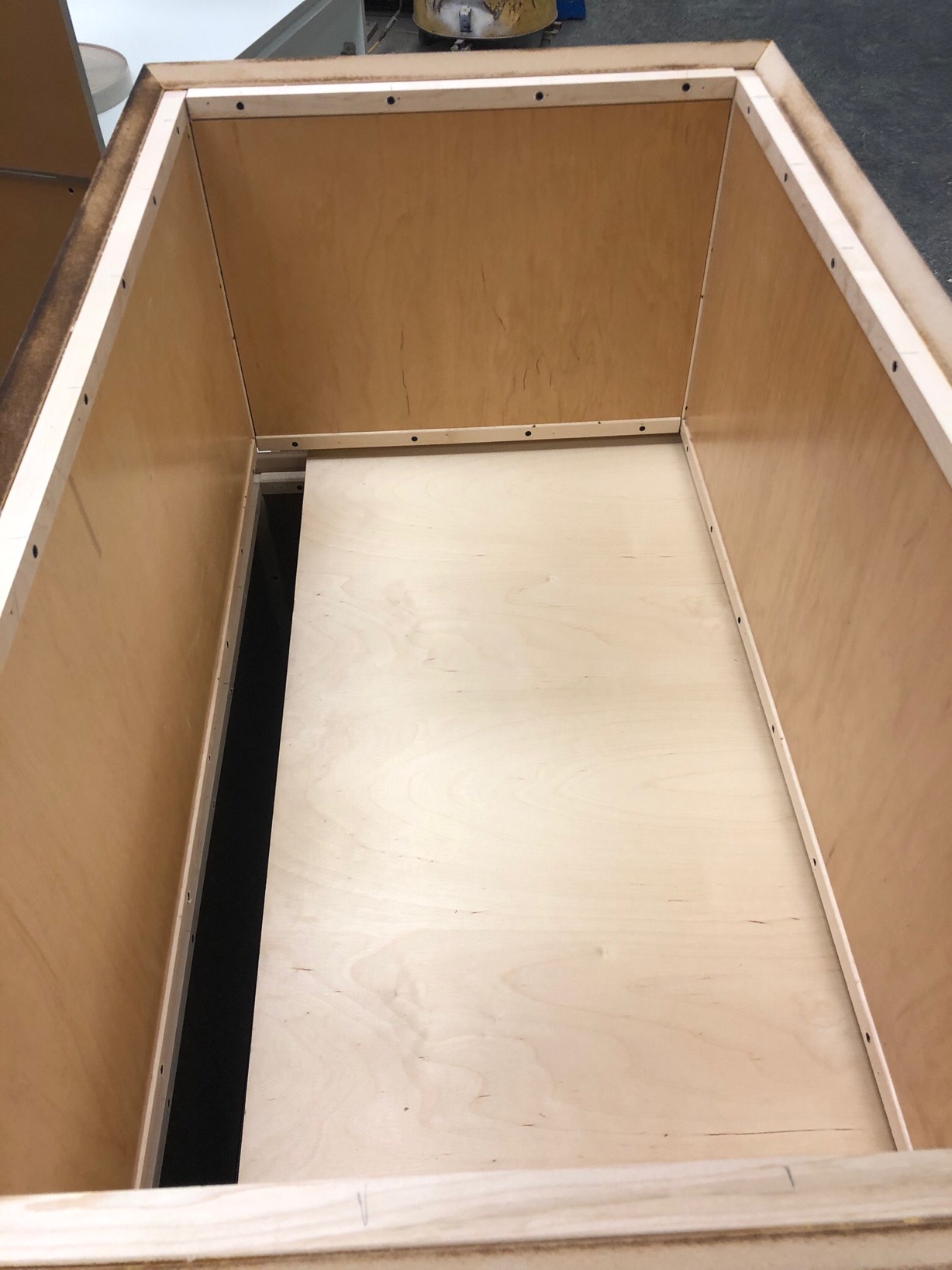

Put in 8 hours today on this project. Assembled the sides, tops, and bottoms. Installed the 7/8” x 7/8” solid Maple frame. I rounded two opposing corners on the Maple. One on the inside to leave room for glue to ease out and then outside corner just to make nice.
All the Maple pieces are cut about 1/8” short to allow for a difference in shrinkage/movement and not put pressure on the exterior painted corners. In case you see the gaps and think I can’t measure 😉
Then final cut the Maple ply to fit between the Maple frame. When the cabinet is complete the Maple frame will be buried in the corners. This gives me a way to really secure the perimeter of the cabinet. The Maple ply will be bonded to the Medex with 1/8” polyurethane adhesive.
For the horizontal braces, there will be one on each side of the 10” midrange for support and to create its separate chamber, and then one cut around and centered on the 18” driver. Due to all the holes and cutting I went with multi-ply 3/4” Baltic Birch for strength. Started on the transfer holes.
