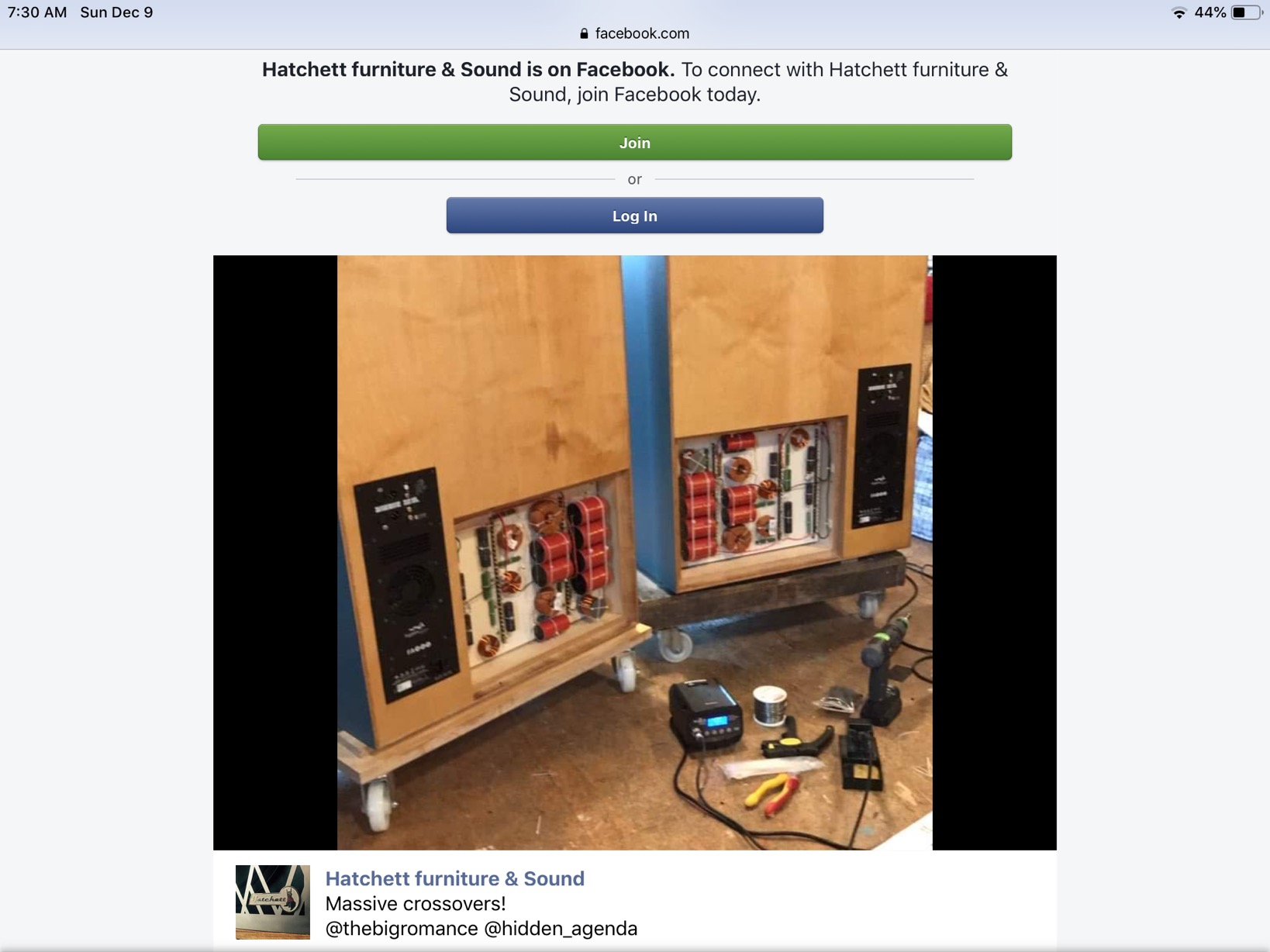

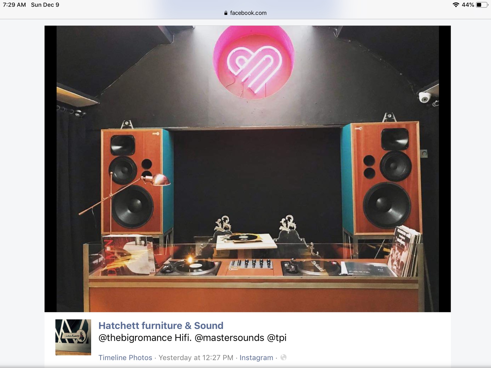

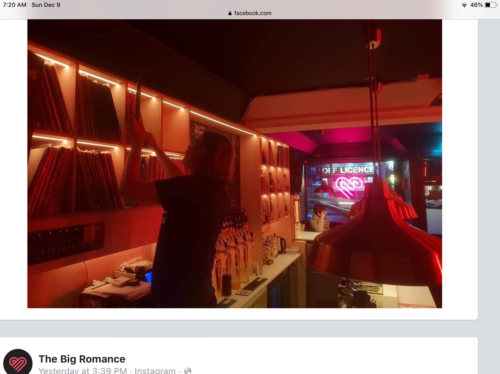

So been sleuthing around the web this morning trying to locate any other builds of “The Loudspeaker”.
Found a set in Dublin Ireland so far. At “The Big Romance”, a pub that plays vinyl, looks really cool, like to go myself.
AAB213F3-309D-4EA2-B41B-4ACA81566B6A.jpeg FAC5D310-DC4E-432A-A0E5-C8AD600DE6DA.jpeg 40BA81E0-3116-4F40-8D1C-7D2639FFDB2B.jpeg ECE8C028-7570-409D-9419-4C975AEB1B97.jpeg
Looks like Toby Hatchet built the speakers/sound system for them

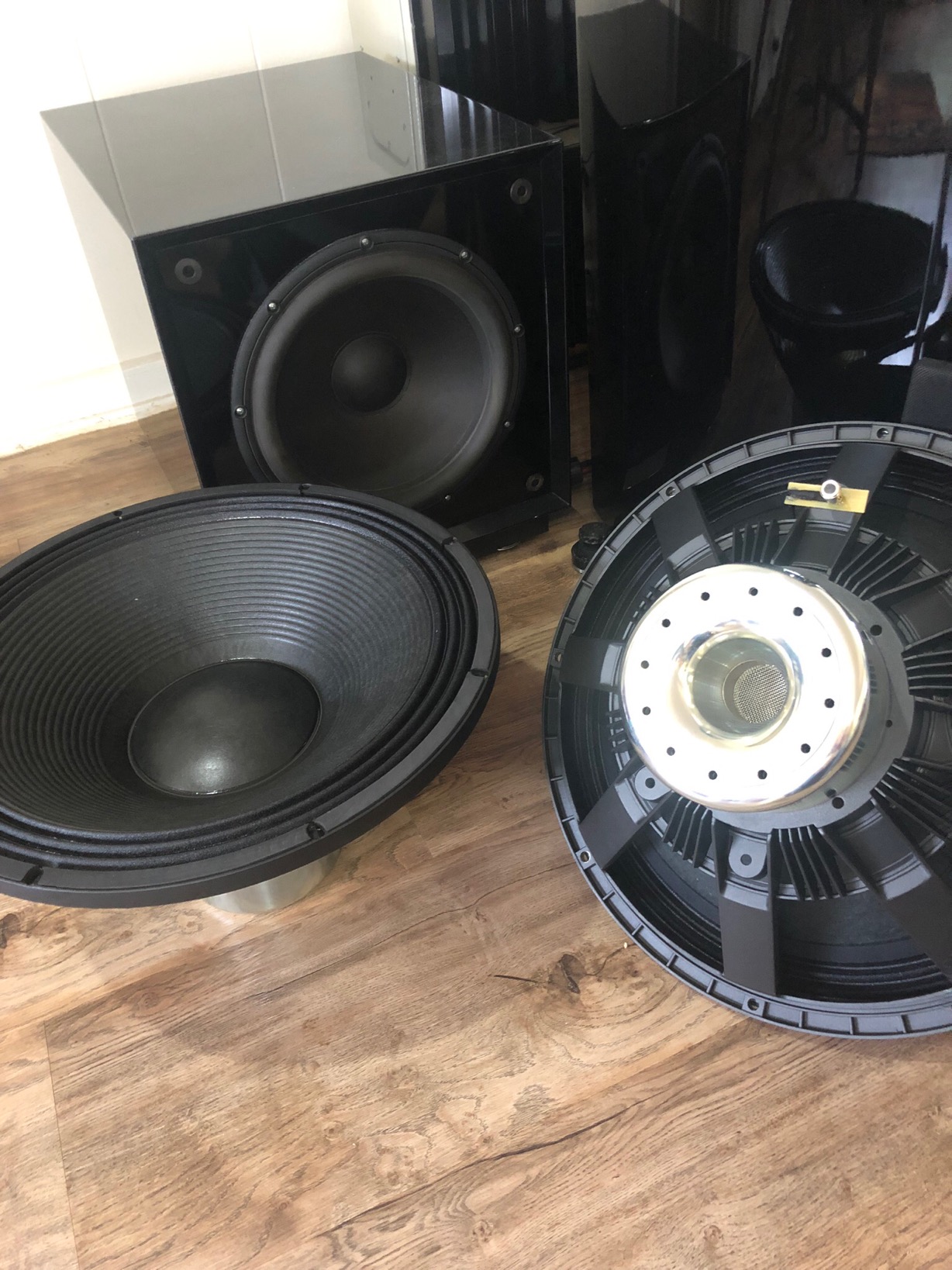

Drivers arrived!
Mother of @#&%!! 18” is a huge driver!

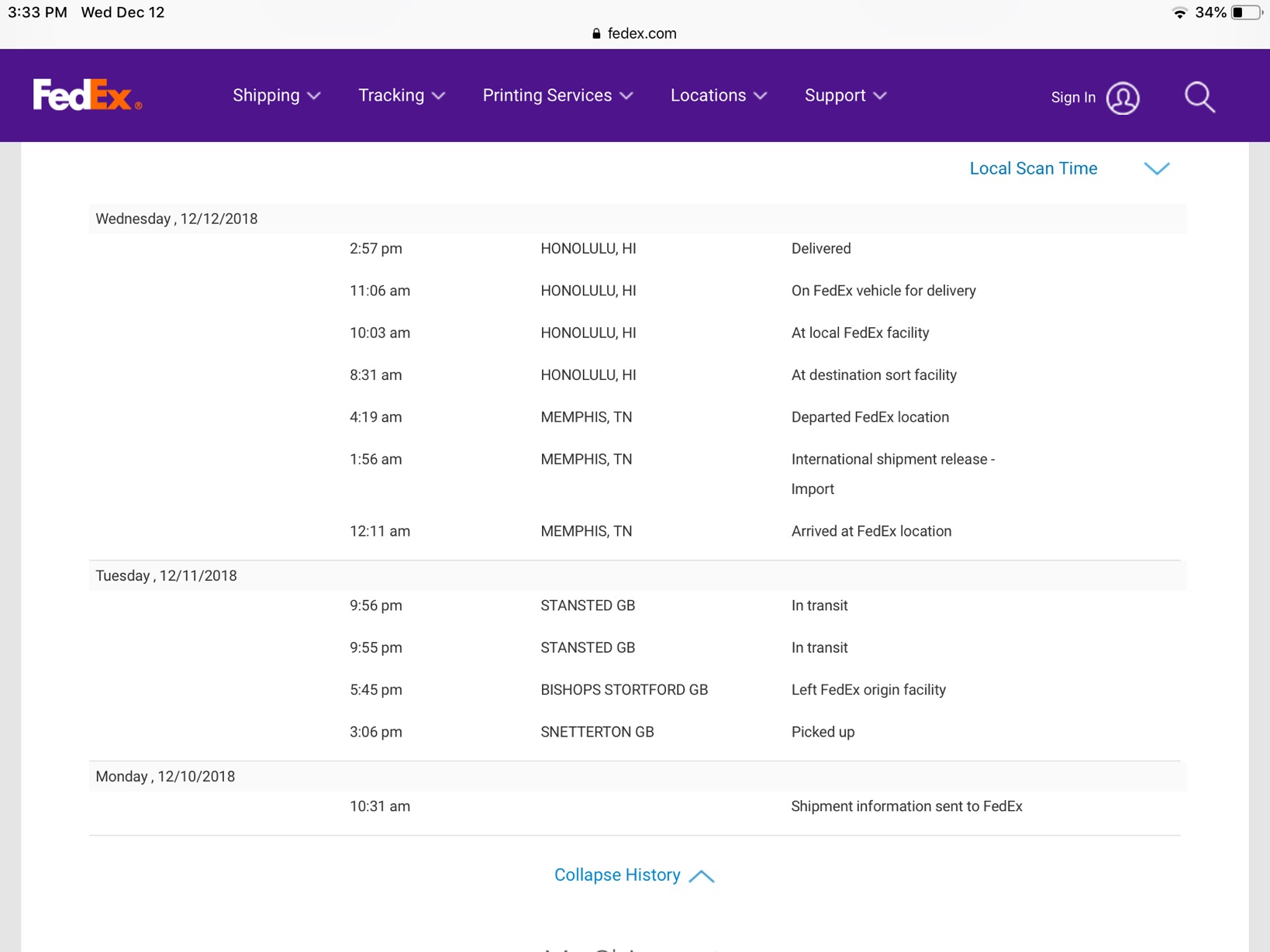

I made the purchase through Lean Business Audio out of the UK. I don’t think I could have flown in less time than it took for them to get here, picked up yesterday afternoon and delivered this afternoon. They only made one stop in Memphis, Tennessee.
Here are a couple pics. The 18’s in front of a 12”. Giant! I tried a couple ways to take pics for reference but still couldn’t capture it.
989AB814-19D4-45C6-A8EA-90415BE4DDBC.jpeg 97D7CB2E-8BE2-4087-B5CB-794627EE4ECB.jpeg
Tweeters arrive tomorrow, as everything arrives I update the details for the CNC, getting closer to having everything in hand to start. Will be traveling to the mainland through the first of the year starting next week, so will be slow start.

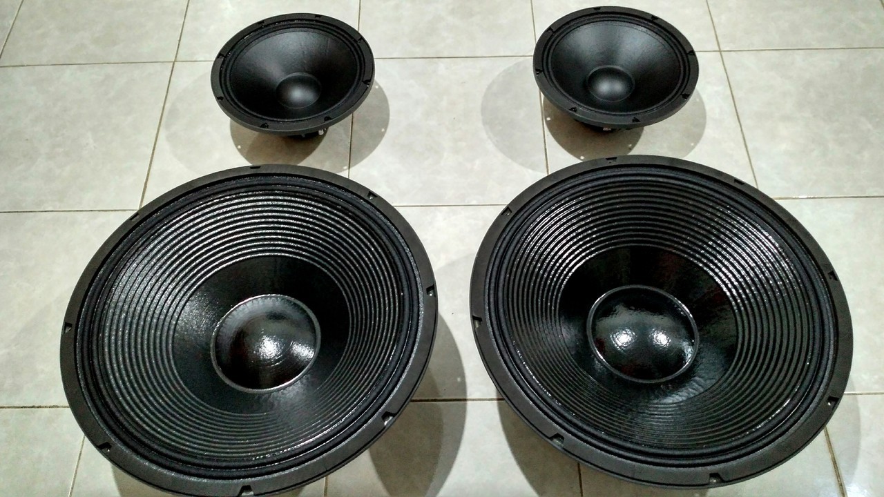

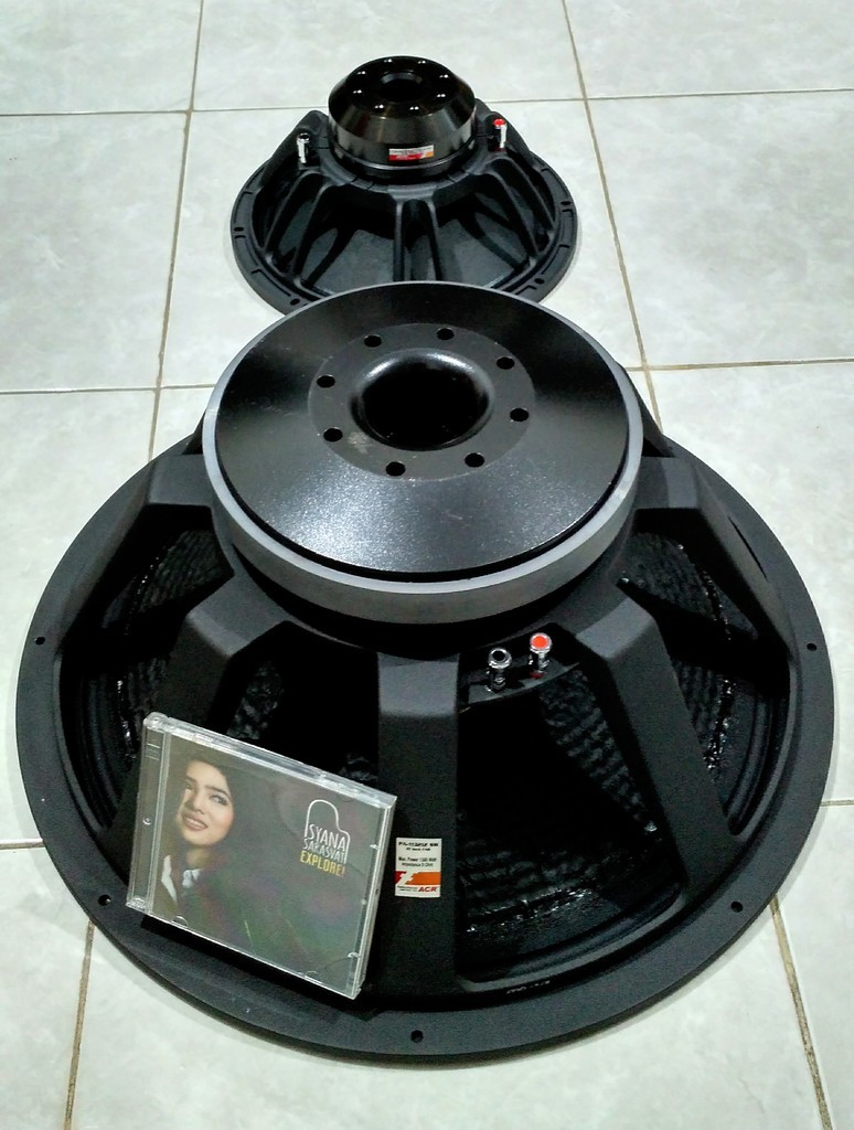

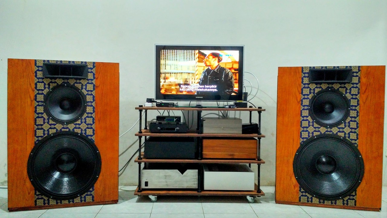

i had also tried to utilize big size driver but in OB (21" & 12") with horn tweeter just to answer my curiosity. Bad for me that I could not get the passive xo correctly between 12" and horn tweeter especially on close distance listening, hence i gave up and change direction to fullrange. Now I already got minidsp 2x4hd but i have sold the horn, might be different story for xo challenge. however utilizing dsp is already another project for me.
I still use the 21" and 32" wide baffle.
your 18" already use neo magnet which give 10.5kg weight while my 21" still use ferrite hence it is 19.5kg :D not an easy task to mount that beast
