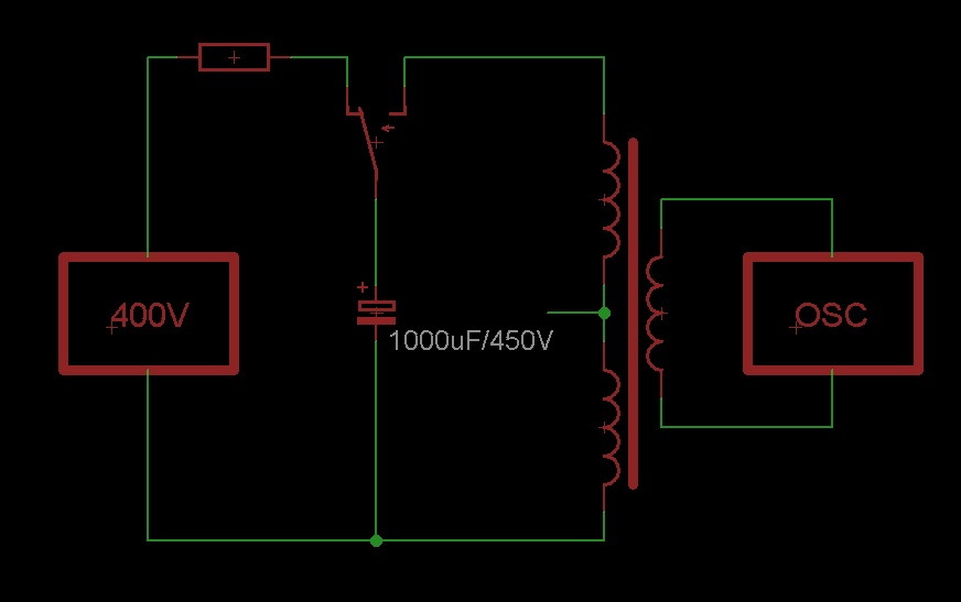

Do you think something like this? (Attachement)
Is it better way how to measure resonance? My method gives a big errors? Is the capacitance of the capacitor so important that it must be known? Because when resonant frequency is the ring frequency on the OSC... why known capacitance?

Yes and it has about 3200 turns of primary winding. I didnt wind it. Core material - i dont know - but my demand was grain oriented, 4% silicon steel. Do you think that they fooled me with core material?
