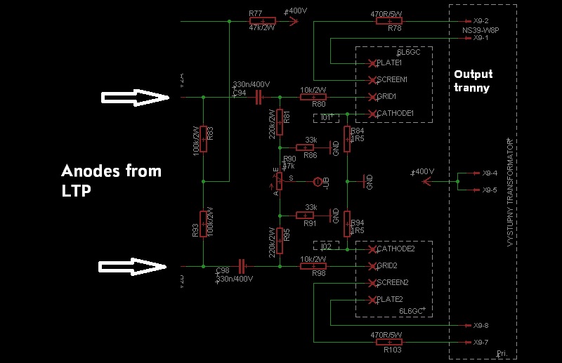

Just a thought: perhaps there are some very high frequency oscillations in your amp. By very high, I mean 100-200 kHz or so. Try some snubber circuits (~1-2nF cap and ~5-10k resistor in series) on the OPT, between each plate and B+ center tap.

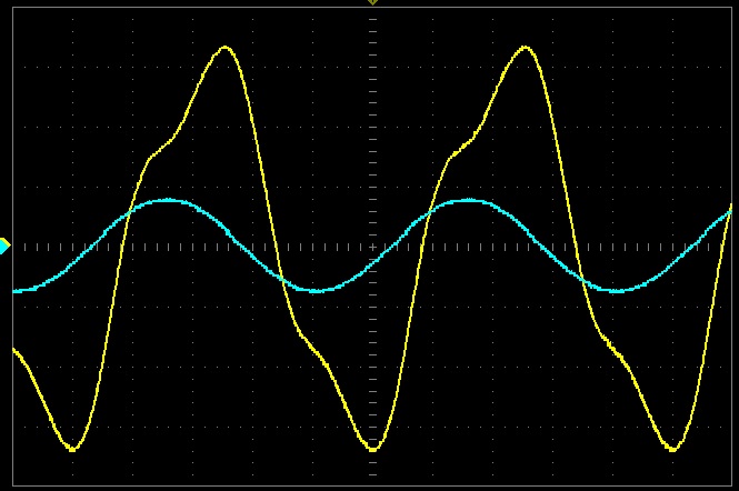

To me, it looks like slew-induced distortion: @ 20KHz, the output voltage lags the input drive by almost 90°.
This means that the load impedance is dominated by capacitance, and the tube's current struggles to charge and discharge this capacitance.
I do not see exactly why the current should be limited in a non-linear fashion by the tube, but I am not a tube expert.
The symptoms however seem clear enough.
It would be interesting to have a look at the cathode current by placing the probe on the 1R5 resistors

The capacitance you are talking about is input capacitance of the power pentode (Cag, Miller capacity, stray capacitancies..). Slew rate distortion occurs when previous stage (driver, phase inverter) doesnt has enough current to charge and discharge this capacity.
I also tried this and I builded a strong phase inverter with cathode follower which has an output resistance around 1kOhm.
EDIT: I definitely tried it - LTP with cathode follower with quescient current of cathode follower about 5mA which is so much I think for pair of 6L6

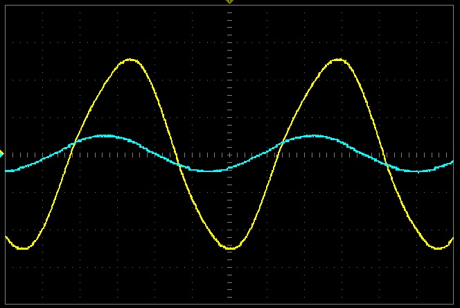

I checked cathode current before two days and I saw nice half-sinusoids at 1kHz and 10kHz. At 17kHz-20kHz there was some problem and half-sinusoids were distorted. But this was not a new information for me, because I still dont now why. Yes, it should be from slew-rate thing, but my quescient current is about 50mA per 6L6. I think that is a quite high number... The capacitance should not be higher as:
C = Ia / 2*pi*f*Vpeak = 0.05 / 6.28*20000*300 = 1.32nF
I measured 302pF at 1kHz. Capacitance will change with higher driving signal, but strange behavior starts earlier... hmmmmmm
