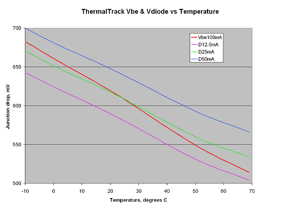

ThermalTrak TCvbe and TCdiode
For those interested, here is a plot of the Vbe of the NJL3281D ThermalTrak BJT Vbe and the Junction drop of its associated diode as a function of temperature from -10C to +70C.
The BJT is biased at a constant 100 mA, deliberately near the region of typical idle bias. The diode is biased at 1/8, 1/4, and 1/2 the value of the BJT.
The diode junction drop is about the same as that of the BJT when it is biased at about 1/4 the current of the BJT.
The temperature coefficient of the BJT Vbe is about -2.14 mV/C, while that of the ThermalTrak diode is about -1.7 mV/C. There is thus a thermal coefficient mismatch of about 0.44 mV/C.
These results seem to be pretty much in line with what Charles said earlier, where he indicated that the diode TC was about -1.6 mV/C.
Bob
Bob
Bob,
This is most useful-thanks.
Per chance, did you look at the Vbe of the PNP compliment-NJL 1302D?
...Jim
...Jim
Jim Hamley said:Bob,
...Jim
Hi Jim,
I haven't yet looked at the PNP in this detailed way over temperature. However, I do seem to recall looking at the PNP Vbe and diode voltage at room temperature at a couple of different currents, and I think they were pretty much the same as this data, at least at room temperature. Knowing what I know now from the construction of the device, I suppose I should not be surprized that the diode is pretty much the same. I'll see if I can dig out those notes and at least confirm that the PNP Vbe was about the same as that of the NPN at room temperature.
Bob

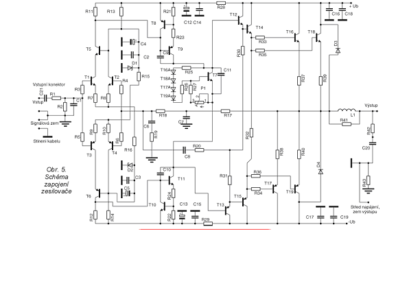

I am following this thread from the beginning and at some stage, I
transferred Mr. Cordell's idea of biasing of TTrak devices to Dr. Jagodic.
Here is one possible solution done by him recently as a prototype. I asked
him for permit to publish schematic of this design and he didn't objected
but he wasn't particulary interested neither. His general policy is not to
discus and elaborate his designs in public and for real experts here that is
probably not necessary.
All I can say is that prototype sound amazing and is rock stabile in all
aspects. Some changes were necessary because it was impossible to reduce
total bias under 550mA with original values. Now bias is 150mA per pair and
is rock stabile and drop just 5mA from cold to 70*C. Output ofset is +1,2mV.
My contribution was to design and produce PCB based on Dr. Bora remarks and
requirements.

Some general explanation of operation (to the best I understood from few
chats with Dr. Jagodic ):
-Input stage is modified and improved Quinn cascomp according to research
of some Mr. James Woo. Even Mr. Woo version is little more modified and
simplified by Bora
It was very essential to do perfect possible matching of most input PNP
devices to have good results and also of two VAS NPN-s.
-VAS stage is Dr. Jagodic favorite standard differential type but as he
frequently do, it is buffered to keep best performance of good specs of
small transistors in VAS without need to set them in high current and
disipation and to isolate VAS from capacitances of following stages
-predriver/driver & output is according to Mr. Cordell idea, but in
practice it was necessary to be little modified because quiescent current
was more than 500mA and no way to reduce it. That stage also use Baker
clamp.
PCB was real pain in the ***! To keep PCB single sided and tracks
reasonably short, Dr.Bora suggested small accessory board mounted
verticaly on main board and containing majority of output stage
components.
If there is interest, I can post PCB design file and layout file if
someone want to try.

I don't think two series diodes will give sufficient temperature compensation.EWorkshop1708 said:For Designing an amp with just a single pair (or two pairs) of output transistors, just using the diodes to bias, ..................I have the NJL4281/4302 variants. I want to use them in a simple 4 channel setup with a single pair per channel. It would be nice and simple to build if all it needed was 2 output transistors each channel, and the thermal diodes, and a fixed resistor (calculated) to set the desired bias. I wouldn't care if the bias was perfect, but as long as it didn't run away when hot.
There might be enough but so far I 've only seen 4diodes being used.
The Leach which uses separate diodes in a modified Vbe with 4 in series is overcompensated.
One could possibly hook it up in a diamond buffer style. That is, as a basic scheme, from input via the diode and series resistor to a current source, and from the node below the current source to the base (via stopper), plus the usual emitter R, and probably some caps as AC shunts. And the complementary likewise, mirror imaged. According to various preliminary sims (haven't tested the TT in real life as of yet) there is a combination of current source, series R and emitter R which gives a good operating point, and adjustable amount of compensation tempco, spanning both negative and positive tempcos.
Cons: single wire input (you'd need a good buffer stage ahead of it) and current limit / SOAR protection is a bit tricky to implement. I might suspect problems for a typical class-A/B stage (I simmed only class-A, with occasional class-B transients -- a complementary push-pull cyclotron as the design concept).
