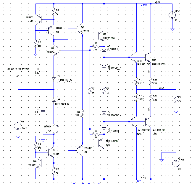

Here's the schematic of Bob's biasing network:

Bob Cordell said:
Hi Jan,
My measurements of ThermalTrak devices have shown Vbe to be about 610 mV at 100 mA IC, while Vdiode is about 610 mV at 25 mA Id. It sounds like you are measuring the diodes at a much lower current.
On that note, I would also point out that using the ThermalTrak diodes in the base circuit of a Vbe multiplier will typically have them running at a rather low current, perhaps on the order of 1 mA.
If you choose to use a Vbe multiplier, I suggest that you place the ThermalTrak diode(s) in series with the emitter of the Vbe multiplier transistor, inside the Vbe muiltiplier loop. This then means that the effective Vbe of the Vbe multiplier transistor will become Vbe_qm + Vj_D, where qm is the Vbe multiplier transistor and D is the ThermalTrak diode. The majority of the VAS standing current will then pass through the ThermalTrak diode.
Bob

This is a ThermalTrak bias circuit that I came up with that I have been working with. It shows a couple of examples of how the ThermalTrak diodes can be used.
The circuit is in the form of a Class-AB 100 watt output stage in simulation form. The circuit is essentially a triple Darlinton “T” circuit that employs two pairs of NJL3281D – NJL1302D OnSemi devices.
Q1-4 just make up a pair of 10 mA current sources that, in combination with the input voltage source, simulate a typical VAS.
Q5-6 and D1-2 make up a feedback-based bias spreader. D1-2 are the key ThermalTrak diodes that work to establish a stable, temperature-tracking bias. The use of the feedback-based bias spreader, as opposed to a conventional Vbe multiplier, eliminates the influence, drift and uncertainty of the pre-driver and driver Vbe’s in establishing the output stage operating point.
Q7-8 and Q9-10 are the pre-drivers and drivers. D5-6 provide a diode drop of voltage offset to make up for the Vbe of Q5-6. D5-6 and Q5-6 are NOT on the heatsink. The relationship of voltage drop for a given current for D5-6 as compared to Q5-6 is involved in setting the bias current.
The voltage drop across R5-6, caused by R7, sets the voltage that will ultimately appear across the emitter resistors R13-16 (albeit modified slightly by some Vbe differences). In practice, R7 would include the bias-setting pot.
The d.c. feedback from the emitters of Q9-10 to the bases of Q5-6 sets the output stage operating point, and forces a tracking relationship between D1-2 and the Vbe’s of the output transistors.
If D1-2 had the same junction drop as Q13-14, and Q5-6 had the same junction drop as D5-6, you can see that the voltage drop across R5-6 would have to equal the voltage drop across R13-14. Corresponding junction drops are at essentially the same temperature. Note that power dissipation, and thus self-heating, in Q5-6 and D5-6 is quite low. This is how the feedback-based bias spreader works. Although in practice the above-mentioned equalities do not hold perfectly, they are close enough, and net differences are made up by trimming R7 to set the idle current.
The two “extra” ThermalTrak diodes, D3-4, are used between the emitters of the driver transistors to establish the idle current of the drivers while keeping the impedance between the emitters very small, so that the drivers can operate in push-pull to provide turn-on and turn-off current to the output transistors. Keeping the impedance between the driver emitters very low at high frequencies is essentially what is often done with the speedup capacitor. The ThermalTrak diodes make it possible to do this in a d.c. fashion with the necessary precision because they track the output transistor Vbe’s.
Bob

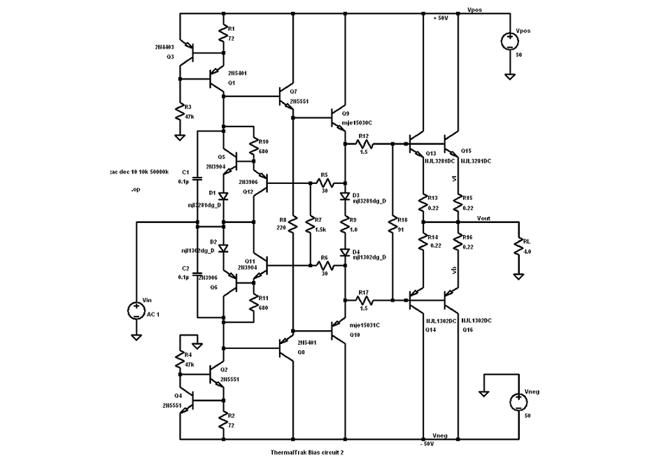

Another ThermalTrak Bias Circuit Variation
The attached circuit is another version of the ThermalTrak bias circuit that I came up with. Some may find this one more attractive. The 1N4001 diodes have been replaced with transistor emitter followers Q11-12 to provide the one-Vbe voltage translation to cancel the Vbe of Q5-6. These emitter followers are powered by stealing one mA from the bias spreader via R10-11. Their collectors are simply returned to the junction of D1-2 to define their collector voltage.
Note that this arrangement buys us one Vbe of additional headroom on each side as compared to the earlier arrangement that employed the 1N4001 diodes.
The second change is the addition of output stage base series resistors R12 and R17 shunted by R18. This combination of resistors causes a slight bias voltage drop of about 20 mV to the output transistors. The purpose of this is to allow the drivers Q9-10 to be biased a bit hotter (now 48 mA) while keeping each output transistor at its desired operating point of 125 mA. Obviously this function can be combined in various ways with base stopper resistors if they are used.
Note that the use of the feedback-based bias spreader is especially advantageous if one is using MOSFET driver transistors at Q9 and Q10, as it will make the bias-setting largely independent of the gate voltage of the drivers.
