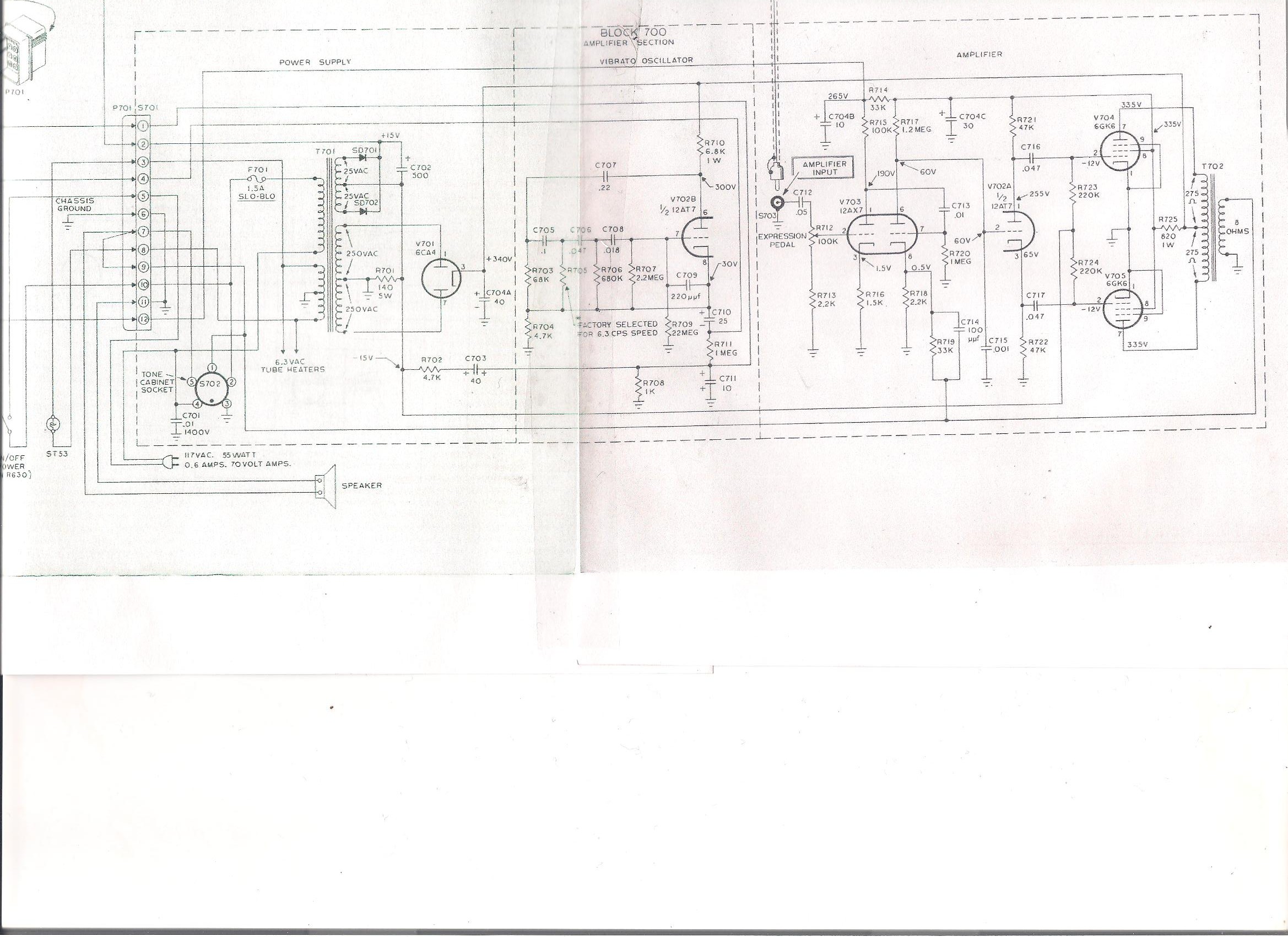

I just got this amp from a Thomas organ and while checking voltages I found that I have no voltage on the bias line. The schematic shows I should have -15v but my meter reads 0. I have only turned it on for a short time but it did seem to work ok while it was on. I did have the 25vac but I get +35vdc on the + side of C702 but 0 on the other end when it should be -15. What would cause this?

Where does pin 1 and 2 go? (this might be important to why we are not seeing -15V)
It appears they are to bypass that 1M resistor or have some input into that line you are trying to measure.
Also do you get the correct labeled voltages around V7028?

The 25+25VAC winding + diodes SD701 make a DC supply with unloaded voltage of 35V DC.
It's a *floating* voltage, not directly referenced to ground.
Now, if you ground it through R701 and connect the other end to some "mystery" point which sits at +15V , which "eats" 107mA, and voltage drops to 30V DC, then one end of C702 will also sit at +15V and necessarily the lower end will be at -15V.
A very "iffy" design, depending on a delicate balancing act to work at all.
Personally I would disconnect C107 "+" end from connector S701 pin 2, would ground it through another 140 ohm 5W resistor, so as to have a balanced and symmetrical load (basically I'm replacing the mystery elements at the other end of the connector) , now I will have the proper -15V bias and call it a day.

I have never even seen the organ it came from and cant find any useful info it so the mystery parts remain a mystery. I had planned on using it as a guitar amp and usually would just gut the thing but I am curious to see how it sounds with the original tremolo and 6GK6 tubes. When I read voltages with tubes I get about 265 B+, with only the recto I am getting 420v B+, is that normal? It seems like quite a big difference. I don't see a C107, do you mean C702?
I installed the 140R and all voltages are right on. Now how can I can the tremolo to work again? Something was connected at S701 pin 1 and 4 but I don't know what. I also am not able to get a voltage reading at pin 8 of V702B, the schematic shows 30v there.
The trem doesn't work? get the oscillator running, it appears to be free-running. Zero volts on pin 8 or the tube? OK what is on pin 6. Says 300v, but if it is really high, then the tube is not conducting. Are both sides of that tube heaters running? it is a simple circuit, you opught to be able to solve that part. Then we need to get the interface running. I SUSPECT that the lines going off the page merely short across R711. That then allows the oscillator signal to couple to your bias feed via C703.

I would completely agree - but the OP's problem is that the amp can't be used 'stand alone' as the bias voltage is dependent on whatever is connected to pin 2, and how much current it takes.
Easiest option would be to redesign the bias circuit sensibly, adding a small mains transformer, rectifier etc. and a preset to adjust the bias.

Agree, and my first reaction was to redesign a conventional bias source, using that 25+25VAC winding already present.
But then I got intrigued by the low value high dissipation R701 , which probably *is* needed for some other purpose (tremolo or feedback related?) so I preferred to "play along", simply connecting to that supply what it expected to see; another 140r 5W to ground.

I managed to ahold of a more complete schematic and I can see the 2 mystery wires from pins 1 and 4 go to a vibrato on/off switch and a full vibrato switch. The lead from pin 1 also runs to a transistor vibrato unit in the tone generator, so I give up on the original circuit. What is a good tremolo circuit I can use with only 1/2 of a 12A_7?
