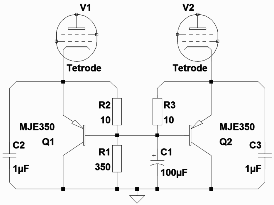

Would this work? 1st 65mA goes into the bias circuit, anything over 65mA bypasses...
Assuming like a 50mA+50mA quiescent situation???
I prollyshoulda thrown 150R in series with each collector, stop a runaway at 345mA.
Maybe this is no better or different than Zenier bypass...

Does it make sense to use a CCS in the cathode of a PP amplifier's output tubes?
As stated before this forces class A operation and works best with triodes. Attempting to drive the triodes into A2 causes distortion. Within those constraints the output tubes function as an LTP. This affords the advantages of LTP operation the best of which is immunity from common mode noise.
I have built an amp that runs a 6SN7 LTP driving another 6SN7 LTP driving a pair of KT88's in triode LTP. It produces a very clean 12 watts per channel
I don't understand why are LTP with CCS and Class A related. One side of the LTP can be driven into cutover, then the other side will carry double current, i.e. the full CCS current. I can imagine even an AB1 operation.
AB1 full power has one tube conducting more than the sum at idle. With CCS setting this sum of idle currents there is no way to drive into AB territory...it just can't happen.
