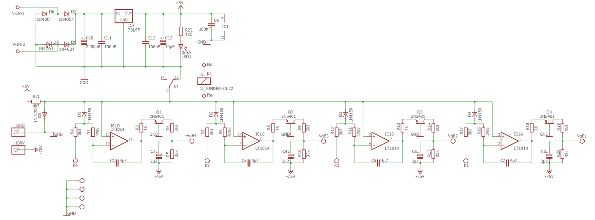

This is what I’m using now to bias my KT150 tubes:
Bias automaat - Pagina 39 - forum.zelfbouwaudio.nl
Unfortunately it’s in Dutch, but you can find the diagram and ZIP-files there too.
It works great. I added a 60 seconds timer for allowing a positive voltage to the voltage reference diode. This will protect the tubes during the heating phase. The autobias board would try to force a higher current through not properly heated tubes, with possible damage.
Regards, Gerrit
Additional information:
From each cathode to ground you need a resister (1 Watt) that determines the quiescent current.
Measure the voltage across the reference diode D5. For example a 1N4448 may give a voltage of 610 mV. The cathode current and resistor value are determined by the formula:
Reference Voltage / Cathode Resistor = Quiescent Current, for example 0.61 V / 6.1 Ohm = 100 mA (per tube)
I have PCB’s in order for this. The cathode resistors are not placed on this PCB but directly from cathode to ground.
Regards, Gerrit
