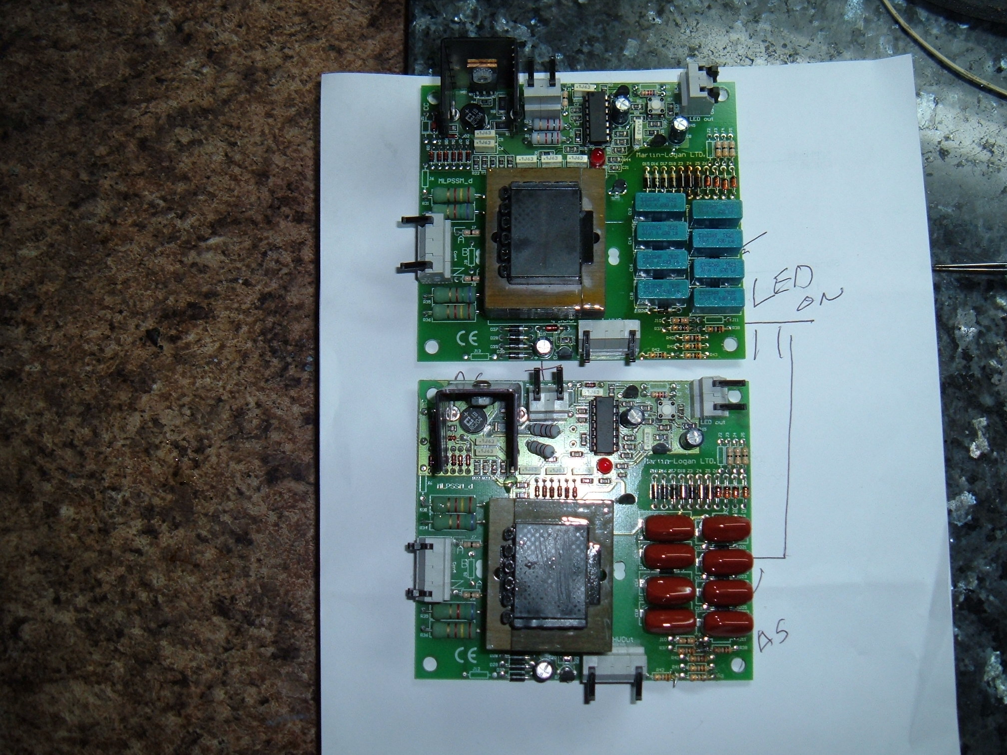

bolserst.........you have my trust...you have raised my understanding of all things ESL..or any other subject ..that I have read your info, input on....your memory is over the top!
but I have to tell you ...how I see it...when I am in a room were speakers are playing ....I am in the signal path.....my ESL bias point
For years now I have been buying older Martin logans an reworing the panels when I can.....over 10 pr.... in all the pic I can find....of the ML bias boards
look at this pic...of my latest ML finds... bias board....the one with the brown caps came out of a $10k pr of ML Prodigy...an is in all others ML I have found...back to 1995...not the cls..clx...
the bias board with the blue cap came out of a pr ML Ascent floor models I pic up for a song...... these blue caps give a sound...I have never heard out of any ML....not just one mans opine..
So from what Iam hearing..an others...night an day diff ...only thing diff in the boards is the caps... what added too the bias setup... CAN make the sound of a ESL....
I know the a diff cap can change the voltes....but that still changes the sound....right
Your a physic guy...I get it..an try to live there my self.....but I can hear big diff in the sound of any thing I do to the ESL bias.... with all do respect!...thanks for just being there..an yes I well speak for others...gladly

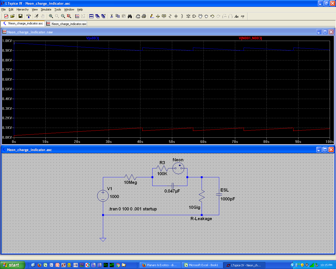

Sorry, still pondering this 🙂.
Say the light is on and thus my diaphragm charges up to 4000V...then the light goes off. How much of a voltage drop must the diaphragm experience before the light turns on again and charges it back up to 4000V? Presuming the bulb trigger voltage is 100 VDC, would it be 4000V-100V = 3900V ??? i.e. it "bounces" back and forth between 3900V - 4000V.
With my Acoustat 2+2s.....I can pull the ac on my bias .......an at med loudness...I get output for 3-5 min.... with out much loss in loudness output.....we well just have to see....hear this setup....don't go I wont know....
yes, that is the way it works.
When the voltage difference between supply and membrane reaches the treshold voltage of the lamp, the lamp fires and recharges the membrane.
So the membrane voltage 'bounces' slowly up and down.
One last remark:
The lamp's firing treshold (say 94V) is typically specced in the DS.
If the lamp fires, it doesn't burn till the voltage over its pins drops to 0V, but it switches off somewhere between 50-60V.
Taking the above example the membrane voltage never reaches the 4kV of the supply but would 'bounce' between ~3.90kV and ~3.95kV.

I agree...usually see voltage across neon lamps ramping between “strike” voltage level of about 95V and “extinction” voltage level of about 65V. If you are so inclined, LTSpice includes a neon lamp model in which you can define these voltage levels and the on-resistance. It will give you a feel for how the blink rate changes with component values and, unfortunately, bias voltage. If you increase bias voltage you will notice blink rate increases. This does not mean the resistance of the leakage paths have changed, just that the leakage current is increasing since it is proportional to applied voltage.
The attached LTSpice screen capture shows sim for the default neon lamp model parameters of 100V & 50V. Notice the 100K resistor in series with the neon lamp. You can use a resistance here to increase the “extinction” voltage if you want to try and minimize the amplitude of the voltage cycling. The downside is that the “ON” flash of the neon lamp gets shorter and fainter when resistance is added; blink rate also increases. If the resistor is too high in value, the lamp will dimly flicker at a high rate which is not useful for monitoring leakage currents.
@ bengel/tyu
Note that the panel mount neon lamps you guys posted links for include a resistor in series with the neon lamp inside the assembly. Depending on the value of this resistor, you may need to bypass it to get an easily seen blink indicator.
@ bengel/tyu
Wouldn't this "oscillation" be a bad thing? i.e. wouldn't the spl be, in effect, "modulated" by the changing diaphragm charge? If there was leakage (always is) and you just had it hooked up directly to the 10 MOhm EHT output, the voltage would stay the same (unless the leak exceeded the current thru the 10 MOhm resistor????).
Sure a 100V oscillation would have almost negligible effect on the SPL though - if I did the math.
The 30V variation in bias voltage at a frequency < 1 Hz would cause the sensitivity of the ESL to slowly ramp up and down by less than +/- 0.05dB; less variation for higher bias voltages. So, not really a concern, but easily bypassed with a jumper when not testing for leakage if it bothers you. Like tyu I find the flashing can be distracting if visible from the listening position.
If you have significant leakage in your panel, most ladder multiplier supplies will have supply ripple of similar or larger amplitude even without the neon lamp circuit...and this ripple is varying at audio frequencies so more of a concern from modulation standpoint.

Absolutely. If a different capacitor (type or value) results in different bias voltage, this would be noticeable as a change in the ESL sound. My experience is that if you adjust the input voltage for two different bias supplies such that the output voltage reaching the panel was the same, the type and/or value of capacitors made no noticeable difference in sound.…I know the a diff cap can change the voltes....but that still changes the sound....right

ML setup there bias with a 200v trans.....there bias is 3k60v...caps are .1mf 660v............
Acoustat bias trans 750vre ....bias is 5kv...caps are 3k .0033....biger cap sound better to me....
If all you are concerned about is ripply, you only need to upsize half of the capacitors.The only downside is 3kV+, .1uF caps are not cheap 🙂
