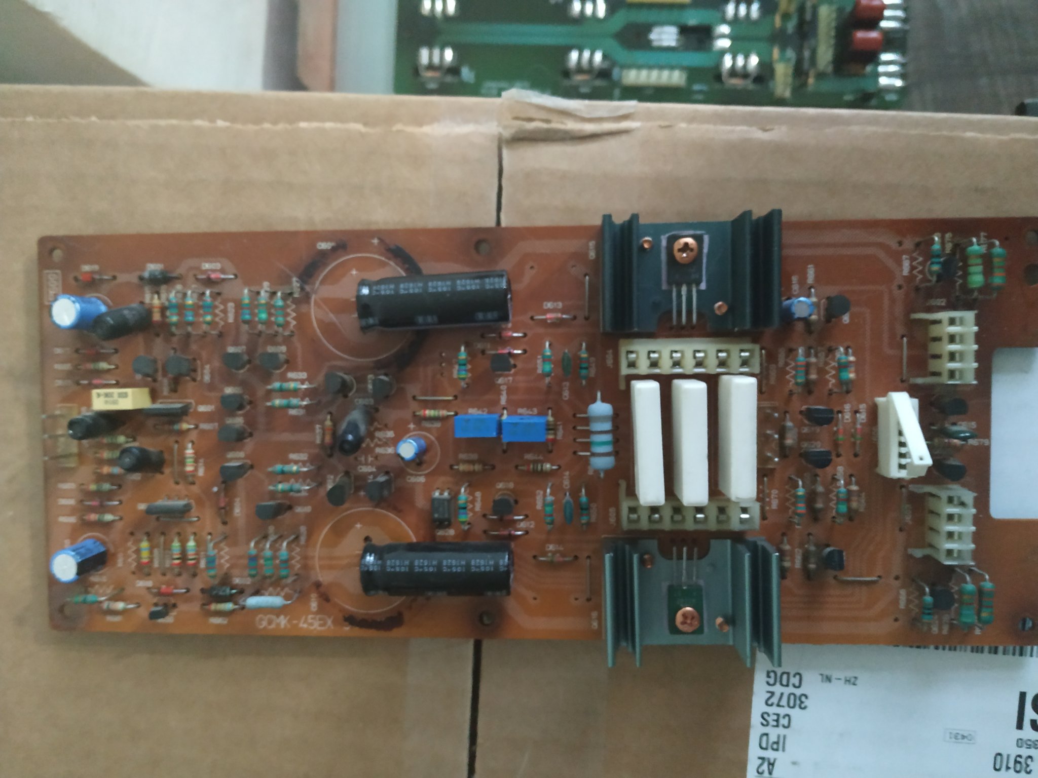

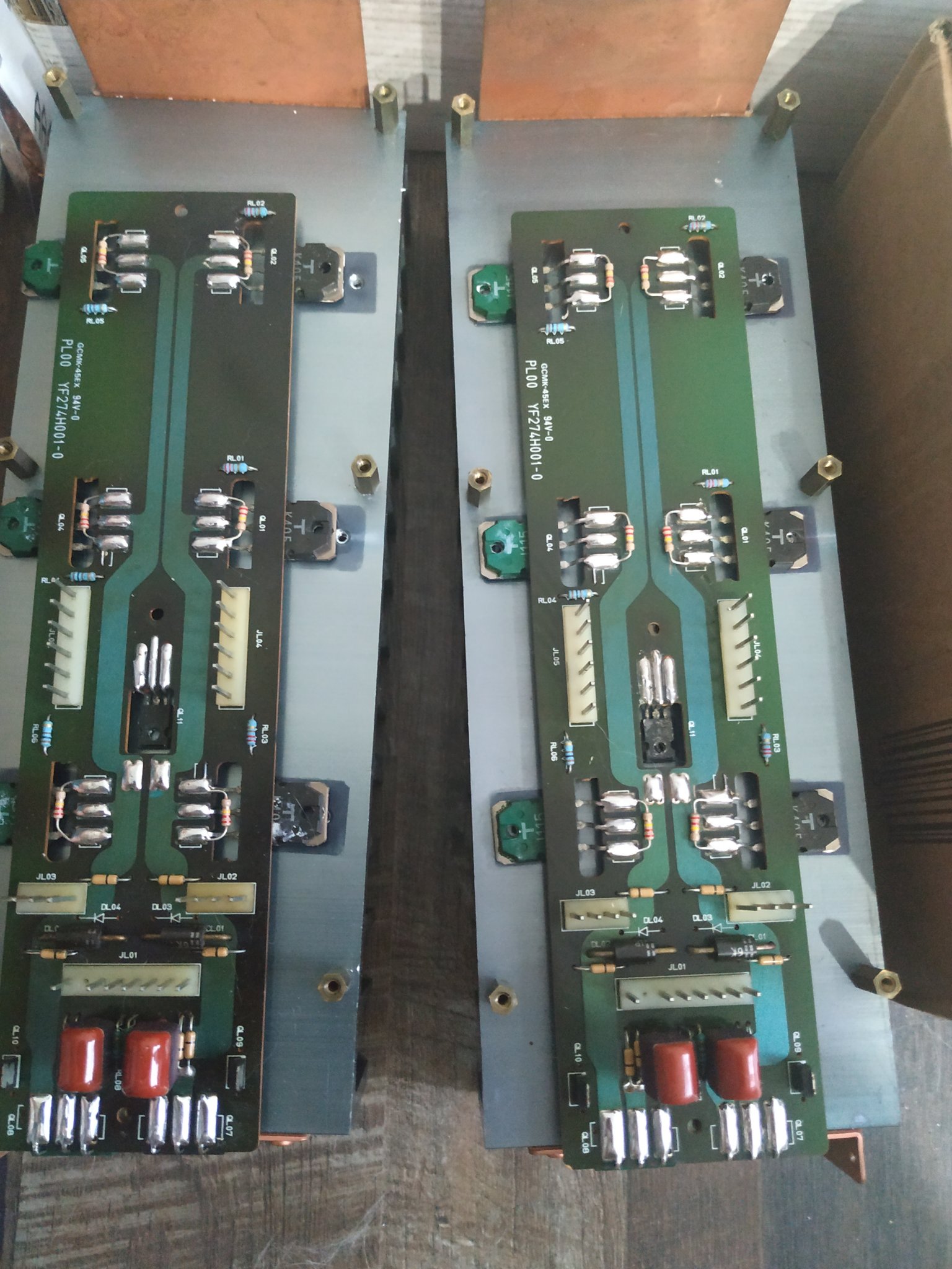

I decided to finally replace the trim pots with exactly the same values as before. Have resoldered all the transistors and other parts that were exposed to the heat. Was wondering Should I replace all transistors as a precaution, since the ones on the left were exposed to great heat and measured different than the ones on the right in circuit?
Or should I just fire it up and see how the bias behaves?

I would not replace transistors at this point. Get the amp working correctly first. Remember what feels hot to you is not necessarily hot for a transistor. If they sizzle a drop of water then that is starting to get to hot. If you can bear to touch it for even a couple of seconds then it is not hot enough to cause failure.
Reactions: freebee
Yes it is possible but that would be extreme heat, the sort of heat where a transistor actually starts to melt the solder for example.
Remember that to accurately check the transistors needs them removing and very detailed and involved testing to take place. You won't pick up meaningful differences just doing static checks in circuit.

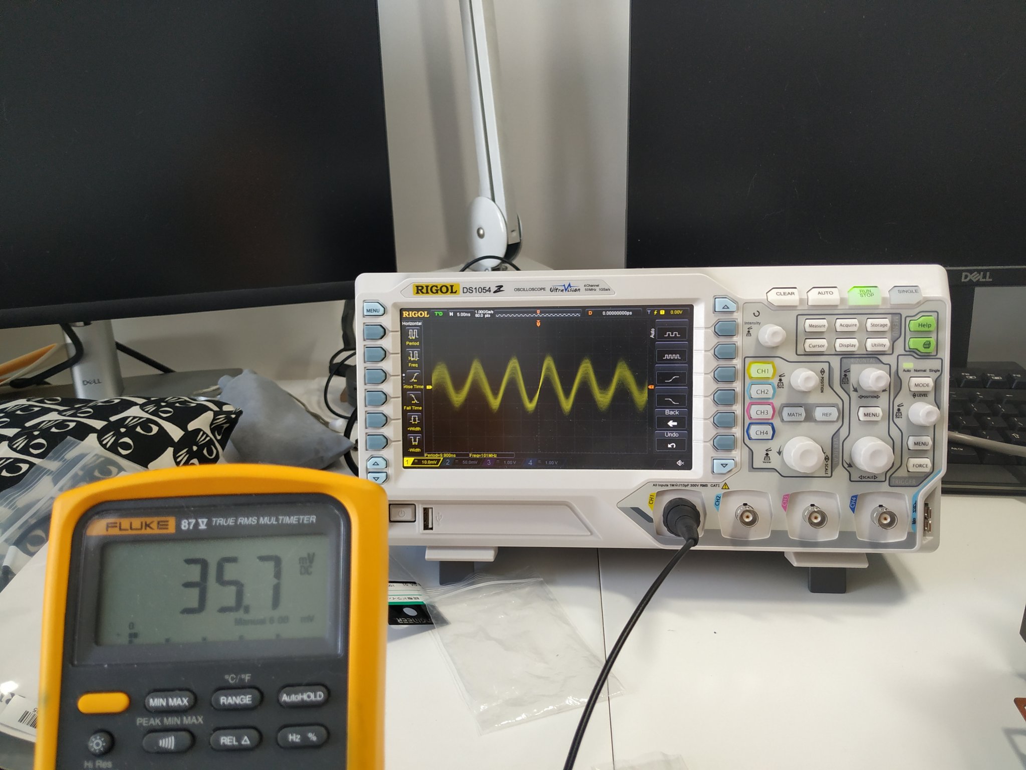

Hi Mooly, Thanks for your feedback. I do have a scope, however I'm wondering where the test points are to measure if the amp is stable. Where on the schematic should I measure? TP1-TP3 are for bias and quarter A, are there any other indicated test points?

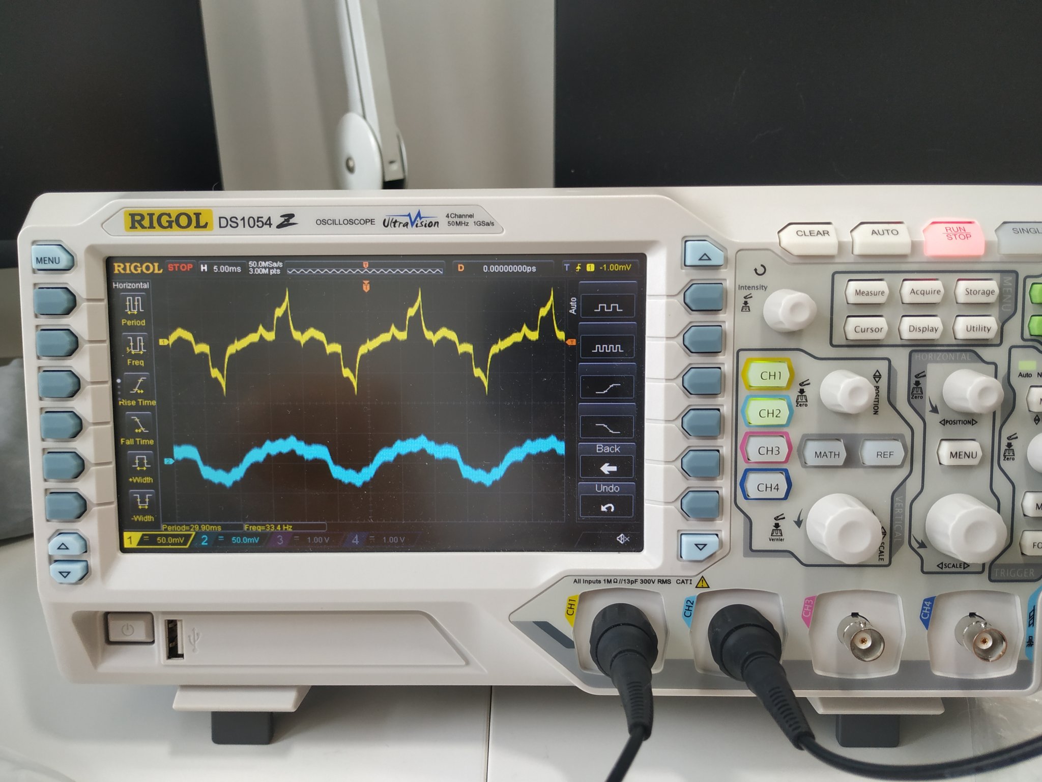

You look across the speaker output with the scope. With no signal you should just see a flat trace with nothing present. Oscillation that would cause issues would be in the several volts peak to peak region and at many 100's of kHz and higher... up into the low to mid Mhz region. So you need a scope that has that kind of bandwidth.

This is with the scope across the speaker terminals. Somehow I don't here the click of the relay when I switch on the amp anymore. Also, left side is not giving reliable bias readings and heatsink now stays cold (last night bias setting was ok and heatsink was the same temperature as the right).
I will follow your advice and measure all voltages before making any adjustments.
