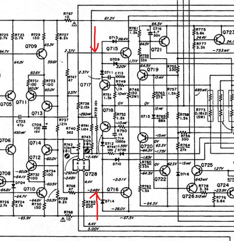

When the short between TP1 and TP3 is in place, at 36mv the right channel is warm like a class A/B amp. The left channel is now ice cold and I can't get it anywhere near 36mv (more like 1.5mv).

Its not a desperately easy circuit to untangle but I think you need to begin by looking at the voltage between the driver bases and comparing the two channels for a start.
Also look at the drive to the opto and compare between the two channels to make sure each is receiving the same drive signals.

Remember that however convoluted the bias control sees to be, ultimately the current is set by bringing those drivers into conduction and that is determined by the voltage difference between their bases.

The channel that is cold needs the voltage to the drivers measuring to see what is going on there. Does that bias voltage (between the driver bases) alter as the presets are altered?
The amp worked fine after recap. However, the temperature of the left channel has always been higher than the right. When I checked the bias of the left channel, I noticed that it was off. After adjusting it, all of a sudden the bias started to show erratic behaviour (went high, then low etc.) That was the reason I replaced the trim pots.
You are going to have to do some detailed measurements to try and get a handle on what is happening. You need to look the points I have mentioned and you must determine if the bias is altering because of a problem or whether it is altering in response to the drive to the opto.
