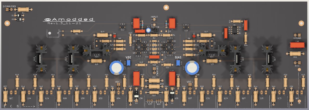

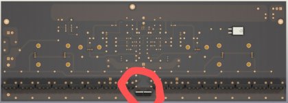

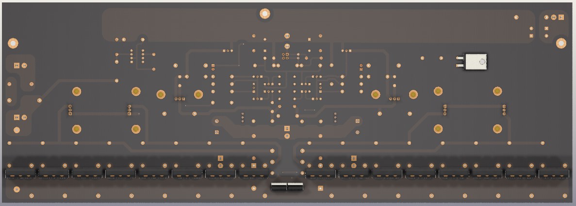

For now I just added fixed 220r and 10K pot as suggested regarding VBE.. I've noted this as a checkpoint, together with some other adjustments that needs calculation.
Since it's a new drawn PCB, there is a ton of other things that could go wrong when building, faulty PCB layout that could cause all sorts of other problems for example... I have enough powertransistors for one prototype, before new stock mid 2022! 🙁
I quite new in understanding everything involved in amplifierbuilding, the math behind really start make sense when probing, so for now, my goal is to make the circuit, starting with the single NPN-BIAS as I know this has worked for me before. After this I'll try the PNP also, measuring and understanding it's influence

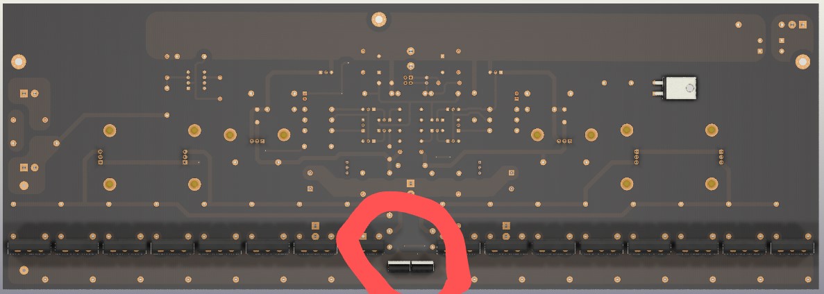

Non est tantum facilePositioning the sense transistor is an interesting exercise in itself.
You can calculate the thermal impedance path from the output and drivers to ambient, and as the heatsink temperature will not be as great as the junction of the output device (usually the hottest) you would conclude that you need a greater multiple of Vbe than the 4 I suggested, by the ratio of the thermal impedances.
However if you put the bias right next to an output device (such as on the metal can but insulated) 4Vbe's could over-compensate because the output device(s) is/are hotter than the drivers. (Usually).
Putting the sense device on the same heatsink as the driver and output is a compromise that worked for me in many designs. This may explain why the simple multiplier circuit actually works as well as it does.
The actual 'multiple of Vbe' isn't the problem. We have a twiddle pot to set the exact bias current we want under our specified condition.
The problem is what happens when the amp heats up & then cools down. For this we need to match the "thermal gain" ... which is determined by the EXACT positioning and mounting of the sensing device (the BJT in our case) ... to the 'voltage gain' provided by the Vbe multiplier. This also needs to allow for thermal lag as everything heats up and cools down.

hcpower, where are you mounting your sensor?

The chassis will be a Modushop Dissipante 5U/400mm. So lots of heatsink, to provide a decent cooling of the transistors
1) WHY do you want a PNP there?any suggestions to implant an 2SA1837 PNP-transistor to this circuit. I want a more stable design.
No special advantage whatsoever.
2) as suggested by many and specifically by Mr Nelson Pass , a transistor junction and matching Vbe multiplier is good enough.
As also suggested above, your main problem is not "electrical" but "thermo-mechanical" , meaning how well sensing transistor junction temperature tracks heatsink temperature.
And that depends a lot on heat sink geometry, mass, and thermal coupling between sensing transistor and heatsink metal.
Some drill a hole if thick enough and put a TO92 transistor "head" inside,often with an drop of thermal grease.
Being a Minimalist, find dealing with a single silicon junction enough, and shudder at your circuit having THREE, which to boot won´t couple equally or well to heatsink .
Fear you add problems without really offering solutions.
You could design a better tracking system by detecting sensor Vbe drop and then non linearly processing that voltage to calculate actual power transistor *junction* temperature, but that is a higher level of complexity solution beyond a regular Forum thread level.
So far we are actually tracking heat sink temperature, not the same.
In fact somebody around here cleverly mentions that in his signature, go figure.
So in a nutshell: I´d go back to the original "transistor+2 resistors" Vbe multiplier Bias and if needed improve thermal coupling.
Nowadays, the current State of the Art.

You are not making this easy @john_ellis😉
I published my project in another forum where everyone pointed towards a PNP/NPN-BIAS.... Diyaudio is the first where I'm recommend to leave it as a single NPN/2-resistor network.
I will upload a better schematic when I'm at the computer.. That said, I'm using a knock-off 2SA1837/2SC4793 from UTC in TO-220 packed
Regards
Regards

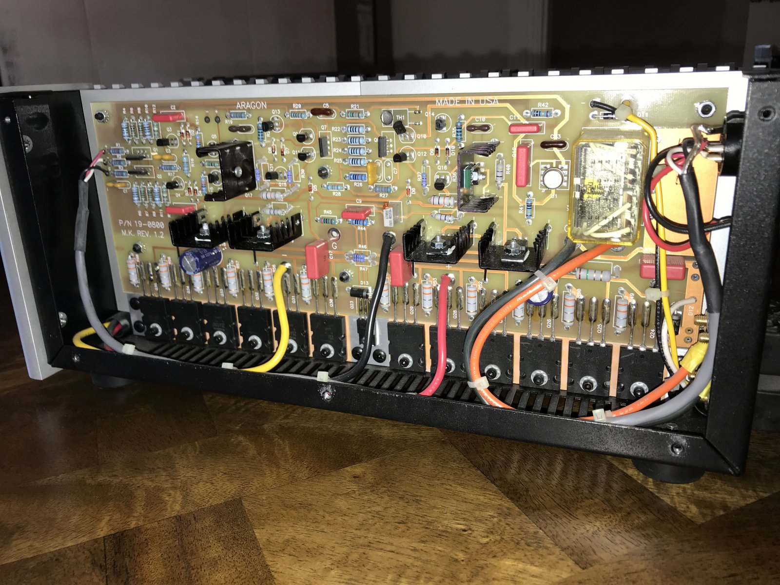

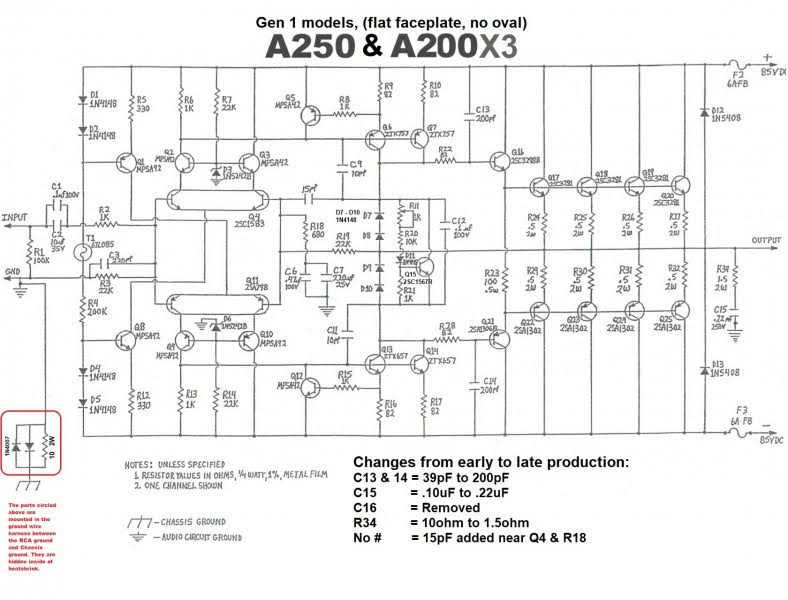

The schematic before I laid my hands on it, is highly inspired by Acurus A250/Aragon 8008. Put the two schematics together, and you'll quickly notice. The thought is to add the power that the 8008 never had. I own an A250 that is highly modded for everyday listening, and most of the new schematic has been experimented in this amplifier without problems..Just curious, what would the other Forum be?

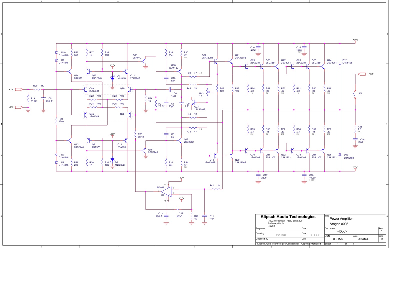

Looking isolated at the Aragon 8008 PCB (Google is your friend), one would realise that Mondial managed to produce am amplifier with 6 drivers mounted with a separate heatsink on the PCB.
Still a single NPN for BIAS though.
Voltage is raised from 70VDC (Aragon 8008) to around 85-90VDC, and will cause ekstra heat. Thereby the bigger heatsinks at the PCB, and bigger heatsink on the amplifier chassis itself when build.
I'll stick to the 2SA1837/2SC4793 TO220 devices as used in the 8008 both at drivers and BIAS.

Ok.... First the inspiration...
The Acurus A250 and Aragon 8008 schematic. Last picture is the Aragon 8008 PCB regarding the layout of drivers and NPN-BIAS in center at the bottom.
Rails in A250 is 85VDC, but often measured above 90VDC in the units I've seen.
8008 is 70VDC
I'll return with my own schematic in next post, with both the new PNP and the original layout

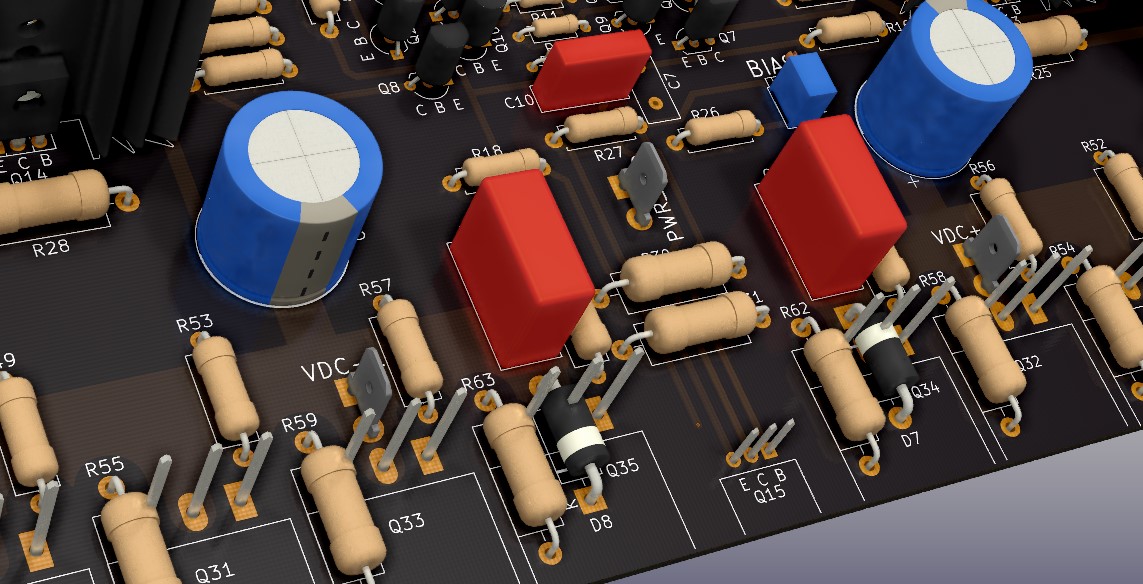

Here is my sche.... 90VDC rails..
The NPN and the NPN_PNP-BIAS setup..
Pic attached is the one with added VBE-pot and PNP to BIAS, in center of the powertransistors
Best Regards

Where did you mount the 2 sensors?
Did the drivers & pre-drivers share the Heatsink with the outputs & the sensors?
