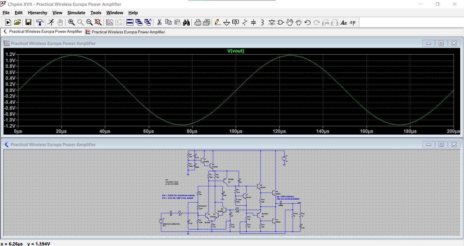

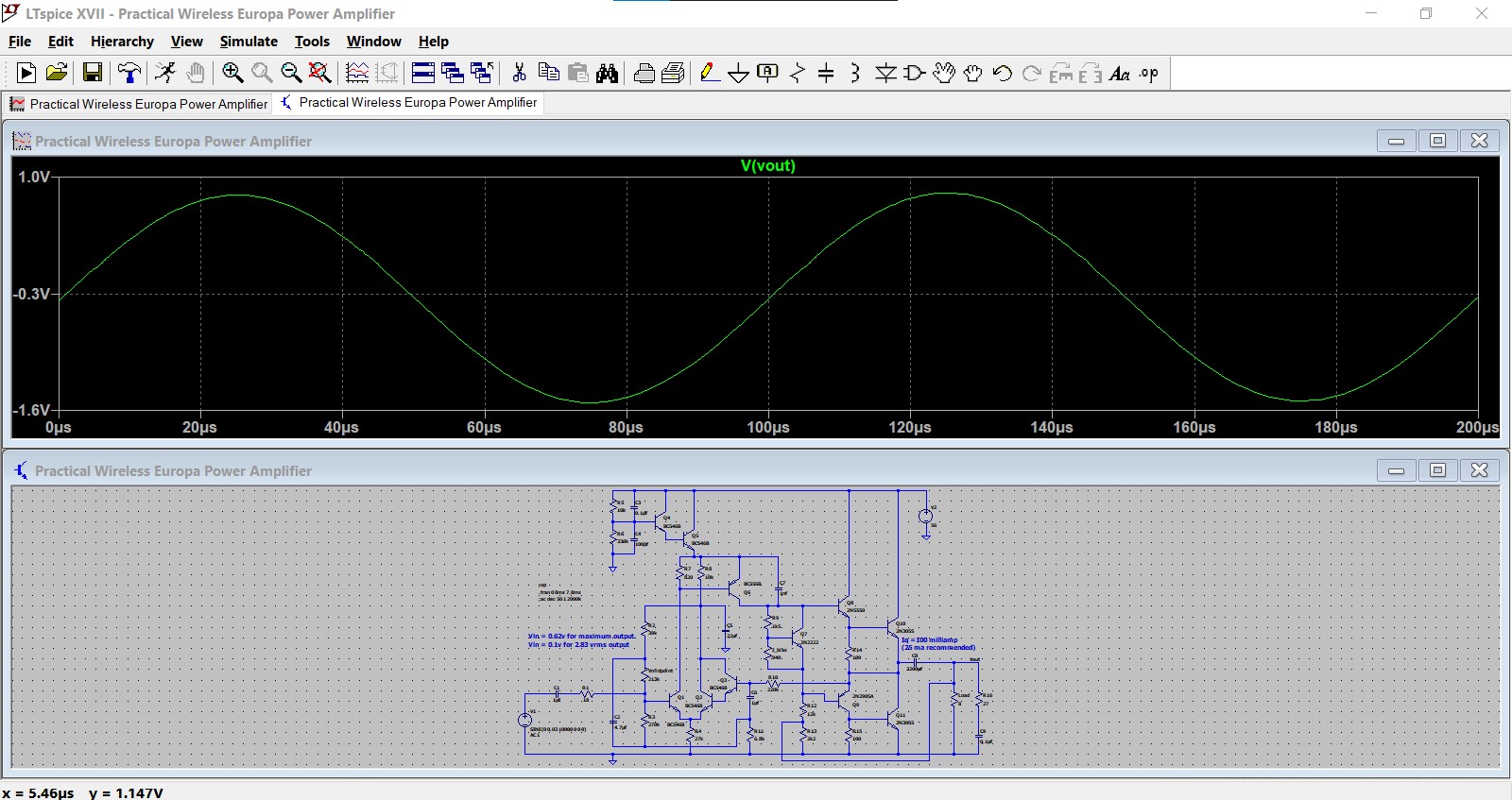

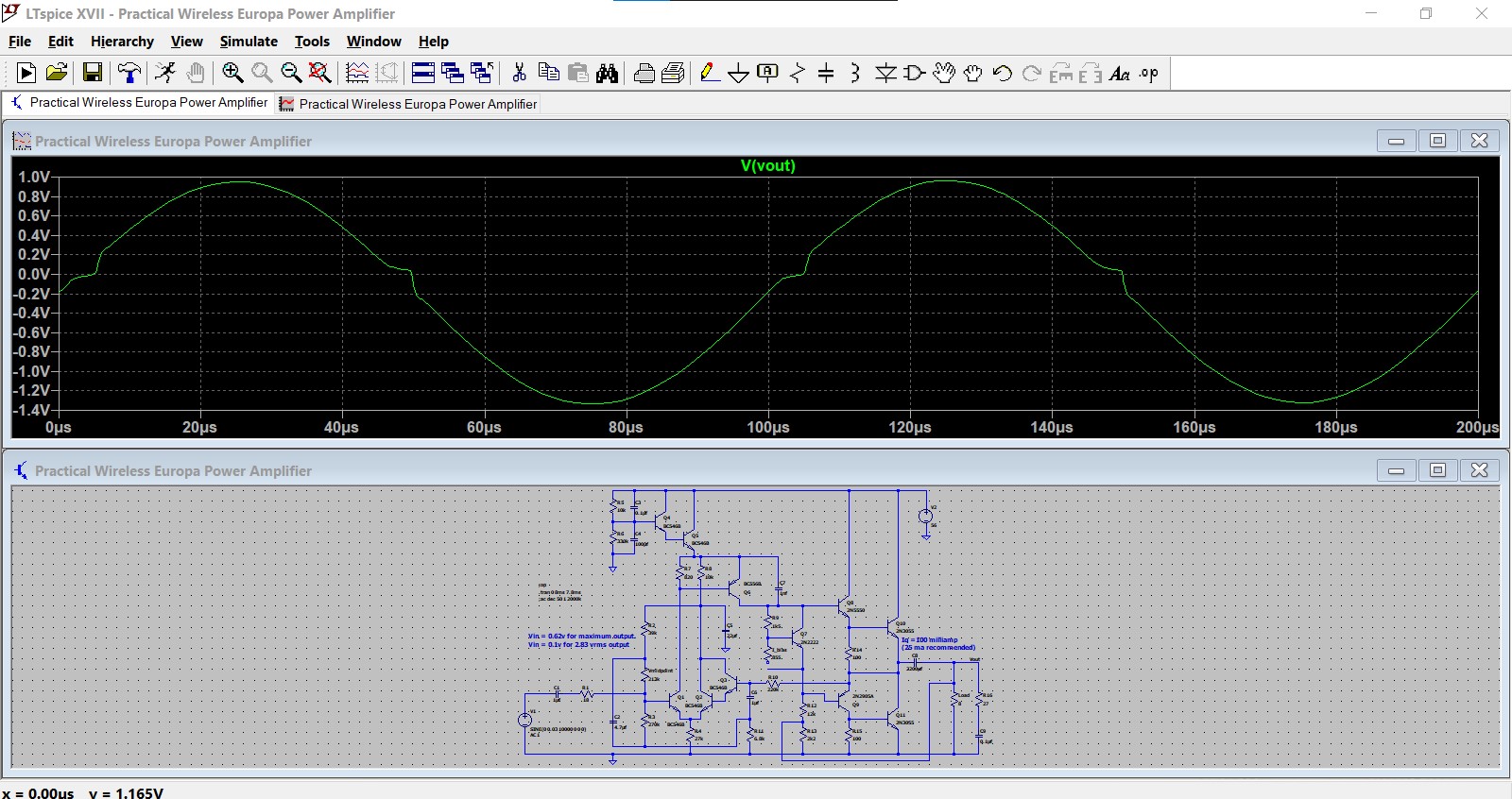

I used to find when I was playing around with this that anything over a milliamp or so rendered the distortion inaudible. Obviously that is not optimum but it is enough to remove it from audibility.
Here is a sim of a Quasi amp, first with zero bias, then 1 milliamp, then 4 milliamps. Recommended bias was around 25ma (or was it 100) from memory. This is at 10kHz.
