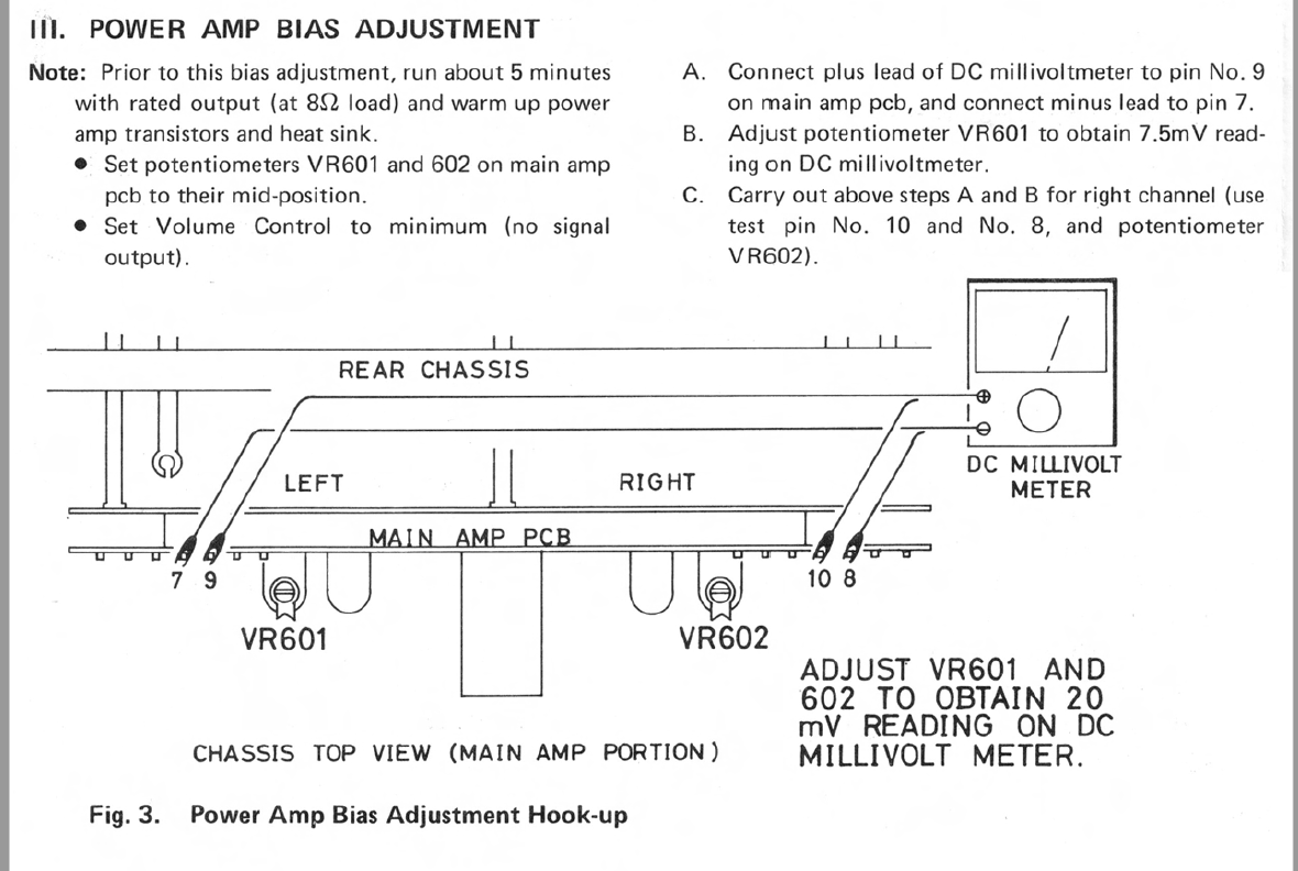

Thanks everyone, and thank you Profiguy for the fulsome explanation and background.
Amp very stable at 7.5mV, will test with cover on top prior to reassembling, but all looking good.
Thank you again.
Thank you again.
