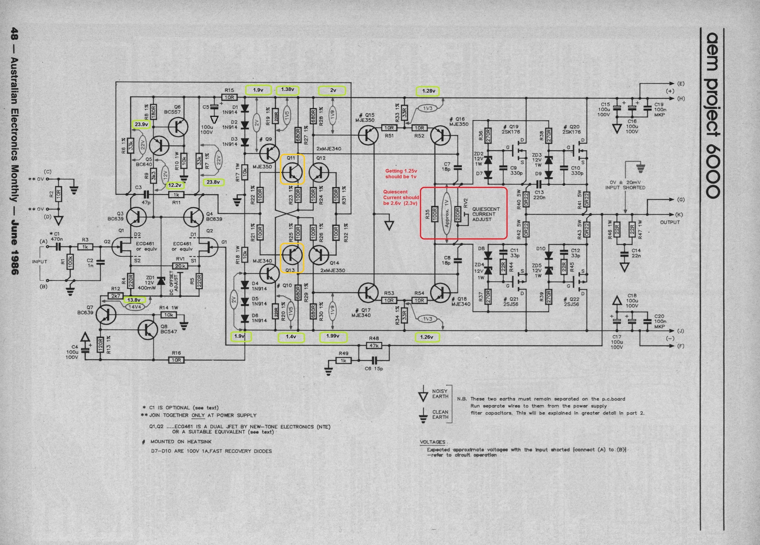

Hi Guys,
I had built the original AEM6000 (David Tilbrook) amp modules, power supplies, status monitors and surge current limiter many years ago.
I have now decided to finish this project by testing the amp modules before I install everything in its case.
On one amp module everything is good, bias current adjustment as per instructions is 2.6v across the 10ohm 5w series resistors.
However the other module can only be adjusted to 2.3v... I have changed the original 200ohm Phier trim pot with the same brand and spec - still only getting the 2.3v.
I have attached the circuit diagram with my measurements in green and maybe someone can give me some advice on what is going on.
Please note my wall voltage is around 248v AC.
Any help would be appreciated.
Peter

Hook up the amplifier, no speakers, ground the input.
What voltages do you have across R41 and R43?
(They should be 2 or 3 millivolts.)
Also watch the temperature of your output transistors ... with no signal, room temperature is the rule.
The goal is to set the amp up with as little current in the output stage as possible, in keeping with minimal distortion. Too much current and things will get hot... really hot, really fast. Not enough current and you will get a crossover notch distortion which will be audible at very low volumes.
Hi Douglas,
No speakers connected, Input grounded.
Across R41 = 19.7mv R43 = 20.8mv (Output transistors get warm after 10mins)
Good module - R41 = 27.2mv R43 22.1mv (Output transistors get warm after 10mins)
HD - Both amp modules are using identical components.. If R35 = 100R and I need to change to 120R to be able to adjust the correct Bias current - Does that mean their is something else that is a problem in the circuit?
Thank you.
Peter.

One of the reasons the voltage might not go up at that adjustment point is that the drivers it's feeding are saturated. While the idle current (approx 100ma) seems a bit high, I don't think it's a problem.

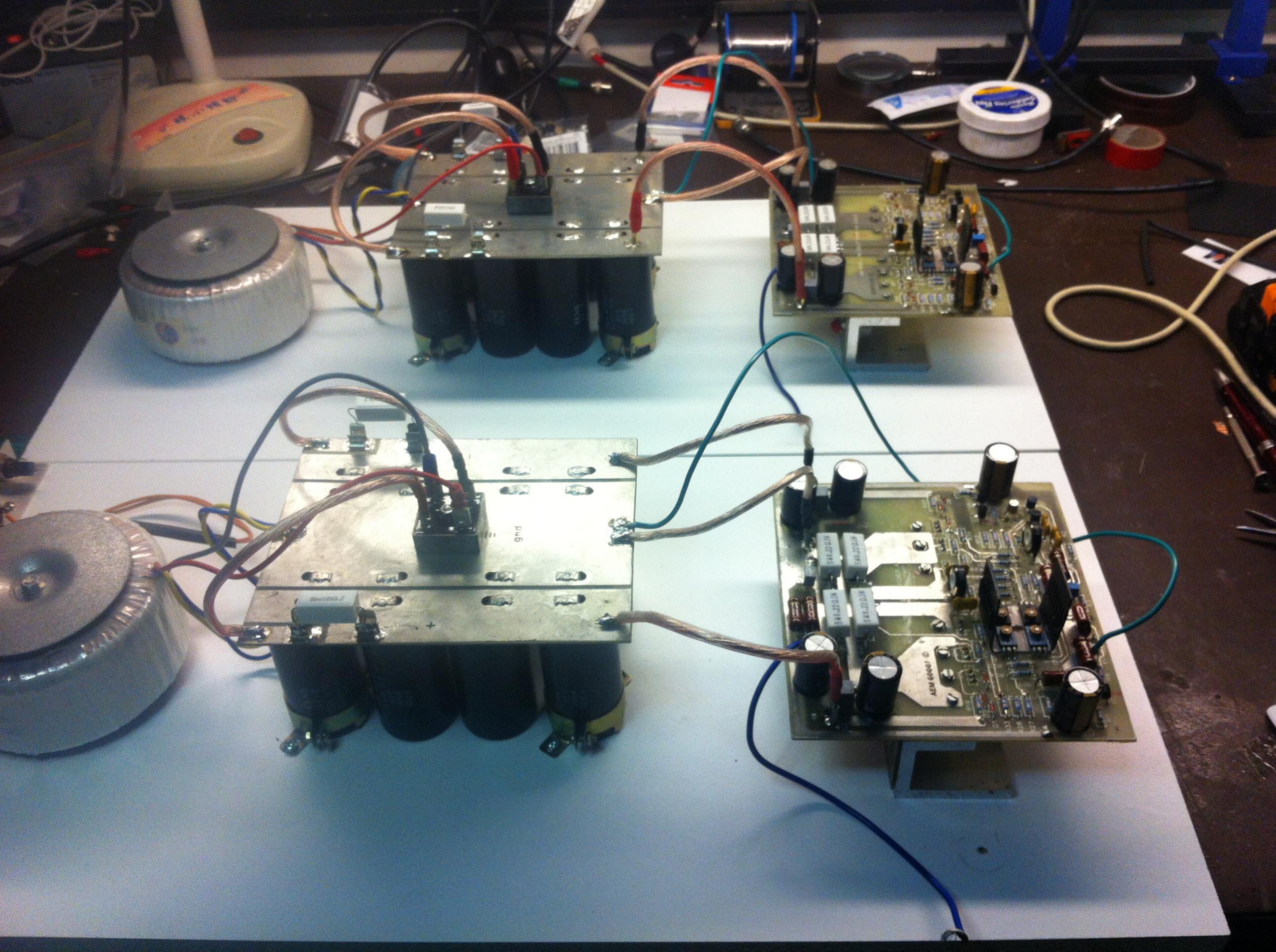

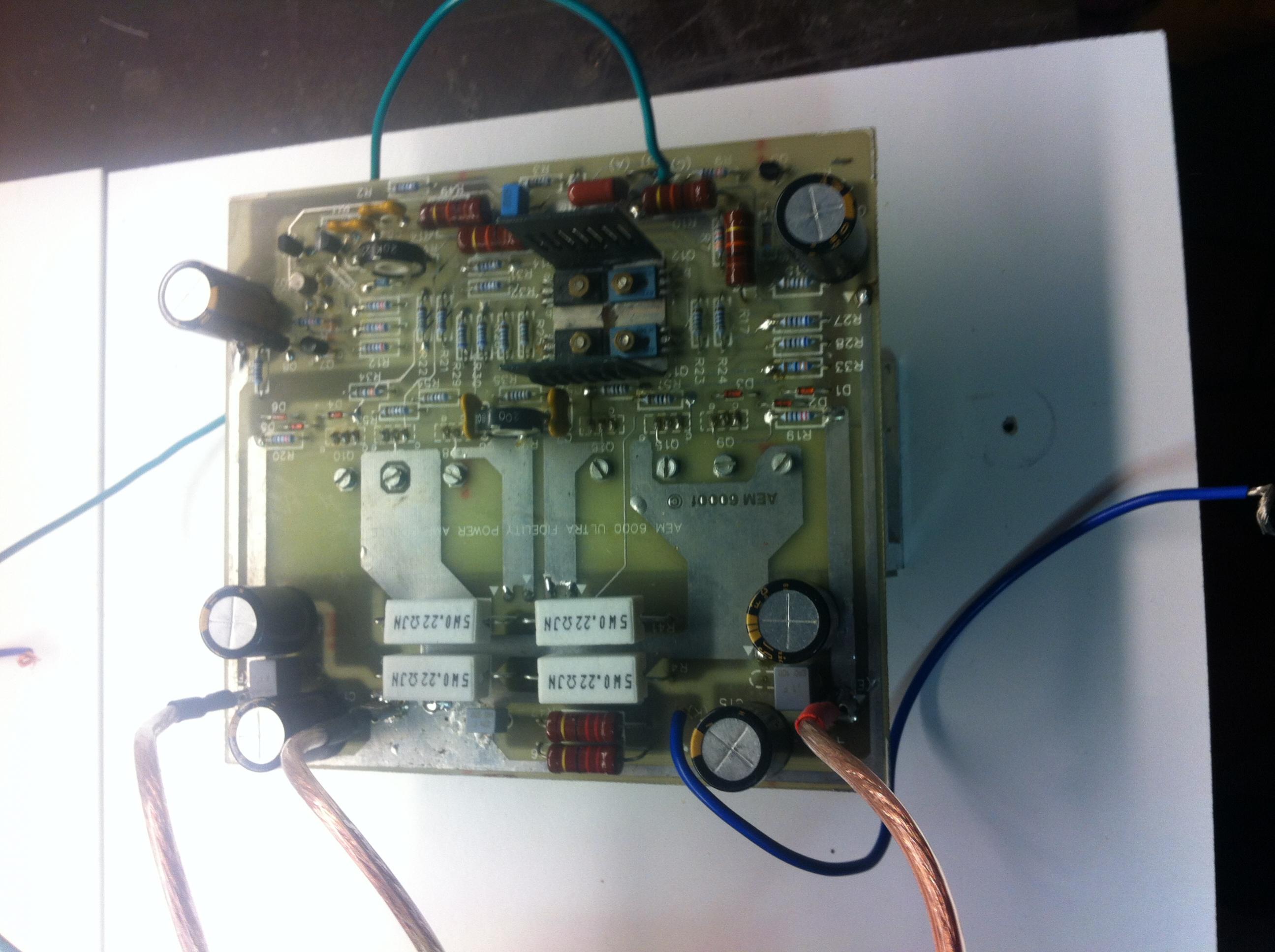

Guys,
The 120R resistor works a treat. I have now set up the bias current to 2.6v as specified for both modules and have set the dc offset to around 8.6mv for both.
Attached is a photo of my temporary test bench setup of the AEM6000 amp modules and power supplies. Now I can go ahead and start installing everything in its case.
Thank you all.
Peter.

I am happy that its all working now. I actually started building this amp back in 1986 and tried to use the best components available. Beyshlag resisters, polyproplene and mica film caps and recently added the nichicon Muse electrolytics. The four 0.22ohm 5w 5% resistors on the amp modules are non-inductive - Not sure if they will actually make any difference or not.
Sometimes life gets in the way and we go in other directions. I now have some free time and determine to complete this amp.

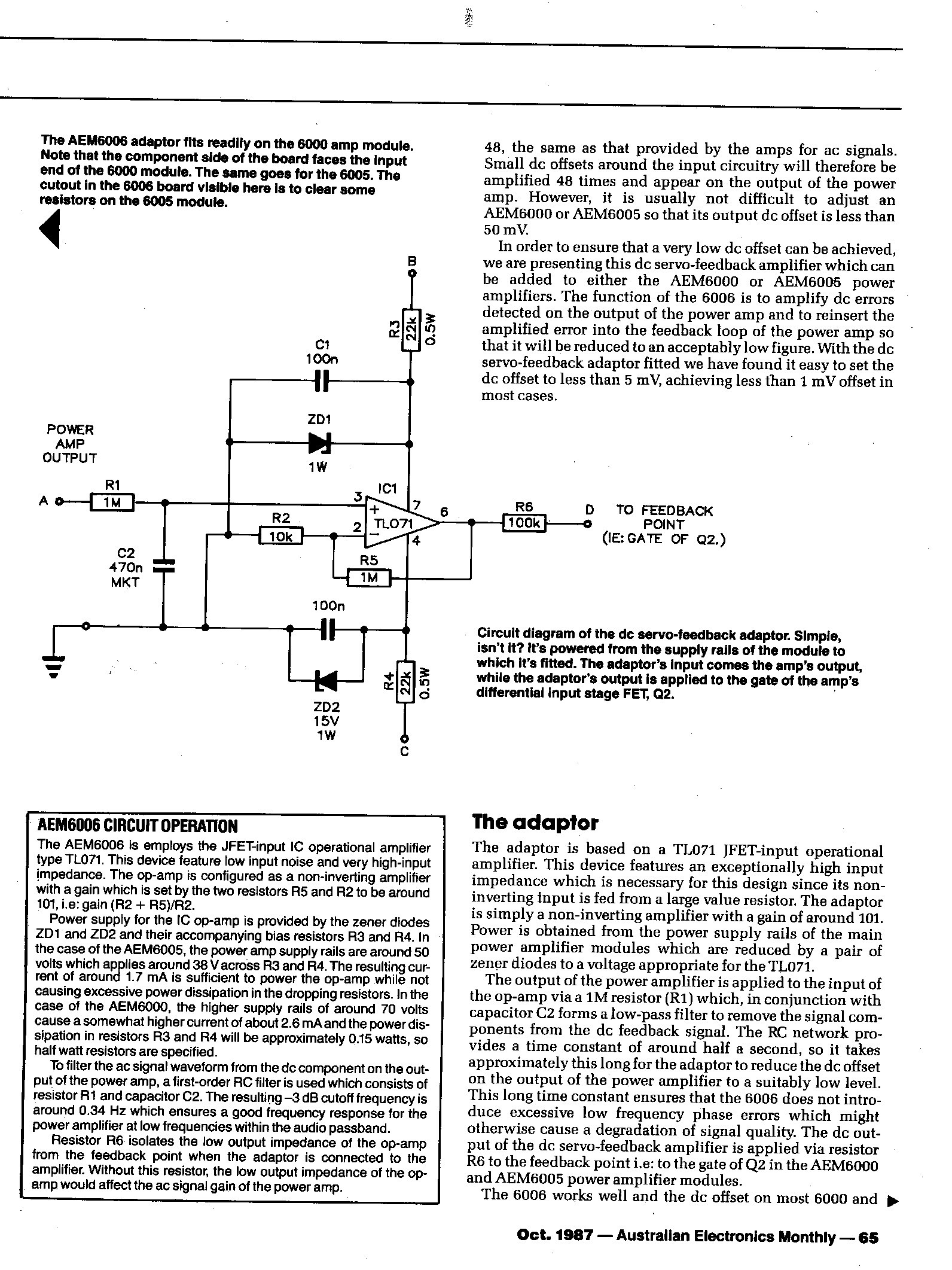

AEM 6006 DC Servo Feedback.
This board goes across near the middle of the board effectively blocking access to the central trimpot.
You will need to think about this for access for later adjustments.
I mounted the board at an angle, and also cut a notch into the edge of it to try and make it easier to get at the trimpot.
