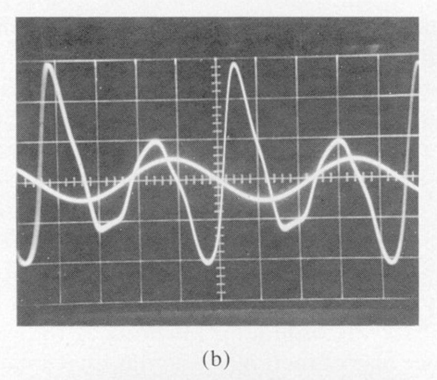

Fig. 15b (fundamental notched out) on page 13 of the mentioned PDF file shows an extrem low value of THD+N - unfortunately I note saw tooth character for the residual diatortion. Maybe this is the main reason, why such amps don't sound as good as hard running amps - go to
Pass Aleph 1.2 monoblock power amplifier Measurements | Stereophile.com
(Fig. 4).
THD-N is much more though, but only H2 sine wave character (more ear friendly distortion and thus inaudible resp inconspicuous ).
Thanks for pointing that out. Looking at it more closely, crossover residual is much worse when bottom FET turns on than when top FET turns on.

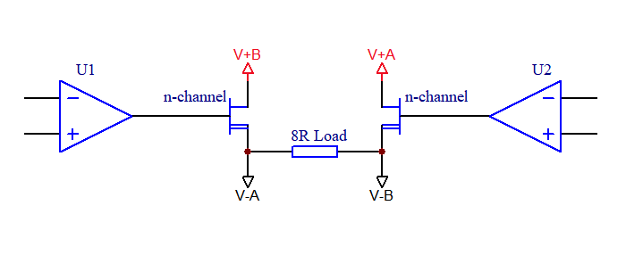

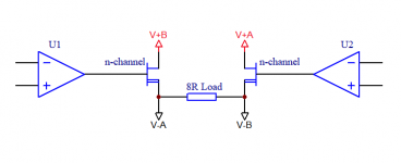

Circlotron, interesting. If I understand correctly (see attached sketch) - VA and VB are two isolated supplies lets say. For one half cycle current flows from V+B through load (speaker) to V-B. On the opposite half cycle current flows from V+A through the load to V-A.
I'm assuming feedback loop here. Advantage no hard to control bias current (DC offset) across the load. Disadvantage - where voltage across the load should be (and is) 0V two currents can flow simultaneously essentially drawing power from VA and VB supplies.
Both Mosfets remain hard to control. Control is achieved because they are fighting each other (in the feedback loop).
