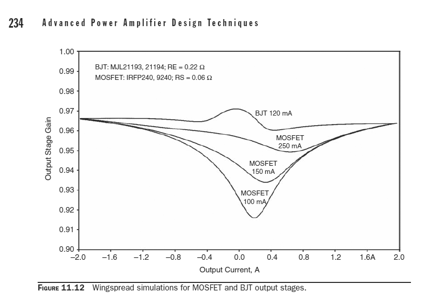

We know the wingspread plot is different due to gm doubling/droop. Makes sense there is a perceptible difference, probably most noticeable at low signal level up to ~ 1W into 8 ohm.
From Cordell's book Designing Audio Power Amplifiers:
How the hell would anyone tell the difference at 1PPM / 1 W ???
(Below).
PSRR , circuit design , grounding , yes ! silver wire , audiophile components,
or BJT /FET ..... no.
Imperceivable to terrestrial beings.
PS - "firstwatt" is where the differences are literally nothing.
100W+ or clipping - OPS becomes a "player". 1W - IPS does not care...
