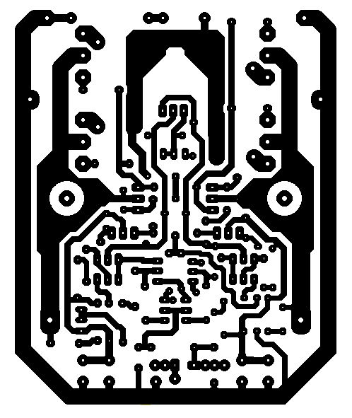

Hi Marc
If you do not mind to post your layout that would be great.
Better to use (have) some SMD parts on the layout than no layout at all.
Thank you

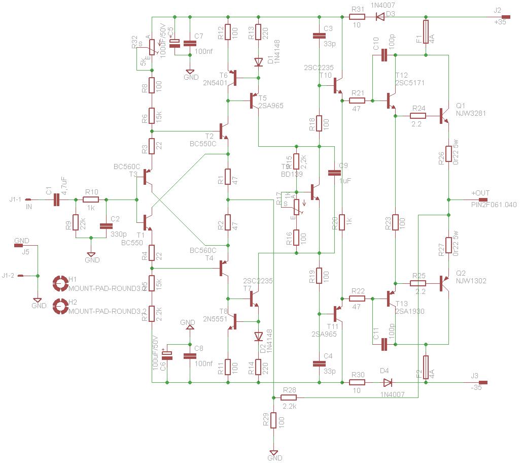

That would be more than good enough for me, anyway lets see until someone will test it or Borys will give a green light to the final schematic.
Greetings Gabor

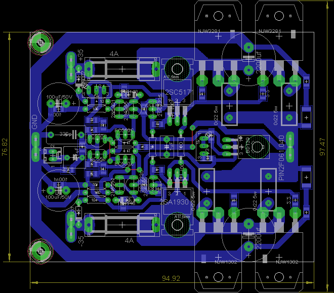

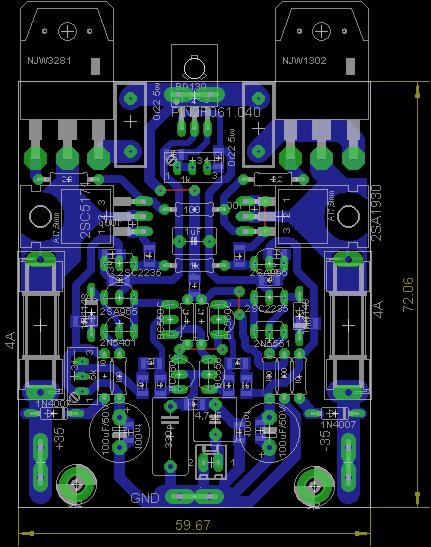

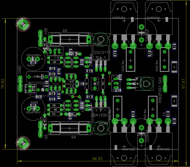

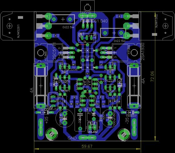

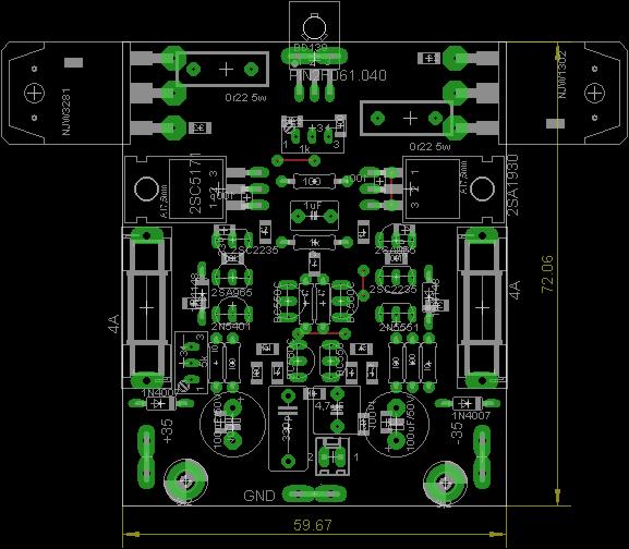

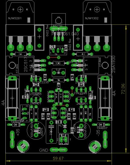

I made as usual...it's not the first time i attached a files....they don't weight more than 60ko....send me your mail through email, i follow you files...
Marc
Here are layout we talk about, i attached 2 pairs version too.
Marc

By any chance someone built these amp.
Tomorrow I go for laser printing, it would be good to know which one to build.
These or the BG-1.???
Any way I made the lay out after Marc design (thank you Marc🙂) using regular resisters, I do post it if someone interested.
To get the right size you must set up your printer to 85%.
I do not have silkscreen for these but I can help, also if you look at Mark lay out with the two pair power transistors these lay out born out of that.😀
Only mode I made I have some nice Philips Axial 1000uF 100V caps and I want to test those to next to the power BJT..
Greetings Gabor
