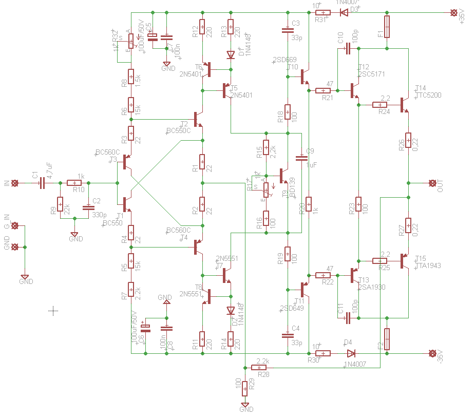

I have problem with upload too.
At the moment version v5.1 is playing in my house.
Gabor send me pm with email (I can not find your email, prapobly lost it) and I will send you schematic 5.1. Some tweeks may be required If there will be a problem with temperature (but schould be ok)

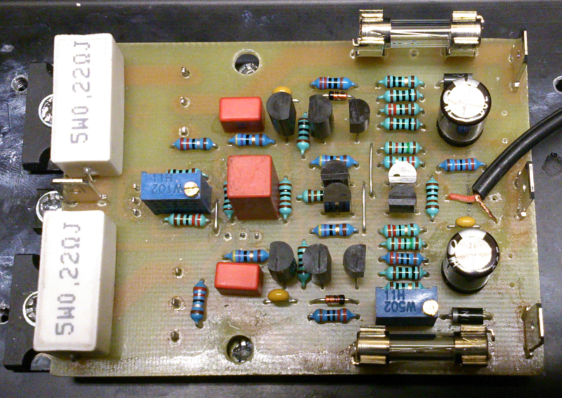

Here are layout we talk about, i attached 2 pairs version too.
Marc

Have you tried the proto. before making pcb-s, you can`t compensate temp of a triple with a simple Vbe multiplier...

Any way I made the lay out after Marc design (thank you Marc🙂) using regular resisters, I do post it if someone interested.
To get the right size you must set up your printer to 85%.
I do not have silkscreen for these but I can help, also if you look at Mark lay out with the two pair power transistors these lay out born out of that.😀
