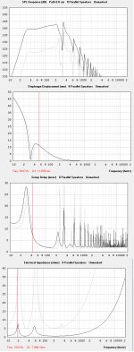

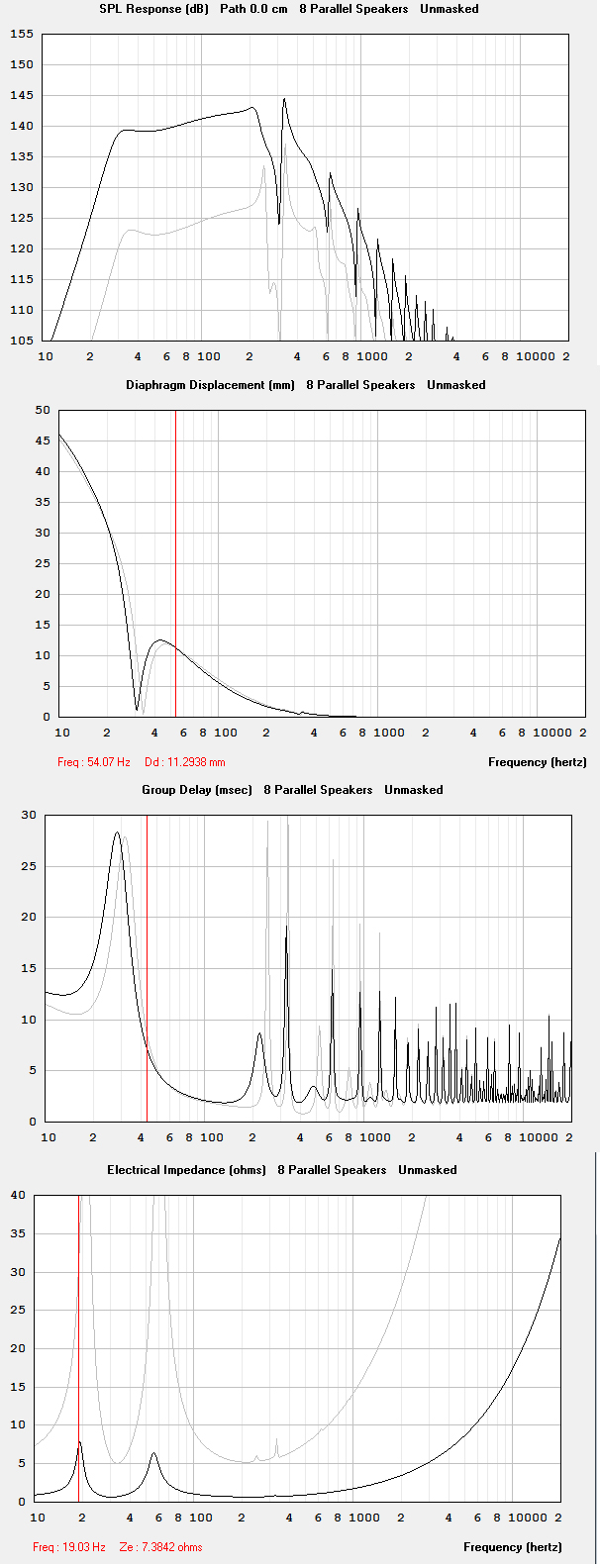

This is clearly shown by the picture I've attached, which demonstrates a shift in group delay, and impedance following use of the multiple speakers utility.
In hornresp, I have modelled multiple vented enclosures and corner loading. I have found the system tuning lowers but the displacement peak shifts down the frequency band and actually increases slightly.
I'd assume this is because the increased air load on the driver acts to increase Mms and lower Fs. Also the air in front of the ports would increase their effective length. With corner loading the front loaded and tapped horns I've modelled, corner loading REDUCES the displacement peaks, so there is that advantage to the horn cab. As for Bill Fitzmaurice, he wouldn't specify a higher voltage limit that would risk the driver bottoming out as the cab was moved out of the corner!!

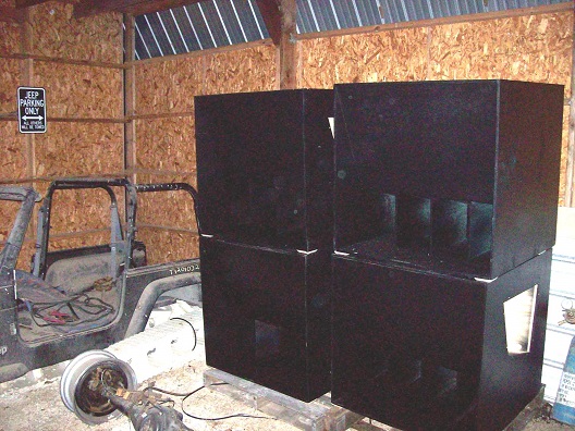

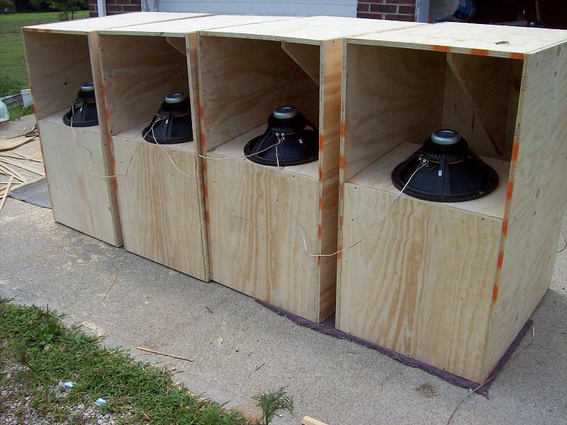

Here is my comparison.
36" T36, 27cu.ft. 95db@40hz@28v/10m
StadiumHorn, 20cu.ft, 102db@40hz@28v/10m
WITH THE EXACT SAME DRIVER... aka, the exact driver was pulled from one cabinet and put in the other. same testing hardware, an apples for apples comparison.
Lets just say the T39 isn't a monster sub either... the SS15 beats it easily.

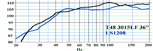

The Titan 36" wide Titan 48 has less dip, and is 102dB at 40Hz with more up top.
You can of course question if it was measured outside too if you wish 😀. Such a chart from a Tuba 36 (designed for extension to 28Hz, and to be cross firing/V coupled for the correct mouth flare) would make me suspicious, but a shorter horn and larger mouth from the Titan which (would be a 24 cu ft cab!) made me think legit graph. I mean Bill doesn't even try to hide the low sensitivity region of the Tubas anymore:
