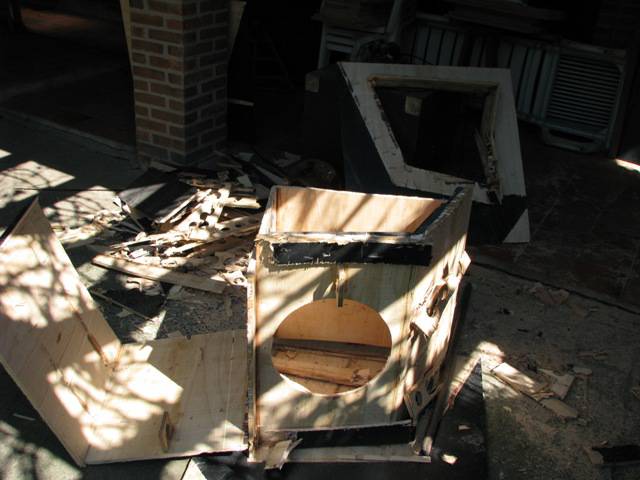

I can fill you in on the details on that one. A builder (not BF himself) built the T36, BF had just drawn up the plans only. The builder built it, and measured it INDOORS... I repeat INDOORS. BF, never measured it, never built it -- took it all as gospel, and published on his site for THREE YEARS. When customers couldn't reproduce the results expected, it was, "you got a leak, you did it wrong, you didn't follow the plans."
It wasn't till I built them, measured them over and over -- and the guilty party that measured them indoors fessed up.
For the expected reasons -- all those posts got deleted from BF's forum.

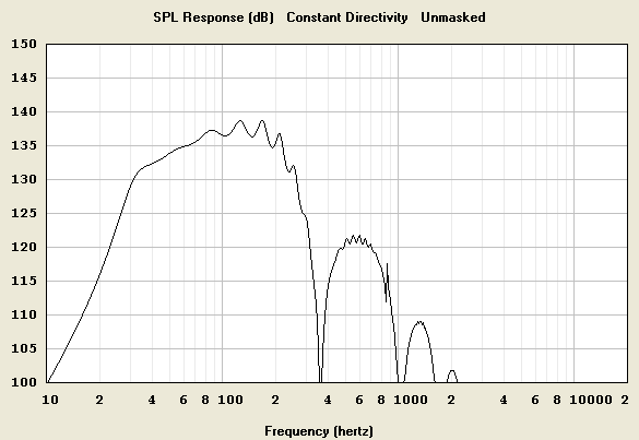

JBell I remember you posting a graph actually which was at over 100dB until 40Hz. It doesn't add up with the new Tubas (30 and 24) which are down in the lower 90s for the lower bass, unless V-Plated in pairs. At a guess, I'd expect the Tuba 36 to be down about 95dB to the upper 20s, rising into the 100s past 60-70Hz.
The only cab that has the response you were after (maximum sensitivity above 40Hz) is the WIDE (30+ inches) Titan 48. (unless that was measured indoors too 😉 ) INDOORS you'd have all sorts of cabin gain. So I do think that was unprofessional on Bill's part.

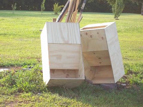

Oh, and the T36's I built, were 36" wide.....

Here is my comparison.
36" T36, 27cu.ft. 95db@40hz@28v/10m
StadiumHorn, 20cu.ft, 102db@40hz@28v/10m
WITH THE EXACT SAME DRIVER... aka, the exact driver was pulled from one cabinet and put in the other. same testing hardware, an apples for apples comparison.
Lets just say the T39 isn't a monster sub either... the SS15 beats it easily.

The Titan 36" wide Titan 48 has less dip, and is 102dB at 40Hz with more up top.
You can of course question if it was measured outside too if you wish 😀. Such a chart from a Tuba 36 (designed for extension to 28Hz, and to be cross firing/V coupled for the correct mouth flare) would make me suspicious, but a shorter horn and larger mouth from the Titan which (would be a 24 cu ft cab!) made me think legit graph. I mean Bill doesn't even try to hide the low sensitivity region of the Tubas anymore:
