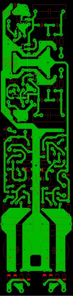

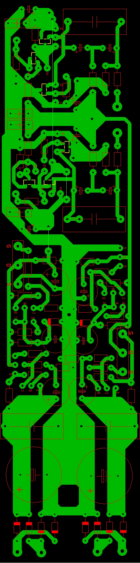

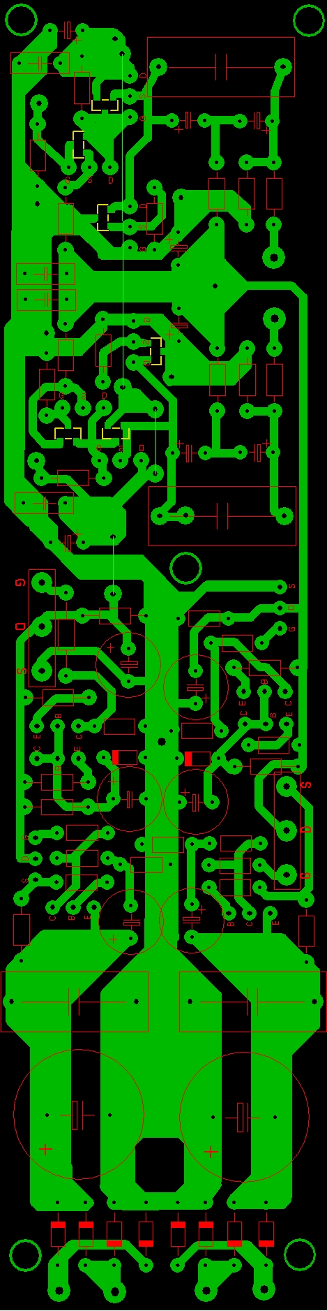

I modified Juma's original board to accept SMD or through hole options for the BF862. Will someone with a trained eye please review the board and let me know if revisions are necessary.
If this board passes the QA of the forum and with Juma's permission I may do a small proto GB. Please let me know if you are interested and I can check pricing for a limited run.
Thanks, Nick
