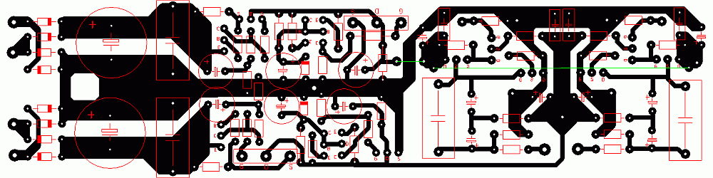

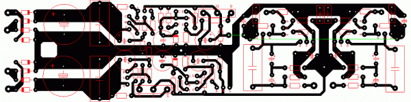

In the meantime I added shunt regs (fellow member Salas published this reg) to the preamp, so final schematic now looks like this:
PCB looks like this (picture shows bottom view, dimensions are 16cm x 4cm):
Note: This PCB does not contain prereg (7915) in negative shunt reg as well as pi filter after 7915. I used that prereg just because my transformer had too high voltage (15V AC). 9V AC is OK.

i am curious to know if you ever thought about using an emitter follower buffered reference to supply the negative voltage for the first bf862 and parallel a couple of nice, large value film caps instead of series electrolytics for the output.
to me, that's a lot of negative regulator for the purpose it's serving ...
again, not complaining, just curious ...

Thanks mlloyd!
- output coupling can be solved in many different ways (film caps, dc servo...). The solution shown is my preference (anti-serial elkos with negative polarization in the middle, bypassed with stacked foil cap) because it sounds most neutral to me (those elkos are nice rubycon caps)
- negative rail is actually crucial because just the first JFET is preamplifier (the other two are variation of Nelson's B1) and it has almost no PSRR. Anything bad from negative rail will not be just present in output signal but also amplified. Positive shunt I added just for good measure 😉
Now I see that I made a big MISTAKE in the last schematic drawing - R17 (in the Source of Q2) should be 10-15R, not 1k

Well, then this should be the circuit in accordance with the PCB?

Well, then this should be the circuit in accordance with the PCB?....
Thanks Giuseppe,
yes that's the circuit - there's an error on the sch. - C14 (in the +V shunt) is the wrong way around but it's OK on the PCB.
Thanks Giuseppe,
