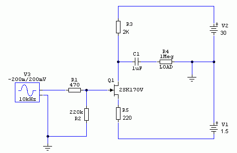

Hi, I'm using the attached schematics (momentarily) as I need 17dB gain. I will try with BF862 as I get my hands on them. Using 16mA IDSS SK170V the THD is ~0.07% (according to the sim) but I will measure it today with RMAA.
I use this preamp after a passive I/V converted AD1865 DAC and I like the sound of the whole very much. I tried it yesterday evening so I'm too biased now 🙂
I have two questions:
1. using the reg schematics from post #84 with R1 = 12R, the shunt mosfet IRF610, even with a small heatsink, is pretty warm after only 5 minutes (I can keep my hand on it but it's warm, ~45-50C). It's feeding only two SK170V biased at 8mA so the consumption is max 20mA.
Should I increase the value of R1 12R or should I use a bigger heatsink?
2. for the negative supply I'm using a 1.5V battery now but I don't want to bother with batteries. Can I set the negative reg to 5.5V and use two 2V leds in series to drop the voltage to 1.5V? Can I try this or I will experience smoke?
Thanks!

Vzs,
1. If your input voltage for neg. reg. is 35V (as in sch. in post #84) that's the cause of big thermal dissipation. If so, use a pre-reg. to redistribute the heat (7915 or 7912 or CRC Pi-filter 100uF - 330R/2W - 100uF) before the shunt reg. R1 of 12R gives you CCS current of about 50ma - don't increase the value of that resistor (15R max.)
2. Yes, it will work, just use a nice cap of 1000uF or so after the LEDs. Try different LEDs to achieve exact voltage.

Sorry for misunderstanding... currently only the positive reg is working and with that I have the heat issue. I use 24V AC in, and have ~34V before reg and set 30V after reg. I use 10K multiturn instead of zenner so I can set any voltage. As the consumption is ~20mA probably that dropped 30mA is generating the heat?Vzs,
For the negative supply I use 1.5V battery now.
0.9W (30Vx30mA) is nothing to worry about. Use the scope to check for oscillations in the shunt reg. and if everything is fine just put a bit bigger heatsink on the IRF610 and you'll be fine 😉
OTOH, just 4V difference (34V before the reg.) might not be enough for shunt reg to work properly. Try setting the output voltage to 28V. It won't change anything important in the preamp, but it will give some headroom to shunt reg.
I set the positive output voltage to 28V and added an 1.56K resistor to "eat" 18mA from the IRF610 so now its warm but even after an hour of work is ~45C. Thanks!0.9W (30Vx30mA) is nothing to worry about. Use the scope to check for oscillations in the shunt reg. and if everything is fine just put a bit bigger heatsink on the IRF610 and you'll be fine 😉

Why?I..... added a 1.56K resistor to "eat" 18mA from the IRF610
What does it do to improve performance? What effect does it have on output capability? What does it do to device parameters that vary with temperature?
Schematic of what you have done would help us understand.
