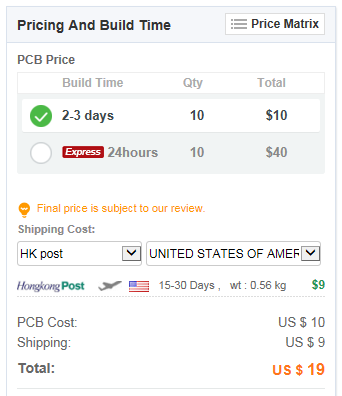

Last time I used HK Post it was $11 to US. $9 is an new lower price?
Attached is what I got from their online portal, assuming a PCB dimension of 60mm x 30mm.
Be aware that shipping cost is linked to the size (weight) of the PCB, cost would be USD15 for ten 100mm x 100mm PCBs.

If you're interested in that amp, why don't you just ask for the Gerbers and then order PCB from PCBway yourself, just USD19 for 10 PCBs including shipping (from China) to the US.
Or order from OSH Park, USD13 for 3 PCBs before shipping, it's US based so shipping within US won't be expensive.
With some PCB houses in China, you can print 20 such PCBs for USD7.5 (so 37.5 cents each), before shipping.
Wow that is cheap. I figured that a group buy would be an even better deal, and I like the idea of somebody more knowledgeable than myself passing along the circuit design to the printer, since I know zilch about the process or the specs involved with ordering. Is it pretty foolproof?

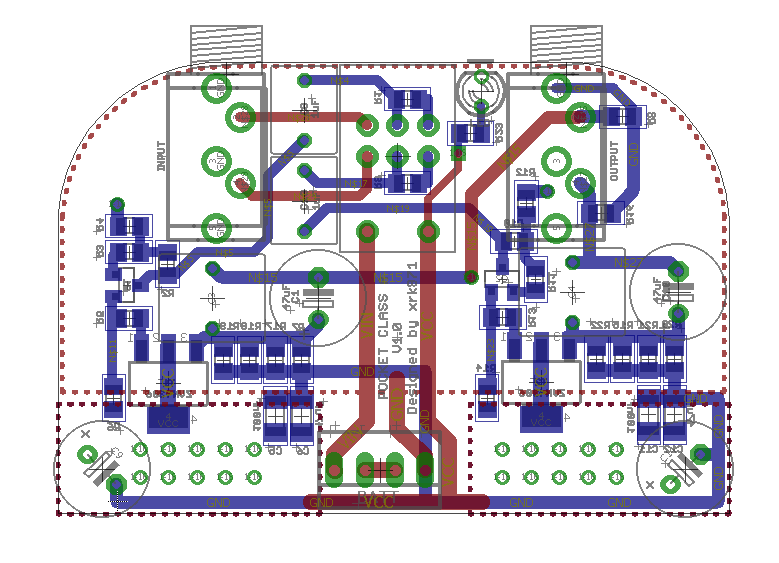

I have double checked the SMT version made by BDHM and it looks good. We can proceed to a GB now for the SMT version. Perhaps BDHM can give us a status on the through hole version?
Pocket Class A Headamp GB
Ok folks, for the Pocket Class A Headamp GB, if you are interested, please quote this post and add your name. When I get at least 5 people with 2 units ea or 10 people with 1 unit ea, etc. (minimum 10 boards), I will place the order for the boards.
My pricing is the usual to cover shipping and nominal costs of fab and hassle of conducting a GB. Put it this way, I am not getting rich off of it 🙂
$17 for 1 board outside of continental US (CONUS). $12 for one board within CONUS.
If you want two boards, add $5 so $23 or $17 for two boards outside CONUS, and inside CONUS, respectively.
In case you are wondering what the BOM will cost, between $20 and $30 depending on your choice of components. Not including batteries or Altoids tin.
Would anyone be interested in a fully-built and tested unit, with same SE Class A topology and fits in an Altoids tin, but has added feature of turn-on delay protection relay, and uses top of the line components (WIMA, Panasonic OSCON, Alps, etc.)? Pricing is TBD based on interest.
591358d1484063759-bf862-based-se-class-headamp-without-heat-pocket-class-bf862-zvn5306-ha-v1-new-oscons.jpg
Board will look like this:
594826d1485450543-bf862-based-se-class-headamp-without-heat-pocket-class-gb-layout.png
It's SMT on one side and through hole on the other side. The SMT's are 0805 - easy to hand solder - don't worry about it. 🙂
Many thanks to BDHM fot the layout and Agdr for the baseline Altoids tin footprint and pot/jacks/LED Eagle files. Could not have gotten this far without you guys.
Pretty much ready to go 😀
Oooooh :yes:
The SMT caps are 1206, so even easier.
An absolute pleasure! And likewise, big thanks to Agdr.
