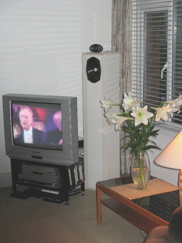

This is something similar which I am doing myself at the moment. 6x9 drivers in front and back for bipole. Folded line between drivers is 8ft long. External = 10" wide by 9" deep by 52" high.
Dowel rod now either edge of both front and rear panels, like a rounded baffle edge; this does make a difference with mid peaks if you take them away.
Lots of holes now drilled in sides behind the front driver (only) to make the front driver semi-OB whilst simultaneously venting the line.
Both the drivers and the vent have phase matched output at 32Hz, with respectable output down to 25Hz, esp with room gain.
Work continuing, but high WAF and good sound so a definite keeper.
