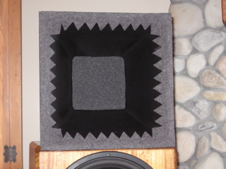

Glad to see you guys here. Hope I'm not to OT, but I had to take the opportunity to ask.
Background: I have a set of Nick's Unity horns and the tweeter is the TAD 2001. I found that Earl's foam treatment does improve the highs and eliminates any slight "horn" character. I had filled the entire horn with the foam - all the way to the phase plug of the tweeter, but with the front half removed, it seems to do just as well - I don't think I can hear a difference. As the picture shows, I'm also playing with some thick wool felt at the exit. Seems to add a touch of clarity to the highs (but could be my imagination too).
I'm interested in your comments regarding the transition from the tweeter to horn, especially for the BMS driver you are using. The TAD, of course has a much deeper throat and a narrow taper. Nick made somewhat of a transition zone, and I worked it a little more to get as smooth and gradual a transition as possible in the short distance available. I'm wondering; since the BMS would seem to avoid the steep transition, whether it wouldn't be the best choice here? The shorter throat has another seeming advantage. Right now, I'm using a DEQX, which can digitally align the drivers. At some point, I want to try analog crossovers again and get the phase worked out at the crossover point. The longer throat of the TAD would seem to make the timing issue more difficult. I'd appreciate your thoughts.

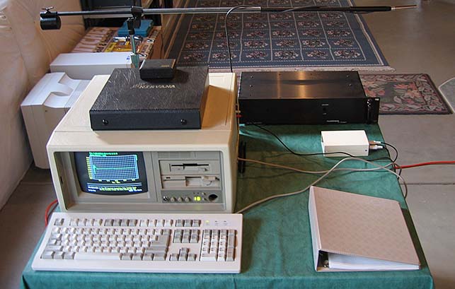

Well, I'm making progress. Today I was able to use my cane to go up 8 steps, then down again (going upstairs, that is). This is the first time I've walked up the stairs since January 7th, so that's a good sign. In a few days time I may be strong enough to go up and down the entire flight of stairs, including the landing with its 180-degree turn and a step in the middle.
From the time of about mid-February to the present I crawl down on the floor, rotate around and sit on my butt, hoist myself up by my arms step by step (hard work!), scoot around the 180-degree landing, go up some more stairs, then haul myself back up onto the walker. I do this several times a day, since I sleep upstairs and watch TV, read books, socialize, and eat downstairs. (The first month of living downstairs and sponge baths was not much fun.)
The basement stairs unfortunately have neither carpeting nor railing, both a prerequisite at this stage of mobiliity. But as mentioned above, things are getting better day by day. I'm hoping by the time of the RMAF to have a pair of test baffles, made a set of measurements of driver candidates, and done some preliminary auditions.
The gear you see in the picture (taken last December) has been patiently awaiting my return - the MLSSA/DOS computer on the left, the CC-2 power amp on the right, and the 1/2" ACO Pacific microphone and low-diffraction stand assembly at the top of picture. The WinXP dual Athlon HTPC with its M-Audio 192/24 soundcard will join it after I buy and install SoundEasy.
My hifi pal Thom Mackris has a woodworker friend in Lyons, Colorado who I hope to use to build the first set of test baffles - interchangeable 12" and 8" mounts with appropriate recessing, etc.
With any luck this stuff will fit into the rear area of my Subaru Outback - 4WD and reasonable ground clearance is a necessity here in Colorado, since the weather here is so unpredictable and potentially dangerous. Nothing like the soft and gentle rain (and winter gloom) of the Pacific Northwest or Northern Europe.
