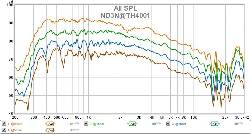

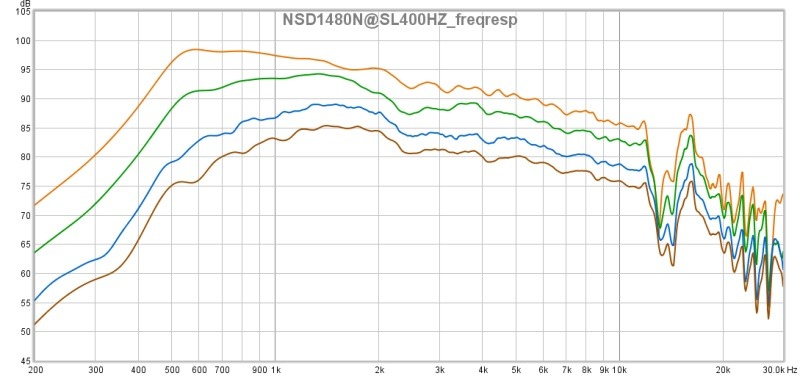

Maybe you remember the results I posted some years ago in a small circle. The 18s 1480A/N drivers seem to be very nice but they all have a deep hole above 12k. The following results are on a comparable round horn SL400HZ:
These drivers are an older design and there might be issues with the phase plug. The data on their web page does not show the truth about this driver.
What I recommend is to use The ND3 series, especially the ND3N or ND3SN drivers. Of course, there is Be version which is expensive but diaphragms are exchangeable to each other so there is an upgrade option.

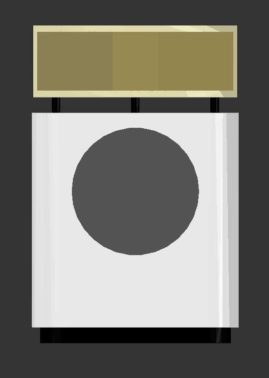

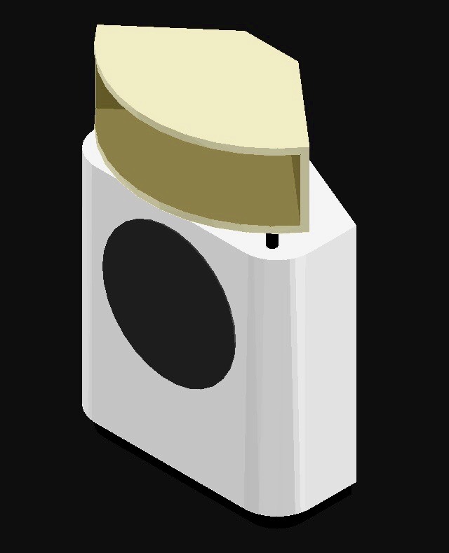

The 3.9 cubic foot/110 liter (closed box) bass cabinet for the GPA 416 is shown below, with 4" radii on the left and right edges. This is a minor variant of Gary Dahl's 3.5 cubic foot boxes for his GPA 416's.

As you can see from the drawing, the 3.9 cubic foot/110 liter bass enclosure is intended as a visual complement to either horn. An alternate vented cabinet would be the same width, 26 inches, but the depth and height would increase to accommodate a 7 cubic foot/200 liter cabinet. Bigger and more visually dominant.
Thom reported from his visit to Gary Dahl that the closed-box 416 didn't really need a subwoofer, so I did some sims, and sure enough, no problem when you account for room lift effects. Although the extra half-octave of a vented cabinet is welcome, the additional excursion below 30 Hz is not, particularly considering the 416 has an underhung voice coil and is not designed for long excursions (unlike a JBL 2235). And I already have a REL subwoofer for the home theater system.

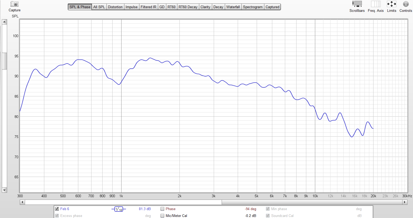

I can confirm your comments so far as the Yuichi A-290 is concerned. I am running a pair with Radian NEO950PB-16 and have to equalize out a rather pronounced notch at 1kHz. (I do this by squashing the peaks either side of the notch, on the right is diaphragm mass resonance, not sure what the cause is to the LF side of the notch.)
Most modern drivers and this horn are not the best match in my very limited experience. This measurement is 300Hz - 20kHz without any EQ, system is active and the driver has a dedicated amplifier channel.
