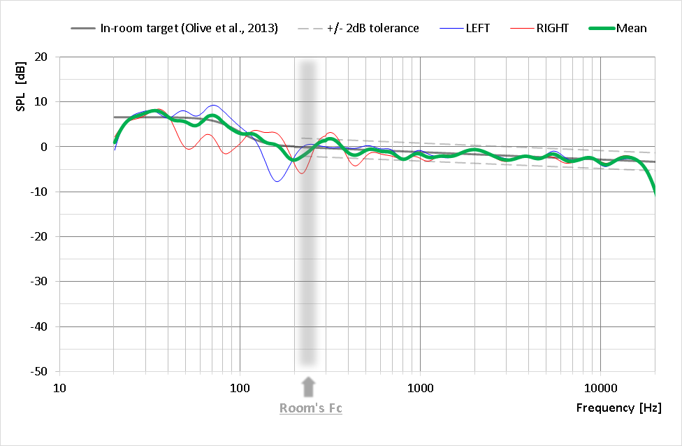

All done!
Here's the finished 'speaker:
And its passive crossover:
The in-room response conforms to the "preferred target" according to Olive et al. (2013):

I see, you are prolly using two of these loudspeakers in a common stereo setup. But in that case the following amplitude response plot
is wrong for monophonic content. The plot should show a comb-filter, no matter how flat a single loudspeaker may plot.
Uli
Right - but my intention with the green line was to show that the "average" trend, discounting the differences due to the asymmetrical placement with respect to the side walls, closely matched the Olive et al. target.
Also, when summing sound power outputs one should keep in mind that dB = 10*log(Power). Hence, the Power values should be summed, and then if desired a new dB value computed (the individual dB values cannot be added together to derive a "mean value"!)
Uli
Sorry, but I don't get this. If I play two identical loudspeakers spaced apart with a mono signal (same to both speakers) and measure directly between them I will see comb filtering? Why would that be?
You would have to be precisely an equal distance between the two, but that's doable. I've done it and no comb filtering.
I agree completely with Dr. Geddes. Back at my time at Audionics, we measured amplitude and phase-match between production pairs of speakers by flipping one of them out-of-phase, and looking for a 20 dB (or better) null across the working bandwidth of the speakers. If we had a bad driver or crossover component, you couldn't get a null, and it was flagged for repair or rebuild.
Naturally, when the one speaker of the pair was returned to normal in-phase operation, response was summed and quite smooth (provided the microphone was precisely centered and crossovers were working correctly).
P.S. This production test was done with an old Altec 1/3 octave realtime analyzer, a calibrated pink-noise source, and a B&K calibrated microphone in a quiet part of the factory. It made sure the customers always received speakers with flat response and accurate pair-matching.
P.P.S. There was a time when the production workers dropped the B&K one time too many and it quit working. We sent it back for servicing, and while it was gone, mooched various studio microphones like the expensive Sony condenser mike and assorted others. None of them worked; they were ripply and all over the place on the absolutely critical 1~10 kHz range. So the production line stayed closed until we got the "real" microphone expedited-shipping back to us. I was kind of surprised the $1000 professional studio mikes were as bad as they were; completely unusable for speaker testing (this was before cheap electrets were on the market).

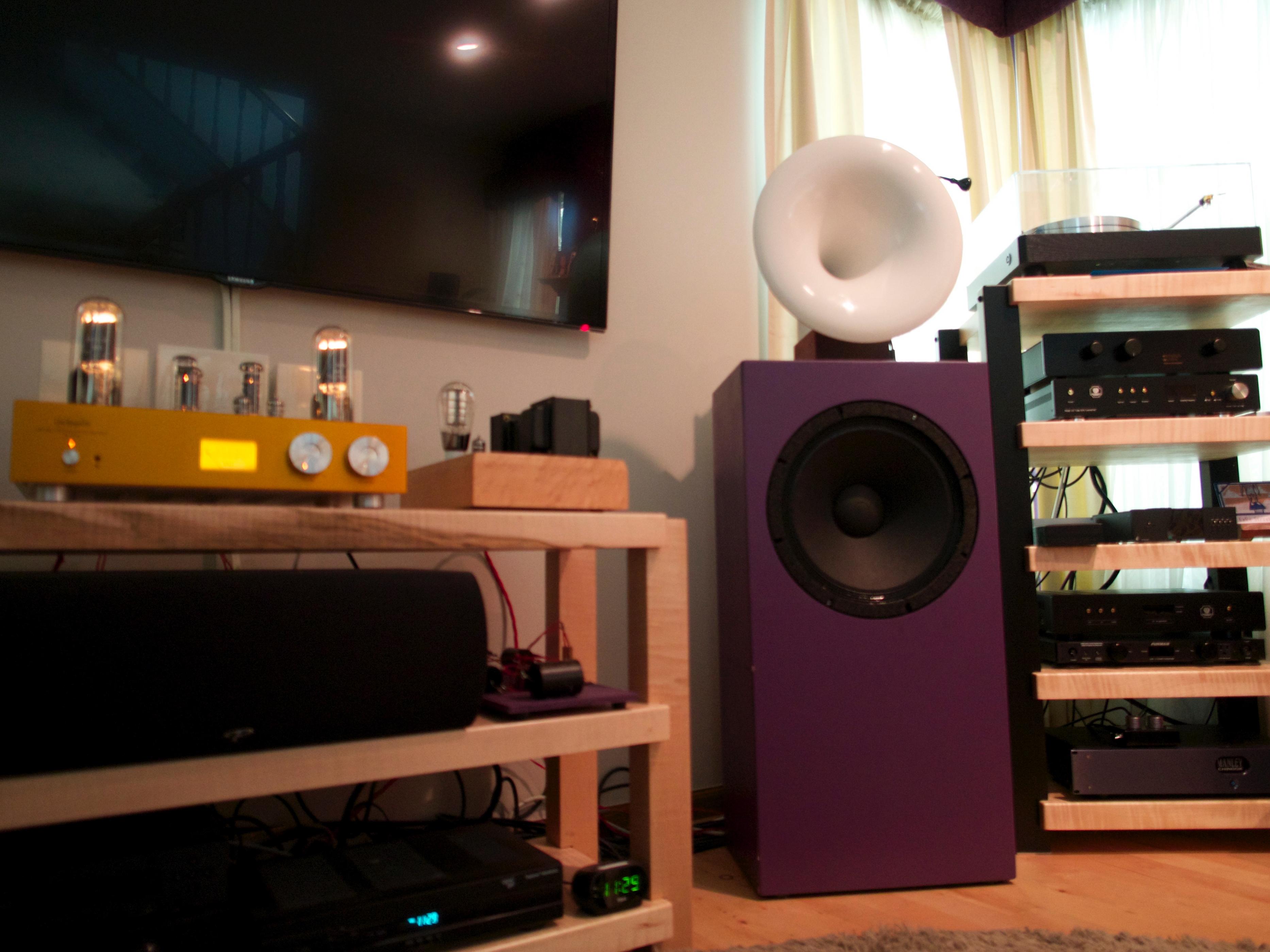

It's been a long time. I built your design using the GPA 416 alnico , Radian 745neo BR , and (2) Rythmik subs. I originally built the posted crossover and later with Dave Slagel's measurement assistance went to a 2nd order low pass and first order high pass( Jupiter copper foil) with a Slagel autoformer (-18 db at 700 hz )I'm very happy with the speakers and the synergy with the Line Magnetic 518 ,845 amp . I primarily listen to vinyl. However, when going digital I'm still using the NM 24 with Mundorf Silver Oil caps, Amprex tubes and the Monarchy AC regenerator as suggested by Mr. Poon.
Thanks again to You and Gary and all others that helped create this excellent speaker. 🙂

Hi Greg,
That's a cool purple (?) 416 enclosure :up:.. I like it. Is it sealed, br, or mltl? Did you use some EQ on the Radians? Thanks..
I had to try a bazillion iterations of crossover prototypes to get the 745neo and azurahorn to work well and similarly settled on a single small cap with lpad crossed to a 10" midwoofer with a coil and cap crossed pretty high. But I like it and after a couple of decades of relentless tinkering it's pretty much an end game system for me.
