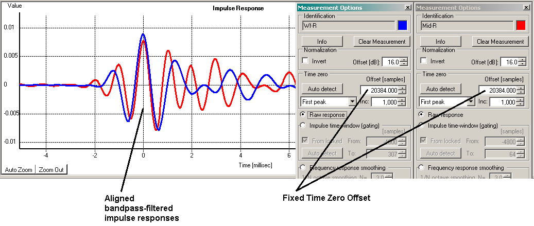

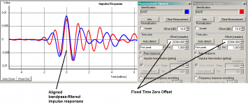

I use this techique all the time, HolmImpulse is really a perfect real-time tool for that.
I usually set the HP freq to 0.5*f and LP to 2*f and also scale transition width so a neatly enveloped burst develops which is both narrow-band enough and still has transient properties, plus it is linear-phase.
Easy to see with this filtering that with clean 0deg interphase XO's the envelopes do match in their shape and center-of-gravity points ("transient" alignment), as do the phases which affords a perfectly forward pointing lobing and a scalar (=maximum efficiency) SPL addition (on axis, at least). Both bursts almost look identical except for level, at all frequencies.
As for the actual filters needed for the drivers, it's more important to get the acoustical phases right to their targets than having perfectly smooth amplitude responses as long as it all sums correctly.
Very well said!
Here's one such measurement that I made a while back while working on the passive crossover for my own system.
EDIT: I still find some derivates of those "quasi-optimal" crossover functions often better sounding overall (thanks for your excellent input in that thread, btw).
Thanks 🙂
