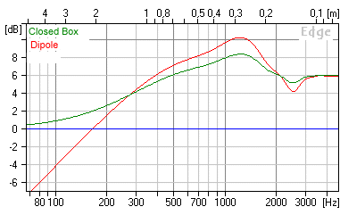

john k,
complete cancellation in the baffle plane has never been questioned.
But what about diffraction results in the listening axis? In his explanation of OB diffraction SL comes to the conclusion:
"You might say this is a much stronger diffraction effect than for the closed box - and you are correct - but it is also the characteristic response of an open baffle, dipole source - after equalization."
May be it´s just a matter of different naming. So would you call the simulated SPL differences (see diagram) between an open baffle (red) and a closed box baffle of the same size (green) as diffraction effects? Or what else?
And what about the obvious contradiction between dipole and bipole reaction? If opposite phase in front and rear lead to perfect cancellation of diffraction, shouldn´t equal phase in front and rear lead to maximal diffraction?
Rudolf

Rudolf said:
john k,
Rudolf
I have to run out but I'll have more comments later. Basically SL is just making a comparison between the two observed response curves. It is not possible to separate out diffraction fromt dipole summation (or bipole sumation) from looking at the frequency reponse. The Edge and any baffle sim code, mine too, yield the result of the summation of the primary waves and the diffraction sources from around the baffle edge. Looking at what they yield doesn't necessarily identify diffraction.
