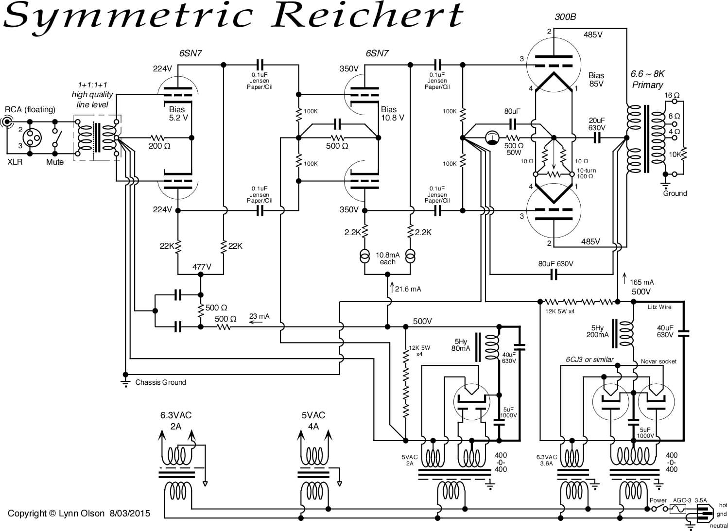

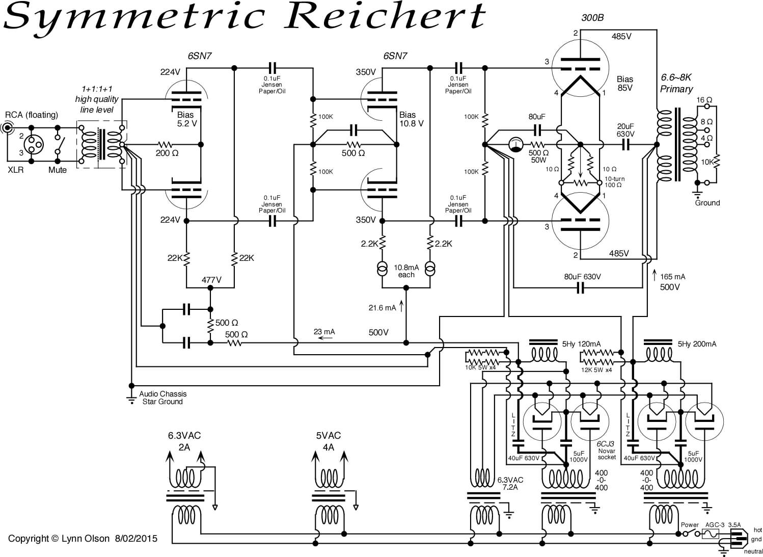

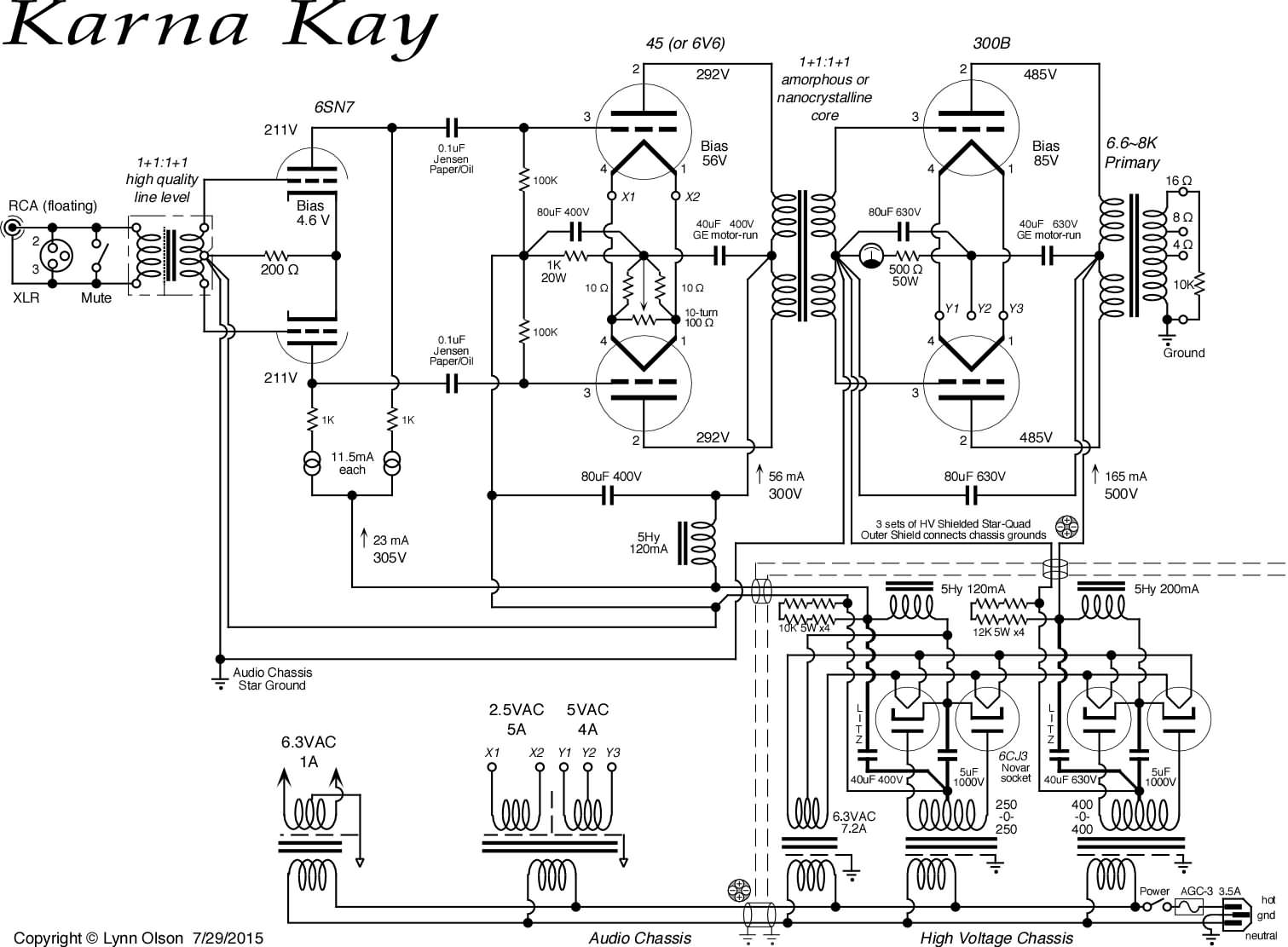

Here's the Karna Kay (posted previously) and the Symmetric Reichert amplifiers. As the name implies, it's basically a symmetric pair of Reichert SE 300B amplifiers, with the minor enhancement of split power supplies and a dynamic load for the driver section. For power-dissipation reasons, it's recommended that only one half of each 6SN7 is used for the driver, with the plate, grid, and cathode of the other half grounded. (Three 6SN7's and two 300B's per channel.)
Although the power supplies show the use of 6CJ3 damper diodes, the input+driver stage can use more common rectifiers like a 5U4 or 5AR4. Separate transformers for the 300B filaments are very strongly recommended, since rectification switch-noise from the HV secondary winding can capacitively couple into the low-voltage filament circuit and be audible as noise and "hash".
I no longer believe two-stage amplifiers are the way to go, so the Symmetric Reichert is a better choice for cost-sensitive builds. The simplest of all is the original SE Reichert, which is pretty much one-half of the shown circuit (minus the input phase splitter transformer). The voltages and currents are drawn from the measurements made by Thom Mackris on his recently completed split-supply Reichert SE 300B amplifier.
I'm pretty sure the Karna amplifier has higher ultimate performance, due to the more powerful (and linear) driver and the ability to enter and leave A2 operation without capacitor charge-discharge cycles.

Well, it all depends on the spectral characteristics. One of the unusual aspects of the 45 and 300B is extremely low high-order spectral content; it's almost entirely 2nd harmonic, about 20 to 30 dB lower 3rd harmonic, and 4th and higher vanishing into the noise around -120 dB. Unfortunately, the 2A3 isn't quite as good in terms of high-order harmonics.
As a group, the IDHT's are good, but nowhere close to what DHT's can do. The 6SN7, and the direct predecessors like the 6J5, 6P5, 6C5, etc. are in a special low-distortion group (looking at the upper harmonics). The performance of the 5687/7044/7119 family is better than the 12AU7 and 6DJ8, but that isn't saying much.
I don't know if the bigger variants of the 6SN7 like the 6BL7 and 6BX7 are as clean; I heard a few years back that they weren't, but my info could be wrong. It all depends on the spectral info ... how fast the harmonic structure falls away. Plenty of tubes have harmonics out to the 10th and 11th harmonic, and they tend to sound more colored and grungier than the crystalline sound of the DHT's.
What surprising about a well-done DHT amplifier ... and I include the Reichert here ... is they sound radically different than traditional Fifties-style tube amps. The old amps have a grungy, somewhat dirty sound compared to a modern, well-designed transistor amp, although the tone colors from tube amps are better, and sometimes a lot better.
By comparison, a well-designed DHT amplifier with a low-distortion driver section is more transparent than even a really superb transistor amp, which is quite surprising to people expecting to hear Marantz, McIntosh, or Dynaco levels of grunge. And the tone colors are the most vivid of any type of amplifier ... it makes system tweaking pretty much unnecessary, since you're already there. All the speakers have to do is deliver flat response, have a competent crossover, and be reasonably efficient.
But I did say "well-designed", which isn't true of most of the commercially available DHT amps seen and heard at hifi shows.
The trick with DHT amplifiers is having a driver stage that has less distortion than the final DHT tube ... and that means 60V rms (into a capacitive load) at very low distortion levels with very little high-order distortion content. Otherwise, nearly all the amplifier distortion is coming from the driver, which defeats the whole point of a DHT amplifier. If you're not hearing the DHT as it really is, you might as well buy an off-the-shelf transistor amp and save a lot of money.
So it all comes down to the performance of the driver and input tube. The 5687/7044/7119 input tube creates nearly all the distortion above 5th harmonic in both the Amity and Karna amplifiers, so it's going to get replaced with the spectrally cleanest tubes I can find. Although it's possible to build an all-DHT amplifier, chasing out microphonics is a major hassle, and I still have reservations about the performance of the input-to-driver interstage transformer. That's a part of the amplifier where additional capacitive loading is very undesirable; it limits slew rate, and increases HF high-order distortion because of the elliptical load-line presented to the anode of the tube.
All-transformer-coupling is conceptually elegant, but it comes down to the performance of the tubes driving those transformers ... how much capacitance do they see, how linear is that capacitance, how much hysteresis does the interstage have as it transits through the zero-current region, and does that hysteresis interact with the odd-harmonic distortion of the tube?

I have to admit an amplifier with three 300B's glowing on the top deck would look very cool. Plus, the spectra from the driver and output would match ... something to be said for that.
The DHT driver(s) certainly have a lushness that just isn't there for IDHT drivers ... it's like the DHT sound squared, and makes the hassles with the filament circuit worthwhile.
I very much appreciate your subjective results with high-level SE -> PP conversion. Class A PP amplifiers with very clean spectra sit right on the knife-edge of being a little too sharp, compared to their SE brothers. They are more transparent than nearly any transistor amp, and are unforgiving of poor-quality source components. Oddly enough, "bad" recordings are very listenable, since the crud floats above the music and doesn't contaminate it. The crud sounds like little discrete specks of noise instead of a roar of distortion.
Isolating the power supplies went a long, long way in getting rid of the usual PP sound. The ripples in current on the power supply of a Class A PP amplifier are very much like the output of a balanced AM modulator. By getting rid of cross-coupling from stage to stage, just about all of the hash goes away, and transparency goes way up.
Our adventurous friend Zigzagflux has posted not just photos, but detailed measurements of his version of the Karna Kay amplifier ... although he came up with the RC-coupled input section first! As you can see, performance is in a different class than most SET or PP-pentode-with-feedback amplifiers.
What I find remarkable is a zero-feedback amplifier outperforming a "Golden Age" tube amp with 20 dB of feedback. That says a lot about the inherent linearity of the input, driver, and output tubes. This is not a Williamson, Marantz, Dynaco, or Mullard architecture, and doesn't sound like them.
The Symmetric Reichert, though, is pretty close to the Acrosound circuit, just with better tubes and an improved power supply.
I see the speaker-amp is an integrated combination. Although both fit into industry-standard interfaces with respect to impedances and drive levels, they sound best together. Another advantage of (roughly) following standard interfaces is quick comparison with conventional home-theater and audiophile equipment. By flipping four DPDT switches on the crossover (which isolate the grounds of the two systems), I can quickly change from 5.1 channel HT to 2-channel audiophile listening, with completely separate chains of amplification and signal sources.
P.S. Thanks, Ludwig Haus, for your valuable comments! You've given me some good things to think about, particularly from the perspective of subjective balancing of the overall system. As we see from Zigzagflux's measurements, the driver tube now looks like the limiting factor in the overall amplification system.
OK, let's look at Ludwig Haus' proposal with a clean sheet of paper. The obvious choice for the input tube is half of a 6SN7 or all of a 6J5, 6P5, 6C5, or similar single triodes. (Some octal, some five-pin, why not just parallel the sockets?)
This is RC-coupled (with resistor-isolated current source) to a small DHT driver tube, most likely a 71A, 45, or one of the interesting European tubes. Presumably the operating current is between 25 and 30 mA, and the anode between 250 and 300V.
The SE -> PP interstage is going to be a special-purpose part, so let's go over what's needed. To match the HF phase of the twin secondaries, one of them will probably need a small amount of balancing capacitance, most likely a small value of silver-mica cap.
My experience with parallel-feed has not been positive, so let's ask for the core to accept 30 mA of polarizing current, so it's going to need to be air-gapped and somewhat larger than a PP interstage. It also has to handle another 20~25 mA of peak current in one direction without saturating.
The driver tube has to linearly drive the 80V bias of the 300B's, and will swing from 250V down to 120V (it will swing further in the other direction, but with decreasing current). The other aspect is the capacitance of the twin 300B's ... about 60~70 pF each. The additional capacitance of the transformer will probably be around 30 pF as seen from the anode of the driver.
If the ratio is 1:1+1, then the driver see too much capacitance, probably 150 pF or more. This is the downfall of PSE architectures ... the driver sees too much capacitance, the amplifier loses slew rate and HF distortion increases, and the amp sounds dull and congested at high frequencies.
If the ratio is 1:0.5+0.5, then the driver has to linearly swing peaks of 160V, which is similar to driving an 845 (which is nearly impossible).
So a ratio of 1:0.707+0.707 looks like a good compromise between required voltage swing and additional capacitance presented to the driver-tube anode. At the expense of a bit more capacitance, 1:0.8+0.8 asks a bit less voltage swing, and 1:0.625+0.625 is more favorable in the direction of less capacitance. I think we can see that 300V on the anode would be a good idea ... we're going to need that voltage swing if we'd like to prevent the entire amplifier clipping at once.
