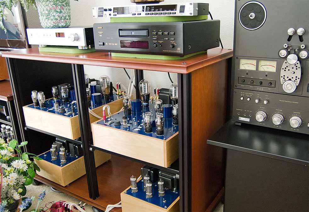

I found that I had to teach myself about electronics to get the speakers I designed to reveal their full potential. I really didn't want to do this, but I tried the Ariels with about 20 to 30 different amplifiers in the first year of owning them. A couple (the Audio Note Ongaku and Reichert Silver 300B) were so compelling that I wrote a review in the local magazine, Positive Feedback. Many were shockingly bad, like a transistor radio that had been left out in the sun too long. None of them sounded alike, not even amps of the same general design class.
And there's nothing special about the drive requirements of the Ariels. Impedance falls in the 4 to 10-ohm range, they're about 91~92 dB/meter/watt efficient, and they're basically a more efficient and scaled-up LS3/5a with better-quality drivers. They're not exotic at all, and easier to drive than most audiophile speakers.
But ... picking a good-sounding amplifier was very difficult. The Ongaku is insanely expensive, and simply copying it without using the exotic Audio Note parts results in atrocious sound. The Reichert Silver 300B was about 1/12th the price, and I nearly bought them ... but the review pair ended up getting sold to a customer in Germany.
Besides, I wanted an amplifier with the gorgeous Technicolor sound of the Reichert but a bit less coloration, and some of the Ongaku's remarkable silence-between-notes presence and insight into musical textures. No such amplifier was on the market, at any price.
So I jumped in the deep end of the pool and learned about amplifier design; fortunately, I had my Tektronix friends look over my shoulder and test the results with their lab gear. This is where the first amplifier, the Amity, came from, followed by the unsuccessful Aurora project, and then the Karna, which I use now. The Karna is due for a Mark II revision, and I'll be working with Gary Pimm on the project.
DACs are far beyond anything I can do. For the present, I have the Monarchy N24, which uses the Burr-Brown PCM1704 current-output chipset, passive-resistor I/V conversion, and a 6DJ8 amplifying stage in SRPP configuration. The signal path from the switched-resistor array in the PCM1704 ladder DAC to the loudspeaker terminals is all-vacuum-tube, with two caps between the PCM1704 and the tweeter terminals. For those who care, interconnects and speaker cables are industrial Litz wire with cotton sleeving.
It's a semi-custom system with only the source components from the high-end market. When I finally get a turntable working, that might end up being semi-custom as well, since Thom Mackris of Galibier Designs is a neighbor.
