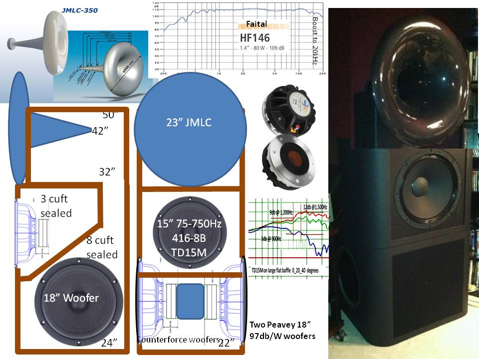

Horn + 15" driver? You betcha. A studio favorite going back to the Thirties. Lots of famous records were mastered on systems just like this ... the Lansing Iconic, Altec 604 Duplex, Altec A7 and A5, Tannoy 15" in studio cabs, the UREI Big Reds, the list goes on and on. This is pretty much the classic studio-monitor formula.
And horns have gotten better ... much, much better than the Golden Age of the Fifties. This is where modern computer modeling has really paid off big-time. There's Dr. Earl Geddes' Oblate Spheroid, Dr. Bjorn Kolbrek's thoroughly analyzed AH425's, various modern horns optimized for low-diffraction, etc. etc.
The only real choice from a horn perspective is the choice of small-format 1" exit compression drivers, which will need a crossover in the 1~1.5 kHz range, or a large-format 1.4" to 2" exit driver. Large-format drivers and horns can use a crossover from 500 Hz to 800 Hz, but are not really at their best above 10 kHz. (It's still a good rule-of-thumb to not use horns over more than 3 octaves, but there are exceptions.)
I chose a large-format compression driver because I really like how they sound in the 800 Hz to 2 kHz region ... but that also meant accepting a matching supertweeter. I like Beryllium and traditional aluminum alloy diaphragms ... and don't like titanium (which is what is used in modern movie theaters).
Plenty of people really like small-format compression drivers; you just have to use a somewhat higher crossover. No supertweeter is needed, and modern plastic diaphragms are much sweeter-sounding than the titanium diaphragms that are widely used in portable PA systems.
The only real alternative to a horn is an modern AMT driver like the TPL-150; these are efficient, with studio-monitor headroom (to match the bass driver), and have pretty flat response. (Plastic diaphragm with aluminized conductive coating.)
Ribbons and true electrostats are not a good match for a studio-monitor 15" driver; they work a lot better with audiophile-style 6" to 8" midbass drivers, and associated 87 dB/meter/watt efficiencies. A system like this has 10 to 15 dB less headroom than a traditional large-format studio monitor.

Low A on a Piano is 27.5Hz. Deep bass is required, but there is a significant difference between Boom-Boom heavy cone subwoofer bass, and room-equalized high-efficiency big-cone-woofer bass.
==== Sd vs. cone diameter===
18" 1220 cm2
15" 855 cm2
12" 530 cm2
10" 345 cm2
8" 225 cm2
The large cone area of an 18" woofer provides high efficiency bass with modest distortion generating displacement. Side-to-Side physically connected woofer pairs use counter-forces to dramatically reduce vibrations. Two 18" woofers can provide high quality room-equalized bass from a sealed box alignment with modest watts. Two 18" woofers like (Faital 18FH500, Peavey LoRider18, Beyma 18LX60 rev1) which have modest Mms (140-180g) and Qts~ 0.37 connected in parallel in a sealed 9cuft volume can provide Qtc=0.7 alignment with F3=60Hz before equaliztion extends the bass to the 20-30Hz range using 10watts for over 100db room SPL. Smaller sealed volumes require greater power for room-equalized low frequency bass.
Sealed box volume vs. amplifier boost power using a Linkwitz Transform of 20Hz for a pair of Faital 18FH500
Two Faital 18FH500 woofers producing 100db SPL with -3db at 20Hz Linkwitz Transform
Box Volume = 9cuft____Qtc=0.70___Power for 98db SPL @30Hz = 10.4watts
Box Volume = 8cuft____Qtc=0.73___Power for 98db SPL @30Hz = 12.5watts
Box Volume = 7cuft____Qtc=0.76___Power for 98db SPL @30Hz = 15.5watts
Box Volume = 6cuft____Qtc=0.80___Power for 98db SPL @30Hz = 20.2watts
18" 1220 cm2
15" 855 cm2
12" 530 cm2
10" 345 cm2
8" 225 cm2
