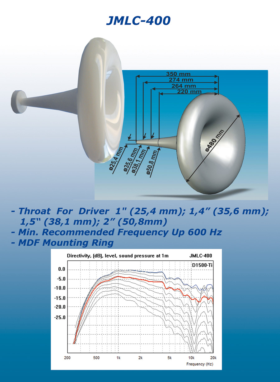

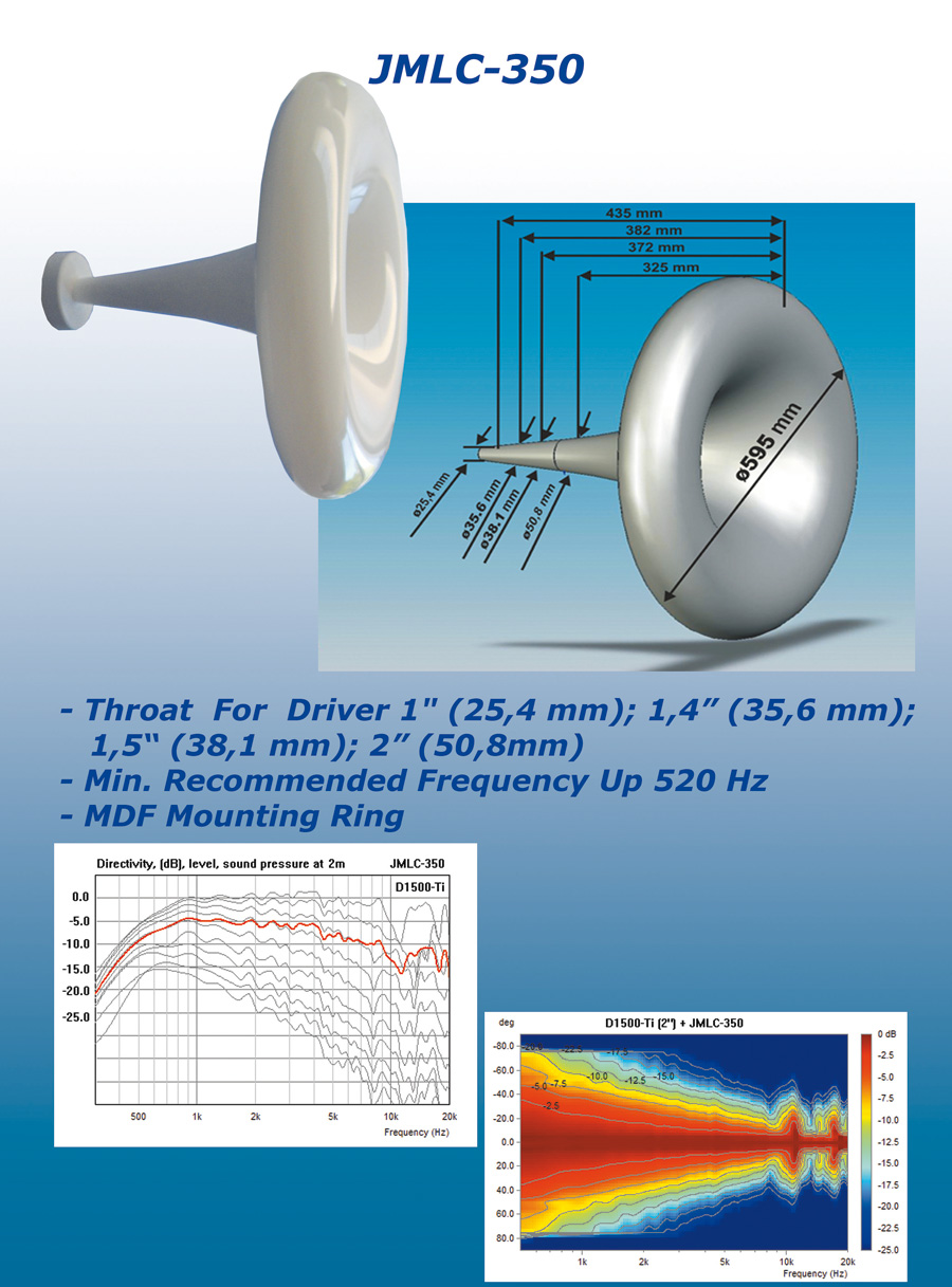

This thread is based upon the LeCleach profile, but there are many debates on size, build material, rear dampening, adding absorption material inside the horn, crossover slopes and time alignment options, etc.

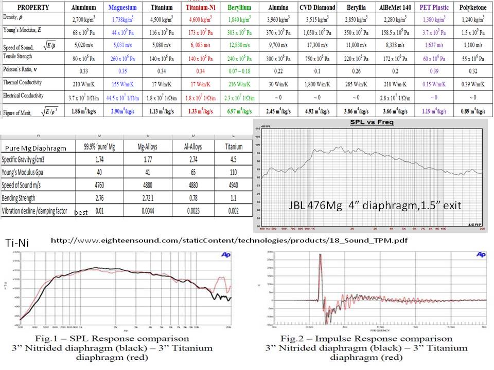

Your choice of compression driver will determine tone signatures, plus if you need a super tweeter, as well as the optimum Xover frequency and slope.
