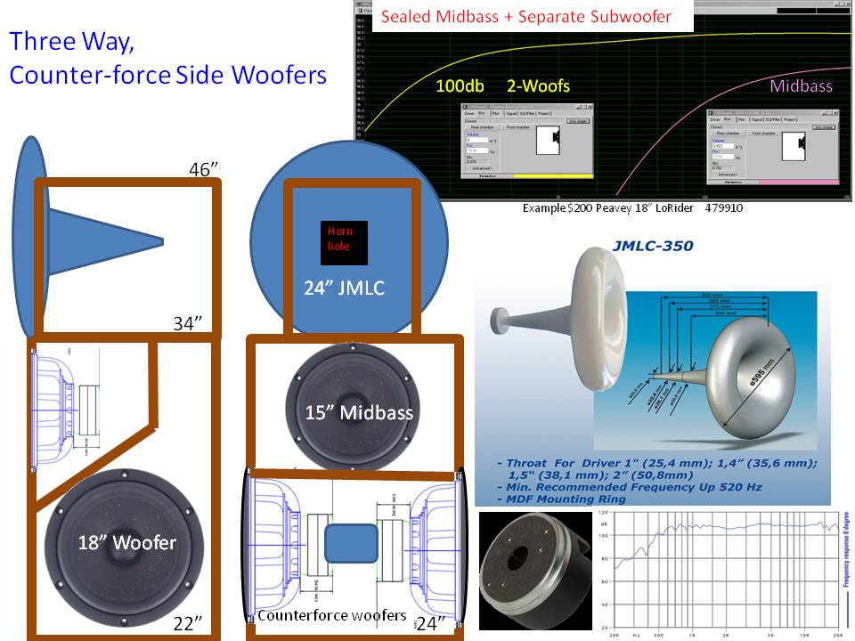

I should also mention that I'm considering a version using Altec/GPA 515's and 416's in parallel. LEAP simulations (using Gary's T/S measurements) indicate that with a 3.3 cubic foot/50 liter closed box (for each driver), the combination sums to flat, with an F6 around 50 Hz, and efficiency in the passband around 100~102 dB.
The LEAP simulations show the two drivers with complementary responses: the 515 is tilted towards the midrange, while the 416 is tilted towards the bass. In effect, there's a fractional (about 2 dB/octave) acoustical crossover between the two.
Performance isn't as high as a straight (non-folded) bass horn, but it's not as physically large either. At first glance, the 515/416 direct-radiator combo seems midway in performance between a single 15" direct radiator and a bass horn.
Woof! Woof!

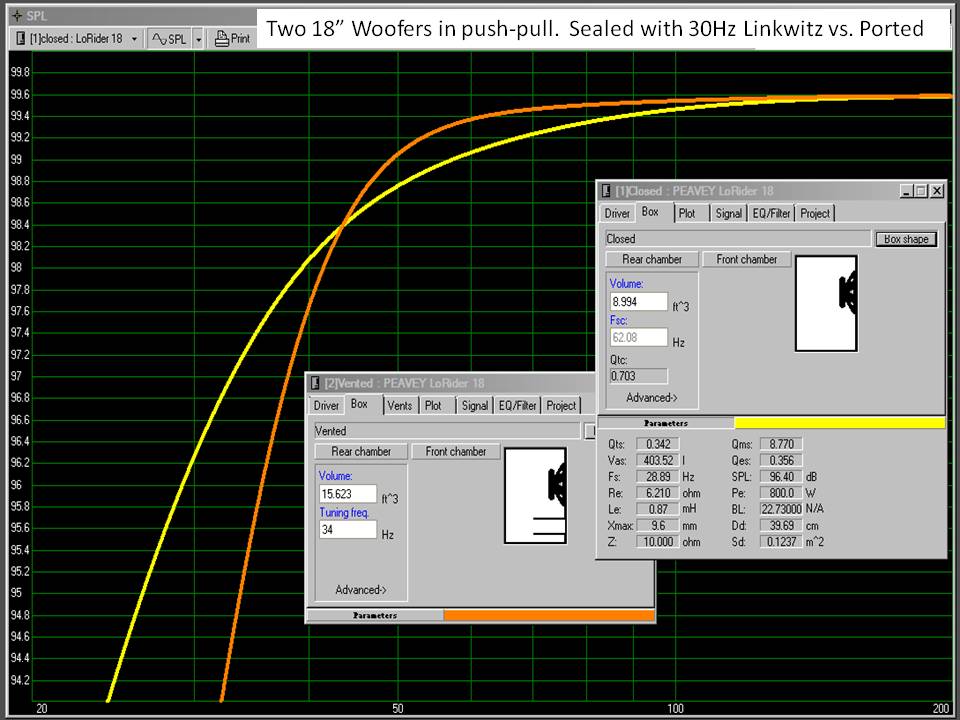

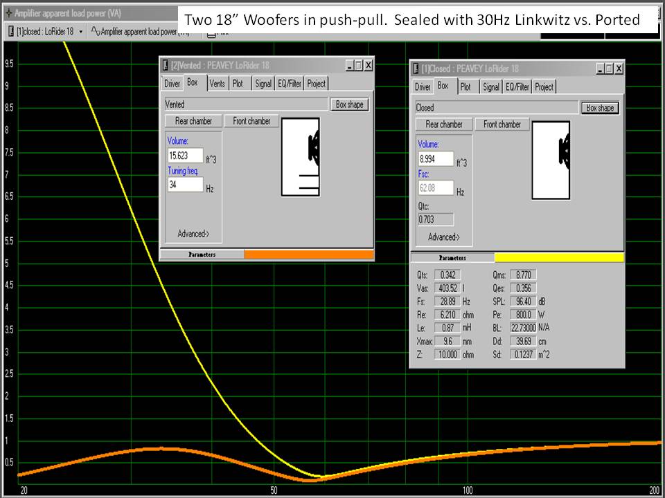

I had WinISD graphs of two Peavey 18" woofers which could be counter-force boxed for 102db/watt efficiency.
1) Ported in 15.6 cuft with F3 = 34Hz
2) Sealed in 9 cuft with 30Hz Linkwitz transform. A plot of amplifier boost power is included. At 30Hz the Linkwitz transform 6x amp power gives sealed Qtc and saves 6.6 cuft of box volume.
