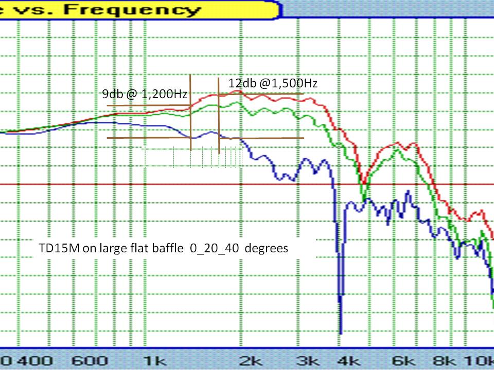

I reading Gary's posts regards the AE 15M and the GPA 416 and comments on AVR forum regards the AE15M I am wondering if the notion of power response in terms of the "system" tilt is effecting the way the AE15M sounds.
A ruler flat response on axis is not always a good listen.
On the AVR and diy sound groups they have been messing with SEOS wave guides and initially got mixed feelings about the AE15M until measurement averaging of direct and power response suggested optimising for a non flat but slightly tapered response above 300 hertz extending slightly down across the bandwidth of the system.
This bought back the subjective impression of tonal density.
The notion being that with the AE15M very low 2nd and 3r THD, while being articulate it was sounding thin and lacked tonal color compared to otherwise similar drivers in the bass and mid band which subjectively had more warmth (much like single ended amps).
Given the AE15M has better power response above 800 hertz then most 15 inch woofers I think this could be a contributing factor.
None of this is particularly easy to measure but I plan to build a turntable and do some measurements soon in an open space with LMS, Leap5 and Sound Easy and see what I come up with. I have a AE15M and plan to use an Azura 425 with my Tad 4003 and the Tad UHF.

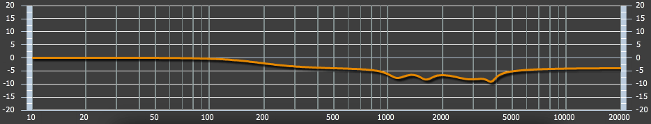

Do you have a link to that handy? That really sounds like a misinterpretation from the way you describe it, I think. Because...
- you need a bit of a slant down at some point relative to the baffle size, depending on placement, and that's always tricky to get right.
- As long as you measure from a healthy distance, the on-axis response does start rising at a lower frequency than you often see DIY indoor measurements reaching, so you've got "baffle step", modal range, and the natural rising response all getting into the mix around the same low frequency range. A real conundrum for indoor measurements.
- resonant behavior comes in around 900Hz, so when crossing higher you need to pull down 2-3dB more above that, if not using DSP to address it more precisely.
I attached an early version of my TD15M filter below. It eventually got more complex, but the basic shape is still like this (it's the only image I had handy).
