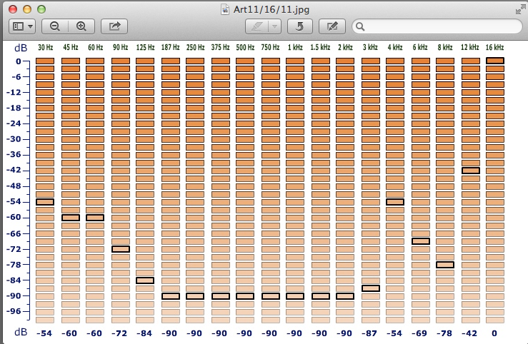

I have been checking my hearing for years using this:
Free hearing test on line – Equal loudness contours and audiometry
I have used Sony 7506 and GK Ultraphones (same transducers in Peltor muffs) for testing.
With the 29 dB noise reduction of the GK Ultraphones houshold noise is reduced to the point where I can detect the tone in the LF with far less gain, but as is easy to see I suffer from classic NIHL (noise induced hearing loss) and Presbycusis (old age HF hearing loss).
The measurements of the headphones were done with a BK 4007 in a flat baffle held to the phone transducer, without any pinna equivalent, so are not exactly representative of their actual frequency response, but show response extending past 20 kHz.
As you can see from my test results, my hearing "tops out" above 16 kHz
As I recall using a tone generator 15,750 Hz does not need as near as much gain to hear, but past 16 kHz I would need damaging levels to hear any tone.
Bonnie's hearing shows only a 3 dB decrease in sensitivity at 16 kHz, and sine wave tone tests indicated she had response to 20 kHz with little boost required, though above that response dropped rapidly, though the headphone response also dropped rapidly.
At any rate, my hearing is no where near as good as Simon, a few dB difference above 8 kHz would no longer concern me (though 40 years ago I could easily detect those kinds of detail) but loosing the 1/3 octave from 12500 to 16000 is still quite apparent to me.
Looking at my father's sonograms, it is probably only a matter of years when it will drop down another 1/3 octave, and I'll join you in the "10 kHz and above doesn't matter" club.
Until then, I'm still in the "flat to 16 kHz" club (Bonnie does not care about the 16 kHz to 20 kHz range, even though she can hear it clearly).
