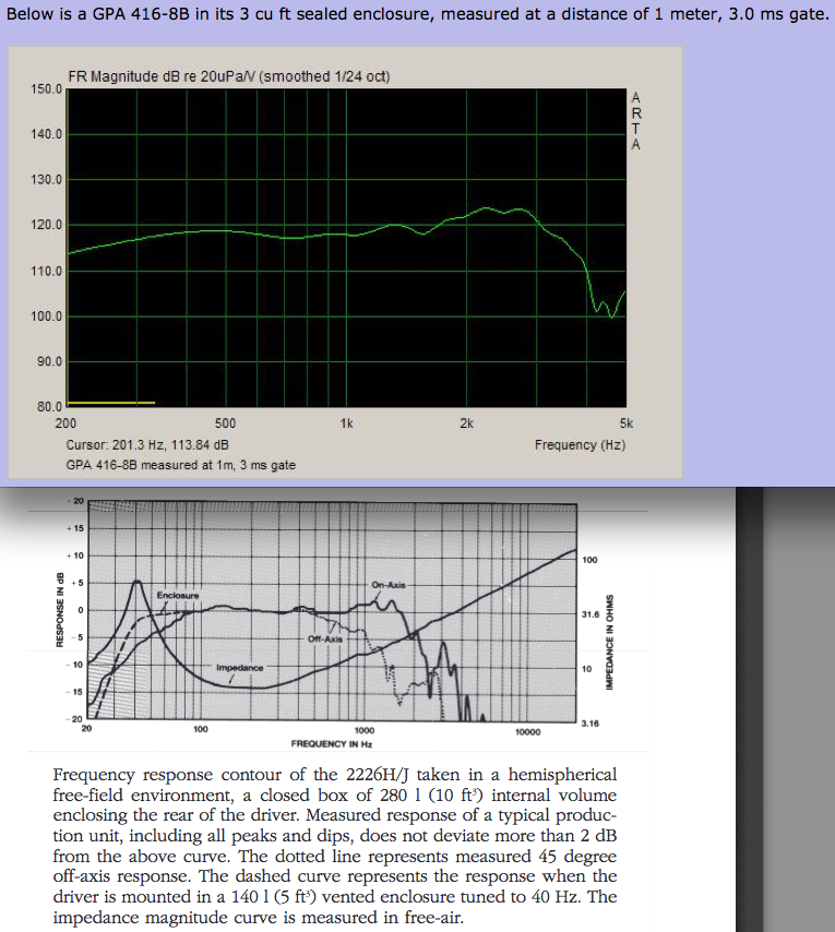

Below is a GPA 416-8B in its 3 cu ft sealed enclosure, measured at a distance of 1 meter, 3.0 ms gate.

Interesting that the 6 (or 7) dB upper peak in the 15" GPA 416-8B is almost an octave higher than the 12" GPA 414-8B.
The frequency response variation between the 416 and the JBL 2226 are rather large in the octaves above the crossover point, around 15 dB at 2500 Hz.
Without a radically different crossover for each, the two speakers certainly would sound quite different, I wonder if Lynn used different crossovers for each when he found his preference for the GPA.

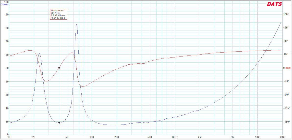

You can do good DCR measurements with the Woofer Tester II, or the WT3. They will show the impedance curve and also tell you the DCR. You can check this against a known resistor. More repeatable than most ohm meters.
Goran (gornir) did a nice little comparison on the two testers here:
www.audioexcite.com 2013 October
..and the newer DATS is likely similar to the older WT3, though with more features.
