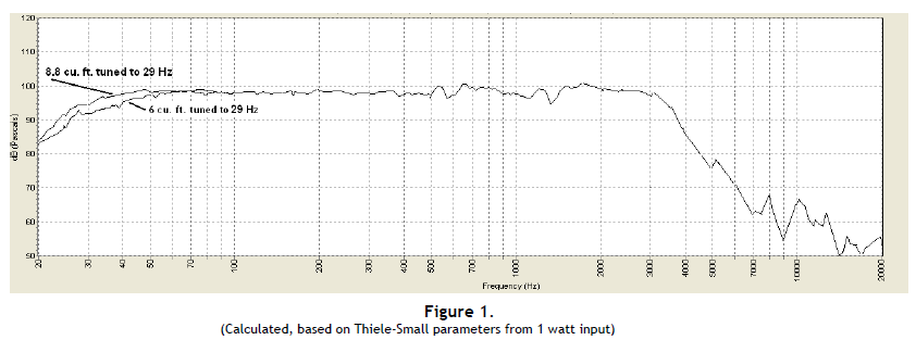

I cannot trust the the response curves published by GPA for the 414/416/604, looks like copy/paste in mid band :
http://www.greatplainsaudio.com/downloads/414-8B Spec Sheet.pdf
http://www.greatplainsaudio.com/downloads/416-8B Spec Sheet.pdf
http://www.greatplainsaudio.com/downloads/604E Series II Spec Sheet.pdf
I can understand some form of copy/paste for a given speaker measurement (close range pressure measurement for the lows, and gated 1 or 2m measurement for the mids and highs), but these look too identical among the 3 drivers...

The "calculated" simulations GPA uses may be close, but actual measurements (lacking on the GPA site) would be more telling.I cannot trust the the response curves published by GPA for the 414/416/604, looks like copy/paste in mid band...these look too identical among the 3 drivers...

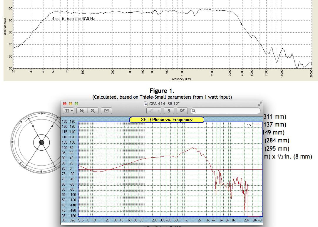

Indeed, I did miss the legend.The "calculated" simulations GPA uses may be close, but actual measurements (lacking on the GPA site) would be more telling.
How can they simulate such midband aberrations using T/S parameters?
He can't that's why his simulations and reality differ so greatly.

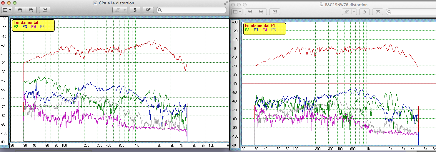

Thanks for the link. This must be the first GPA measurement plot I've seen.
It seems to be a little 'rich' in nonlinear distortion. What worries me is the dominant odd order distortion in 200Hz - 1kHz range.

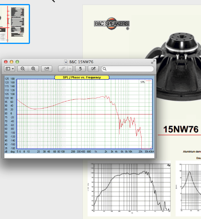

Yes, it is interesting to see how close Wippersnapper's measurements for upper response (his test protocol is not accurate below around 200 Hz) for the B&C NW15NW76 matches B&C's measurements, while GPA's 414-8B 12" simulation does not include the 7 dB (or so) peak around 1600 Hz.He can't that's why his simulations and reality differ so greatly.

With distortion at -40 dB, around 1% at 19 volts (around 45 watts) the GPA 414 distortion does not make me worry.Thanks for the link. This must be the first GPA measurement plot I've seen.
The B&C 15NW76 distortion at -50 dB is about .3%, but the upper F3 and F5 distortion looks similar in content.

The problem was - I had measured.
