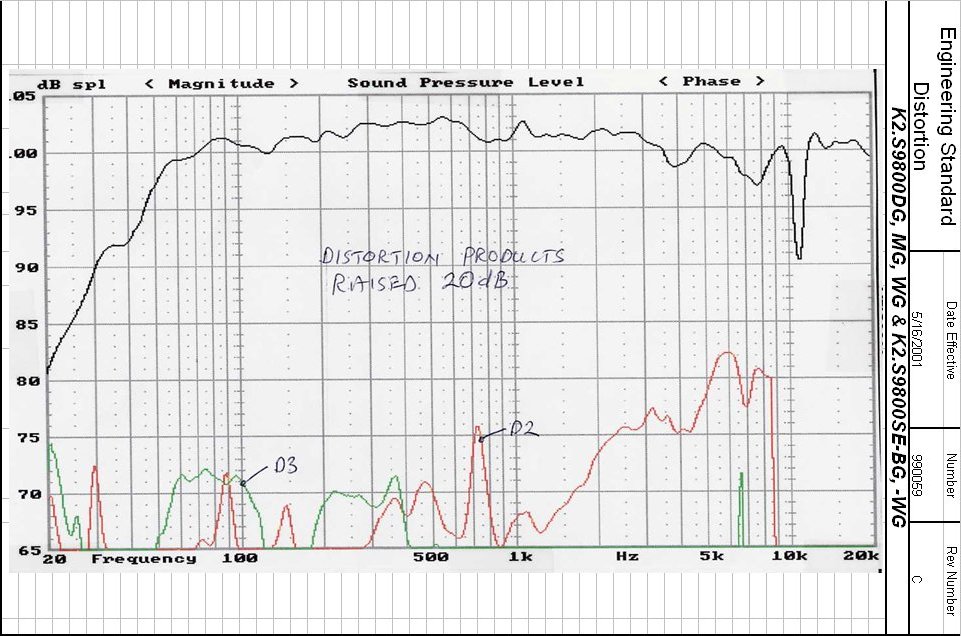

Well no because the horn and system voltage drives can influence the measurement so if you want to see a measurement on a horn look at the complete system plots. An example is the 9800 system plot that gives you the 435Be on the 9800 Bi-radial horn. Crossovers at 800Hz and 10K to the 045Be driver. Or better yet make your own measurements using the horns and drivers you want to use.
The distortion levels are up 20db in the plots.

Do you mean finished speakers, or drivers? I seem to remember distortion graphs for drivers.
Finished speaker. Driver distortion spec is less important as it is predictable and easily audible. Driver distortion should be part of the driver spec for designers to use the driver (to buy or to decide an acceptable Fc).
Tweeter distortion is more important than woofer/midrange distortion, because for woofers, "after-crossover" distortion is the weak point. With tweeters, the distortion remain more or less as is, whatever trick is done in the crossover.
And of course, high frequency distortion is more critical to the ears.
I believe in the future speaker distortion will have a standard to judge how well speakers have been designed. That's the only logical consequence of what I know about speaker quality.

The point of measuring this way is to see how the compression drivers looks by itself. Once you add a horn the voltage drives can effect the distortion measurement by driving up the percentages in the higher octaves due to the frequency response tailoring, attenuation curve, in the network. This does not include and distortion contributed by the horn.
How are you going to be able to measure distortion added by the horn if you don't know what the driver numbers are? How are you going to measure driver improvements without a baseline?
