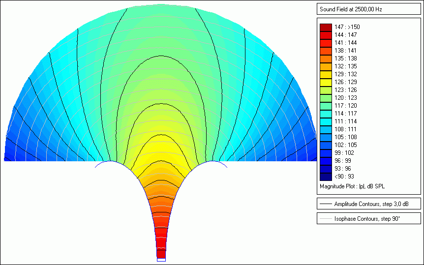

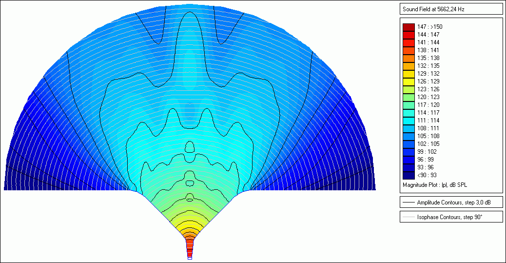

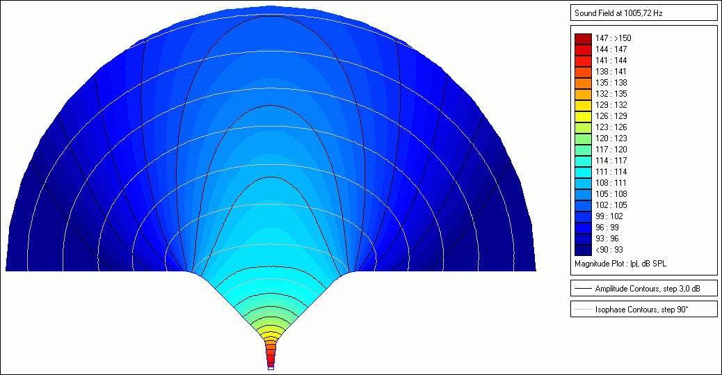

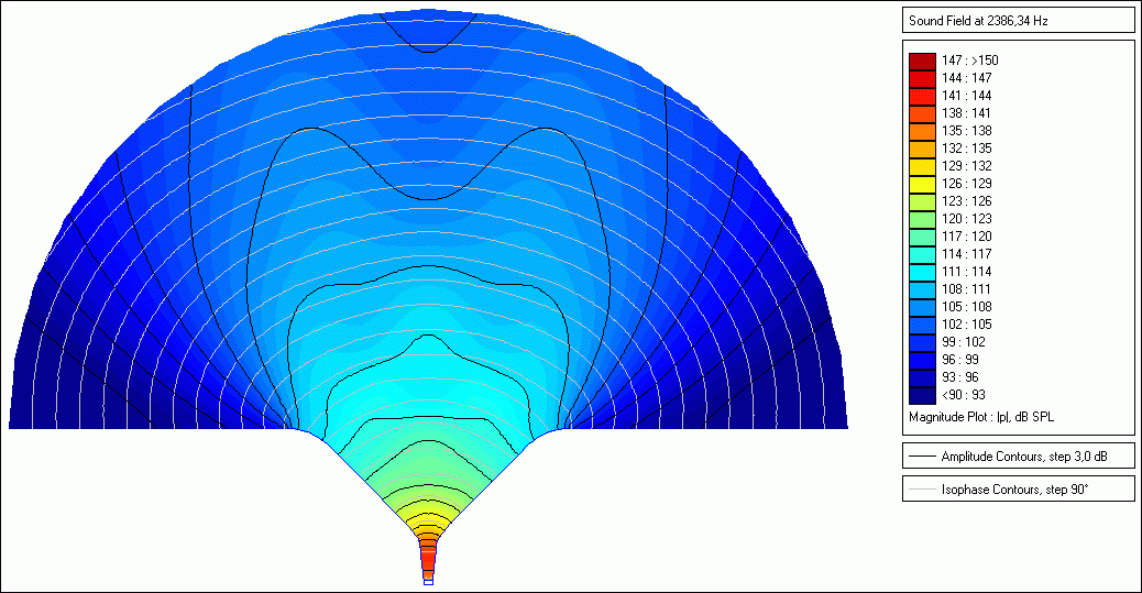

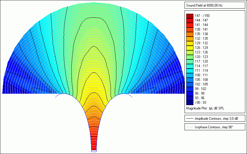

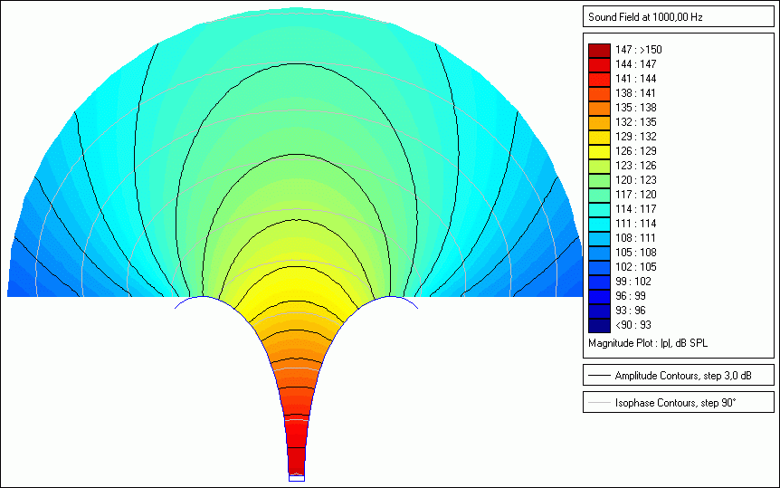

Comparison of AH425 and CD waveguide at 1 kHz.

Comment of the BEM simulations: there's no simulation of a diaphragm or phase plug assembly, with a flat plane wave entering the horn. In other words, both diaphragms and phase plugs are assumed to be perfect. In the real world, phase plugs depart from ideal at high frequencies, further disrupting the wavefront entering the horn.

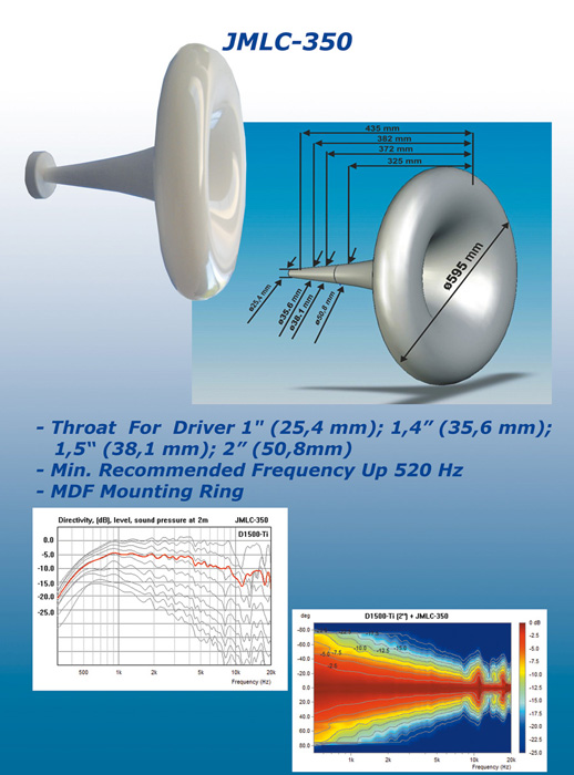

Here's a comparison of JMLC350 v SEOS-18. SEOS-18 has a higher cut off, so not directly comparable, but you get the idea. Below 1 kHz, they are essentially the same.

I think I have around 35 or so different mid/treble horns here (AH425 nope) the main reason being they work different with different drivers, different rooms, listening positions, crossovers, rossover points, bass systems, treble systems and mood among other things. Surely Lyn Olson's horn may sound great to him. I wonder though how many tractrix or 90 degree horns you've actually lived with? How many horn sysyems have you actually completed?
My point is integration will be the key to get them to really spook you into believing the sound in your room is real. Based on having similar horns to yours I can't see that happening 100 % without mating it with a long directional hypex or expo bass horn, probably with an 8 or 10 inch driver. With a good 90 degree CD style horn you can get away with a shorter horn with a 15, or possibly even a dreaded reflex box. I know many people that tried to integrate a directional horn like yours with short altec horn reflex and went back to radial because it never sounded ad good overall, As far as the ribbon sitting there with it's wide dispersion several inches away from the compression driver - some people actually like that, that's why JBL sold so many 2405's.
