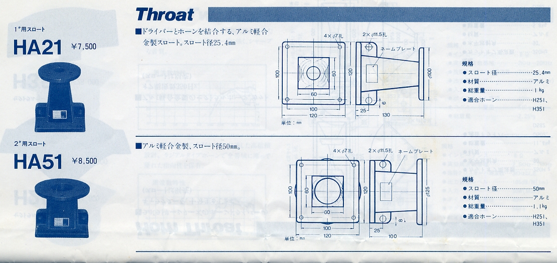

From what I know, 'traditional' 2" throat drivers such as the JBL 375/2440 have an internal flare rate corresponding to a cut-off frequency Fc = 160 Hz (this was inherited from the old WE drivers that had originally been designed to drive very large 'full range' theatre horns).
Incidentally, back-calculating the flare rate of the old Fostex HA51 throat adapter for 2" drivers, and assuming an exponential expansion law, it too comes out as being exactly 160Hz (probably designed so as not to create a discontinuity with the internal flare of the drivers it was designed to be used with).
